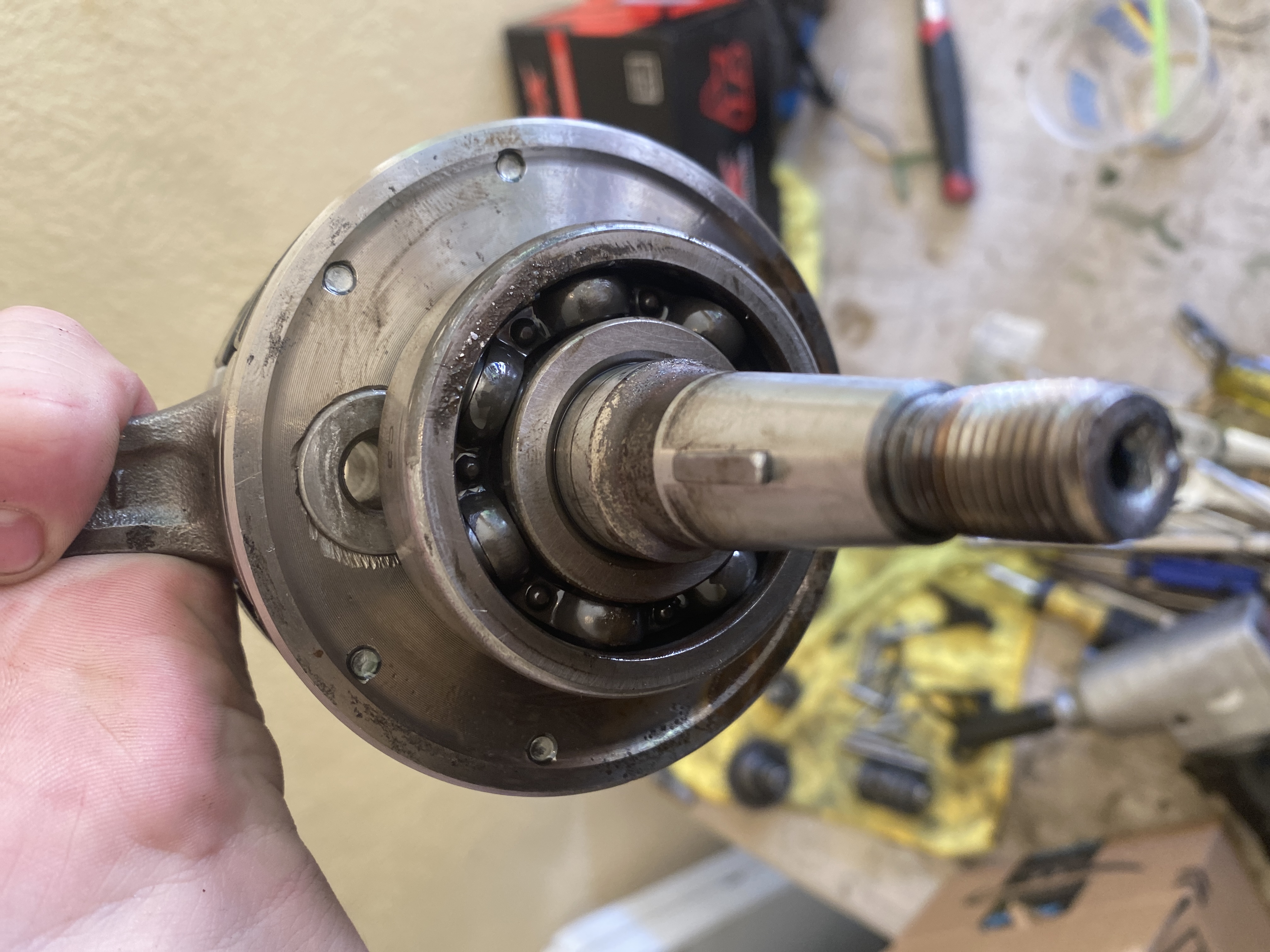

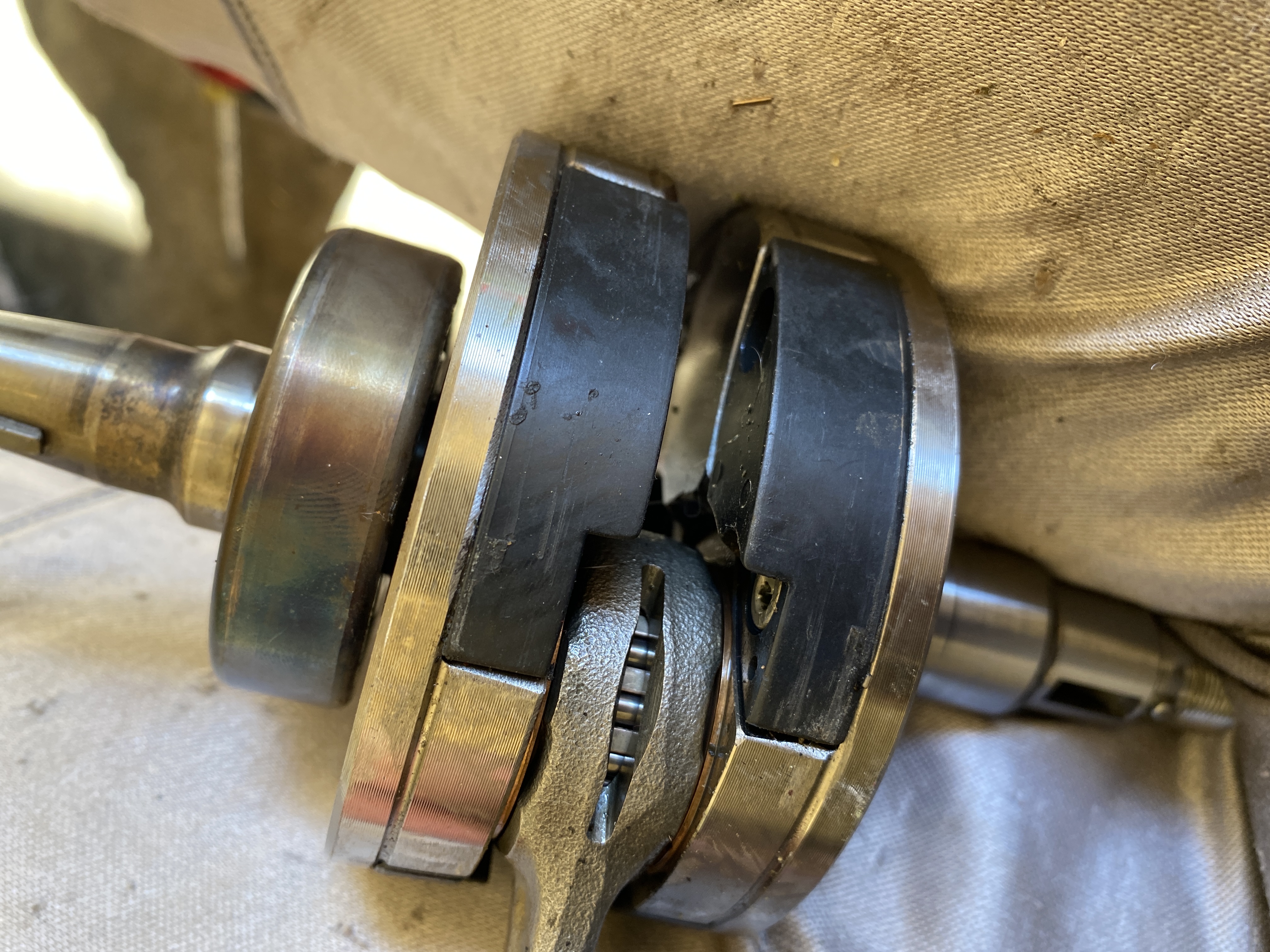

What’s a good way to get this off came off with it when splitting the case

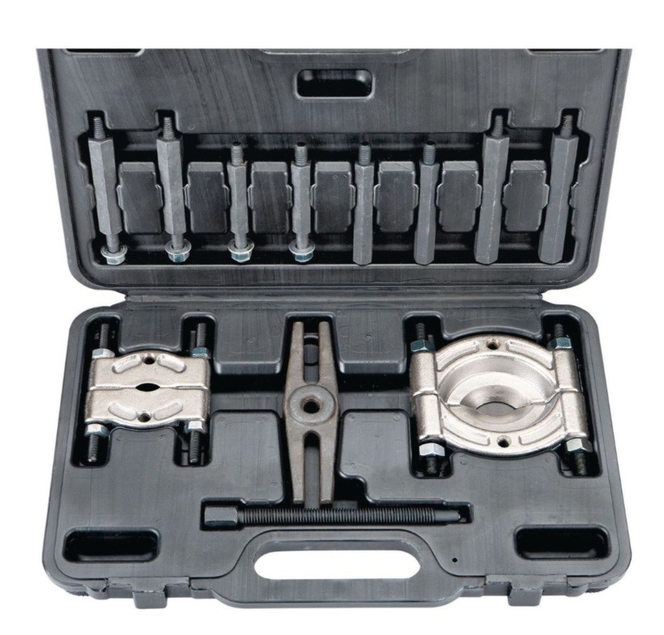

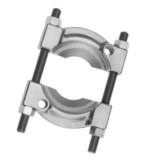

are you describing this (2 photos)? Some people call this a bearing splitter.

Can you feel or detect any vertical play in the big end rod bearing? Side to side play is normal but should be measured anyway with a feeler guage.

Yes side to side play no up and down and it should be fine

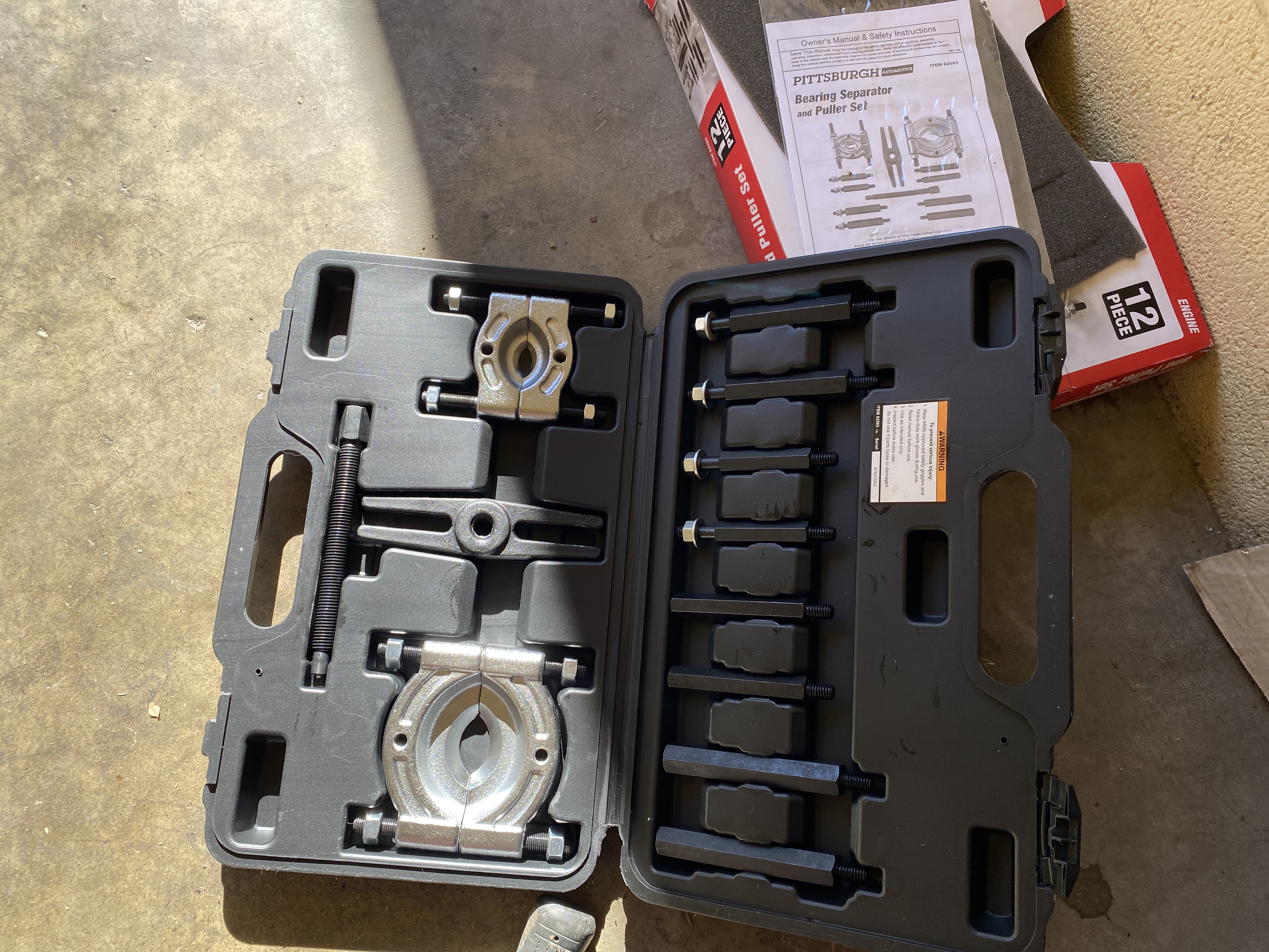

So I bought this tool it didn’t work any other way to go about this
Re: Remove bearings
That is the correct type of tool, but that looks like the harbor freight special that is not large enough. I have the Tusk Tool which works great but isn't cheap. You may be able to make yours work by using longer bolts to connect the 2 halves together. Also be liberal with the heat on the bearing.
You can watch video HERE

Joeymf, sorry to see you are struggling with this. Check that video that bufftester linked above. Like bufftester says, you may be able to make yours work by using longer bolts on the bearing contact plates and/or increasing the standoff lengths. Without a photo from your setup, I can't tell for sure. Additional notes: 1) the Tusk bearing puller costs about $65, and 2) Yes, there is another way. You'd take the crank to a machine shop.
