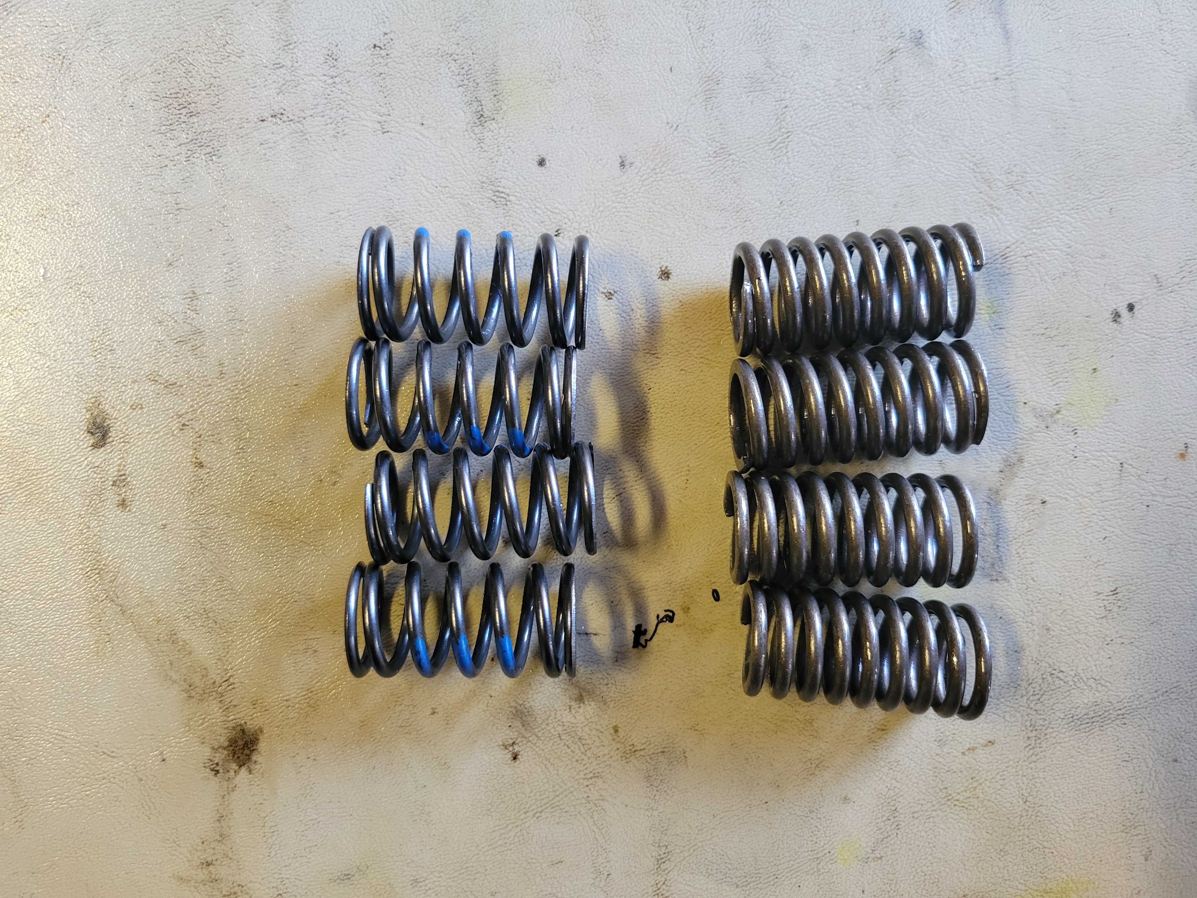

The springs was 100% the issue for me. Put some oem in and its working as it should. Lever pull feels like a normal lever pull should be. Adding a photo of the oem springs (top) and what was in the bike (bottom) for reference for anyone in the future that run into what I did.

I'd be curious of what those springs are for / who made them. I put some EBC springs in my 92 KDX and although they work, they make the clutch pull quite hard. I've dealt with it for about a year now, but I think I will go back to OEM as I'm tired of such a difficult pull. My old springs were out of spec, so I got new ones, as I was going through my entire clutch. I'd be tempted to make my actuator arm longer but I don't think I currently possess the skills to do so.
Thanks for the update!

I saw somewhere that the manual had incorrect specs on the springs. The ones I put in today were used that I found locally. I actually ordered new oem ones from rocky mountain. Should be in tomorrow or Wednesday. I'll put a caliper on it and let you know what they are. The used one I have now was showing 36.5mm. The book was calling for 38.7mm and serviceable limit was 37.2.

MeanGreen02 wrote: 08:23 pm Jun 15 2026 I saw somewhere that the manual had incorrect specs on the springs. The ones I put in today were used that I found locally. I actually ordered new oem ones from rocky mountain. Should be in tomorrow or Wednesday. I'll put a caliper on it and let you know what they are. The used one I have now was showing 36.5mm. The book was calling for 38.7mm and serviceable limit was 37.2.
I happened to note that as well when I was changing the springs on my 92. My new ones measured out of specification (EBC) but I chalked it up to them being heavier than OEM. My old ones were also out of specification, but they were not causing the clutch to slip.
I don't have specific numbers on hand, all I remember is both my new and old springs measured out of the spec that was in the manual.

Wow, wonder where those springs came from? I'm happy the solution has been found and now you can ride!
