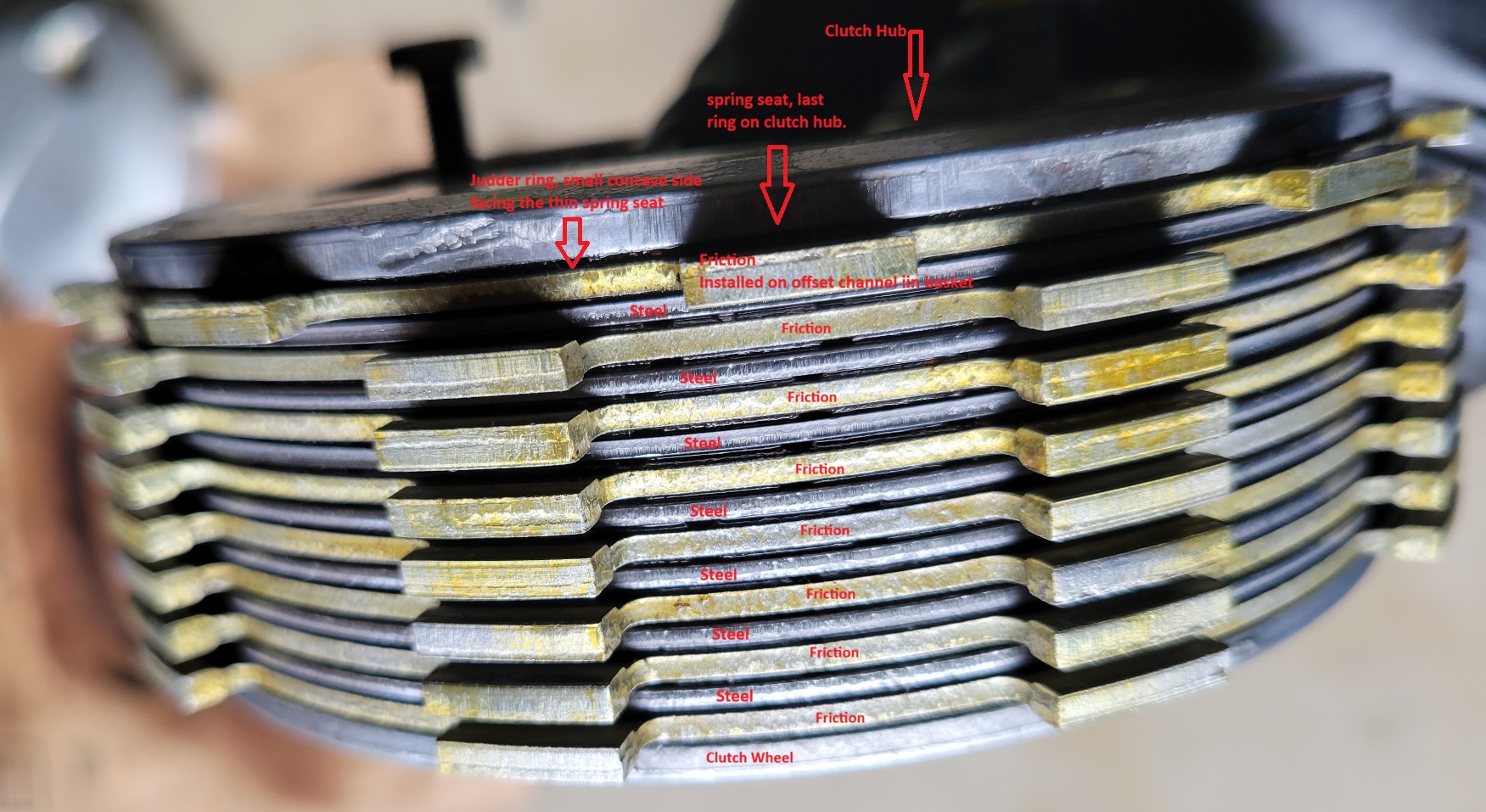

Something in your stack is wrong. Can you post a pic on the exact order you have it in? Here is how to post a pic: viewtopic.php?t=24128

ss109 wrote: 03:02 pm Jun 11 2026 Something in your stack is wrong. Can you post a pic on the exact order you have it in? Here is how to post a pic: viewtopic.php?t=24128
Here's a picture of the clutch stack.

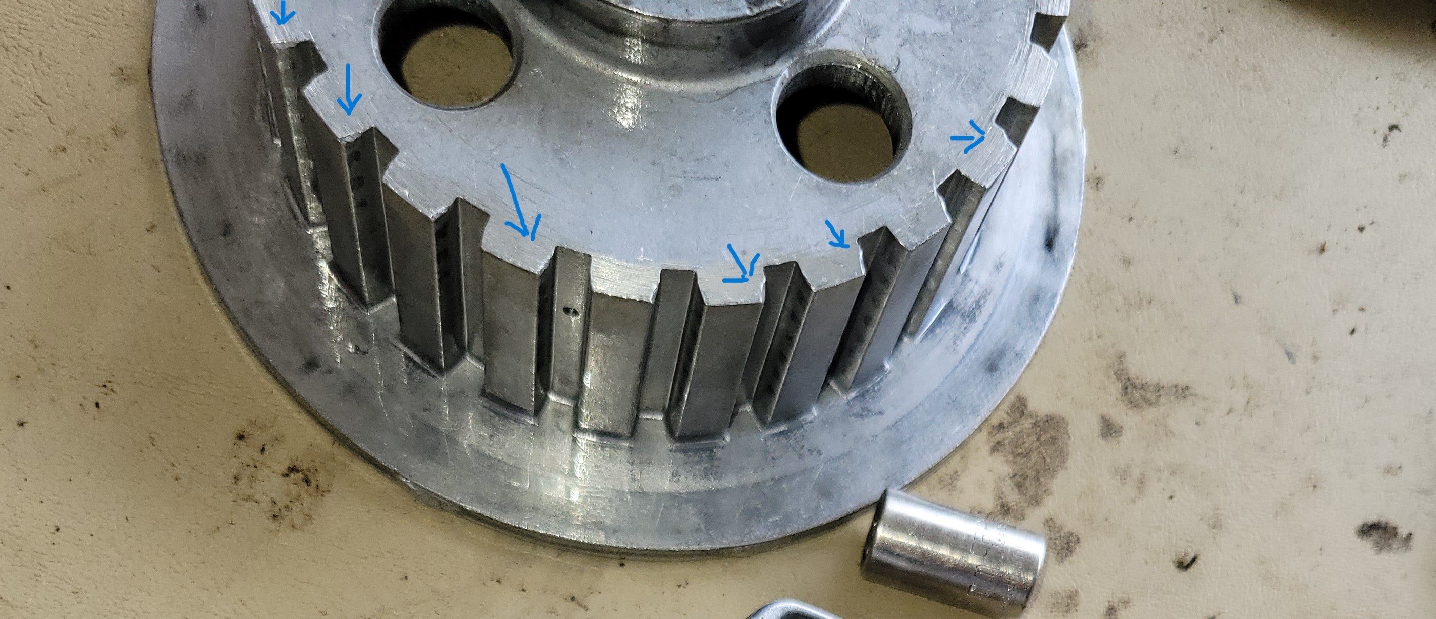

I also noticed some burrs on the edges of the clutch pack that mesh together with the clutch wheel. I had the clutch pack in the basket and took the 4 spring bolts out and tested pushing and pulling on the clutch wheel by holding on to those 4 towers and it was sliding in and out but not freely. Could those burrs causing it to be stuck when under tension when the springs/bolts are installed?

MeanGreen02 wrote: 08:25 am Jun 12 2026 I also noticed some burrs on the edges of the clutch pack that mesh together with the clutch wheel. I had the clutch pack in the basket and took the 4 spring bolts out and tested pushing and pulling on the clutch wheel by holding on to those 4 towers and it was sliding in and out but not freely. Could those burrs causing it to be stuck when under tension when the springs/bolts are installed?
Anything is possible. I would take a small file to those burrs and dress them. Then check it again for movement. By any chance, did you check your spring length and, if so, what is it?
I should have used a caliper but a quick check with the tape measure was pretty close to 1.5in. My stack is in the right order right?
