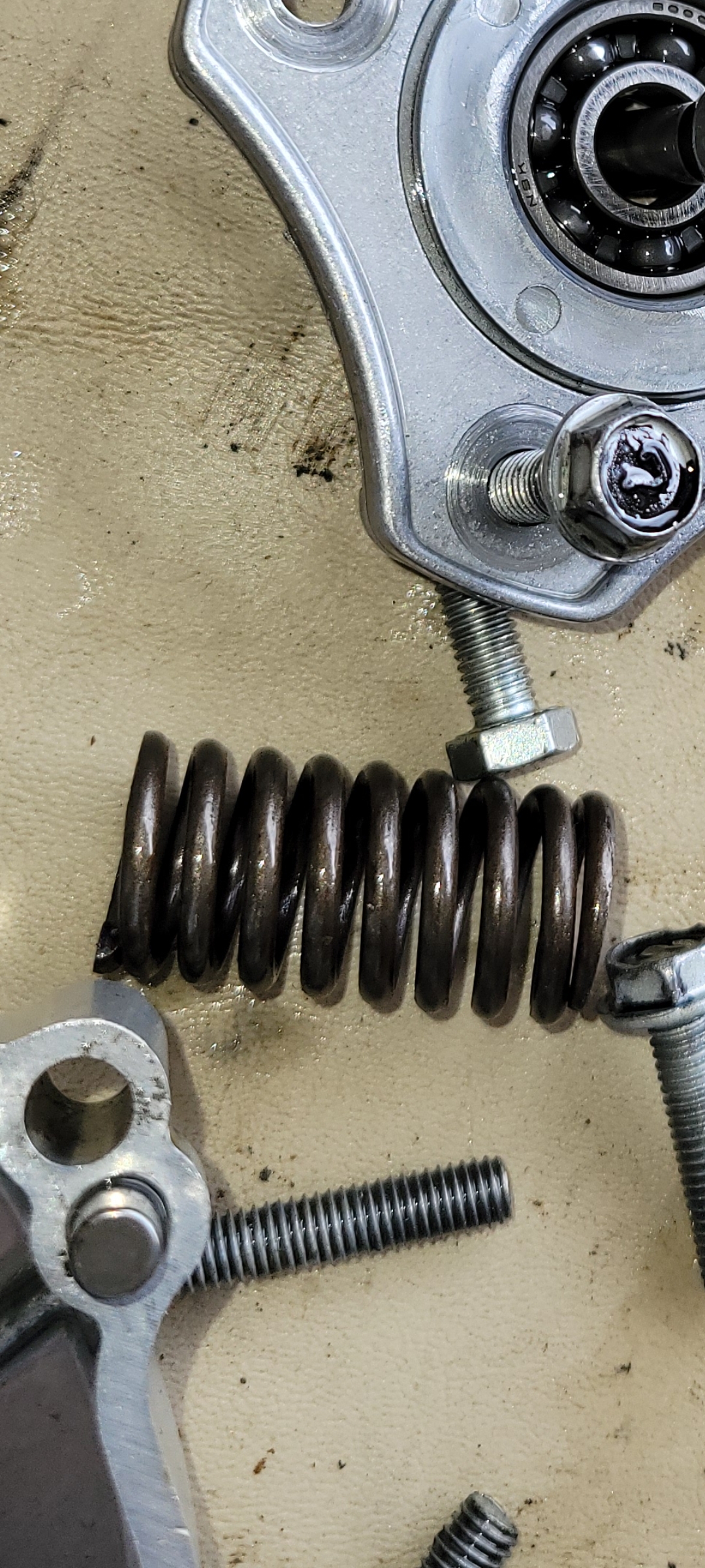

Looked at the photo of the springs. Doesnt look oem as it has more coils. Saw somewhere oem has around 6-7 coils, EBC has around 9. So maybe some new springs will help.
If those are EBC springs I think there is a problem with them with too many coils or too thick of wire causing coil bind, do you have a original set of springs?
