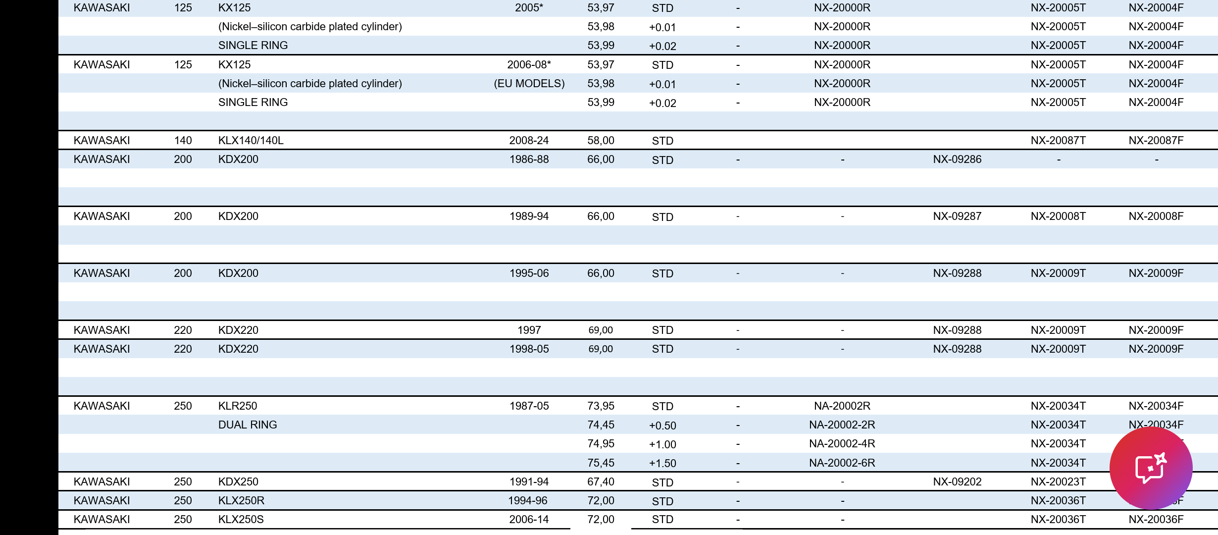

@kdxdazz I believe a member here had previously mentioned they very much wanted a cast piston, but if I recall, it was for a 200 application and I believe it was in a KDX/KX hybrid build. The guy who documented his use of this Namura piston stated that they were made in Japan. They went with a Namura piston, which I had not heard of in regards to being available for our bikes. I believe it is a hypereutectic type piston, based on quickly browsing their piston page on the Namura website.
I just looked up their catalog to find they show a 220 piston, but then after my excitement settled, I realized there was no part number for such a piston in the blanks next to the piston size listing in their catalog... While a quick Google search shows people questioning their quality, it has to be better than the OEM version manufactured by ART Pistons.... I'm wondering if they stopped making them and this person just got an old stock version, or perhaps it was a Chinese fake using this name brand?
Here's the catalog
I'll have to do some more digging, I'm on lunch break now and have to get back to work.
https://www.namura.com/products/pistons/
Their catalog also lists oil seal kits, top end gasket kits, top end bearing of course, and I believe connecting rods as well part number I believe is cut off in that screenshot, it's a few more columns to the right), the part numbers further to the right.

I interesting, I've heard of namura but never seen anyt of their products in real life, I wonder why no companies make a cast piston for the 220
In Thailand here we have many 69mm pistons available but none with a piston port cutout, I might message a few sellers and see if I can get some measurements
