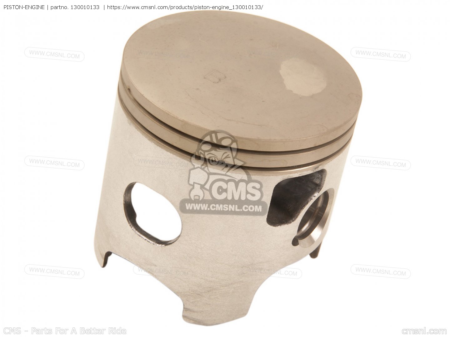

I noticed, after digging up some KDX220SR cylinder head info & wondering if the piston was the same, that I see two part numbers for KDX220 pistons, which are NOT different due to SR / B street model vs R / A offroad model....
13001
PISTON-ENGINE
130011423
supersession: 130010133
oversize info
€ 157.50
(USD $162.22 )
I'm going to bet that the one that has been superseded is likely the original made by SK Pistons of higher quality, and the one that is showing as the "superseded by:" is likely the one that kdxdazz had received when ordering a new OEM, which was made by ART Pistons and is the one notorious for cracking and self destructing....
CMS NL still shows that you can buy the the first part # 13001-1423 being available, as best as I can tell
https://www.cmsnl.com/kawasaki-kdx220-a ... 130011423/
And the one I suspect to be the problematic ART Pistons version # 13001-0133 with photo on CMSNL.com :
https://www.cmsnl.com/products/piston-engine_130010133/
13001-0133:
@kdxdazz - can you confirm via the photo if that's the ART Pistons version which you made the video of?
https://en.impex-jp.com/catalogs/moto/k ... 92974.html shows that the 13001-1423 is no longer available, however.

I can't tell from the photo if it's ART or SP. I see the different part numbers as you said, I think the only way to know is to call whoever is selling and ask them to look inside the piston
If I had to take a guess I'm going to say both pistons are made the same but the difference is in the deburring, the ART had zero deburring, as you know both my kdx220's are using the stock kdx220 ART piston that I deburred myself, no blow ups yet haha 😂
