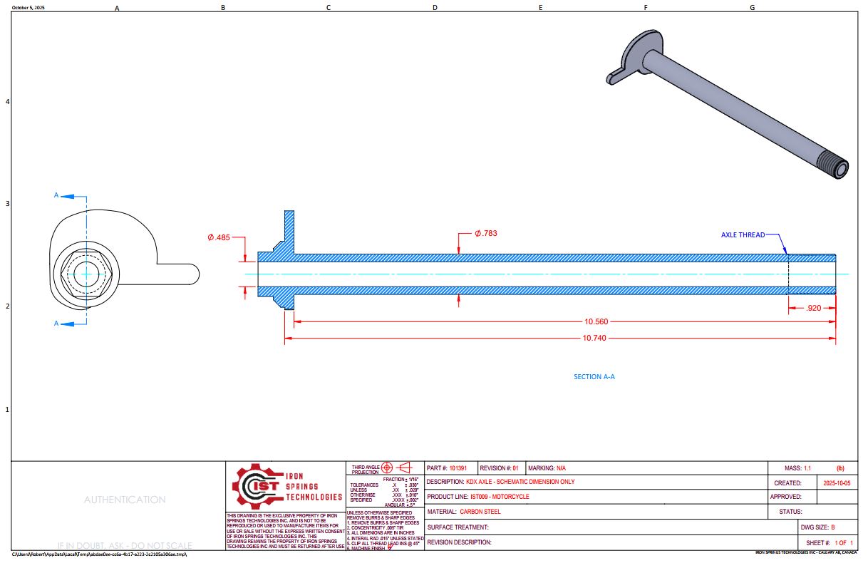

by Kawibunga
Apologies for the late response, hopefully it's not too late! Note that your the threaded side will be pounded out a bit and won't in reality be the same ID as the through bore. Mine measured .485" on one side but probably more like .450" on the threaded side - I drilled it out a bit when I noticed that.......

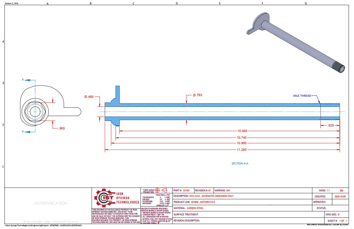

That is very helpful. I think I need the length from one end of the hollow part to the other but my bike is still being rebuilt at a buddy's so it may be a week or two. What I'm trying to do is mount a trailer that uses a skewer through the rear axle. The builder makes mounting hardware/skewers for the KLX250 but I think this might be a wider axle, not sure.
What he told me was he needed to know how long the axle was and that it would need to be at least 3/8" inner diameter for the skewer. This tells me the skewer will fit but not positive how long it needs to be yet. Regardless it is greatly appreciated

by Kawibunga
Ahhh - total length, not the inside length, not a problem....... stay tuned!
Re: Rear axle ID and length
Posted: 10:42 pm Oct 05 2025
by Kawibunga
This should have it covered......

by assquatch20
Kawibunga wrote: 10:42 pm Oct 05 2025 This should have it covered......
This is great, thank you again. I'll verify mine is more or less the same but I'm guessing it'll work. I'll pass this along.
