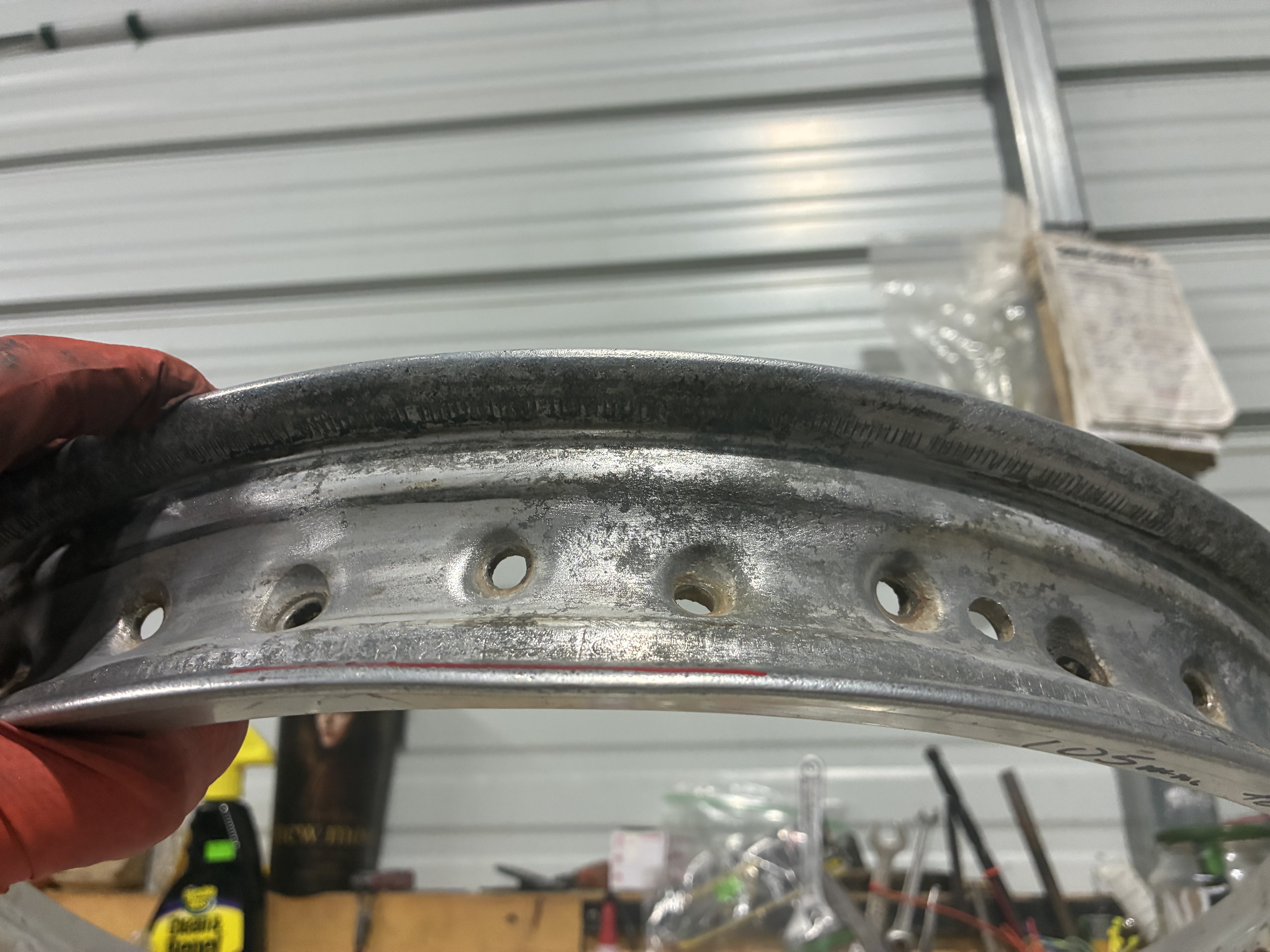

Doing spokes, a handful were seized, most hard to turn. It’s taken some good hits and getting pretty difficult to tighten and true because of the spokes. I’m wondering what your opinion is on running on running this rim. It’s mostly straight, the photo is of the biggest dent, the rest aren’t really noticeable unless it’s being trued. I think the corrosion is superficial. Hopefully it’s going to be a really long time or never until I take it down this far again and I don’t want the rim to impede that plan. I’m using Exel spline drive SS spokes fwiw.

I would try to read up on bending the rim back in. On the corrosion, I would lightly sand down the rough parts. Two rounds of duct tape was the old method before someone came up with $8 per wheel "special tape". I would definitely sand and polish the spoke head beds (the area where the spoke heads set. I would also put a drop of lube on them when building the wheels. You might get false spoke tension otherwise.

KDXGarage wrote: 01:10 pm May 31 2025 I would try to read up on bending the rim back in. On the corrosion, I would lightly sand down the rough parts. Two rounds of duct tape was the old method before someone came up with $8 per wheel "special tape". I would definitely sand and polish the spoke head beds (the area where the spoke heads set. I would also put a drop of lube on them when building the wheels. You might get false spoke tension otherwise.
