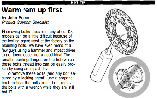

Here is a tip from a Kawasaki's K-Tech News.
Brake Rotor K-Teh News Hot Tip.png (92.64 KiB) Viewed 1882 times

KDX-G: huge thank you!
