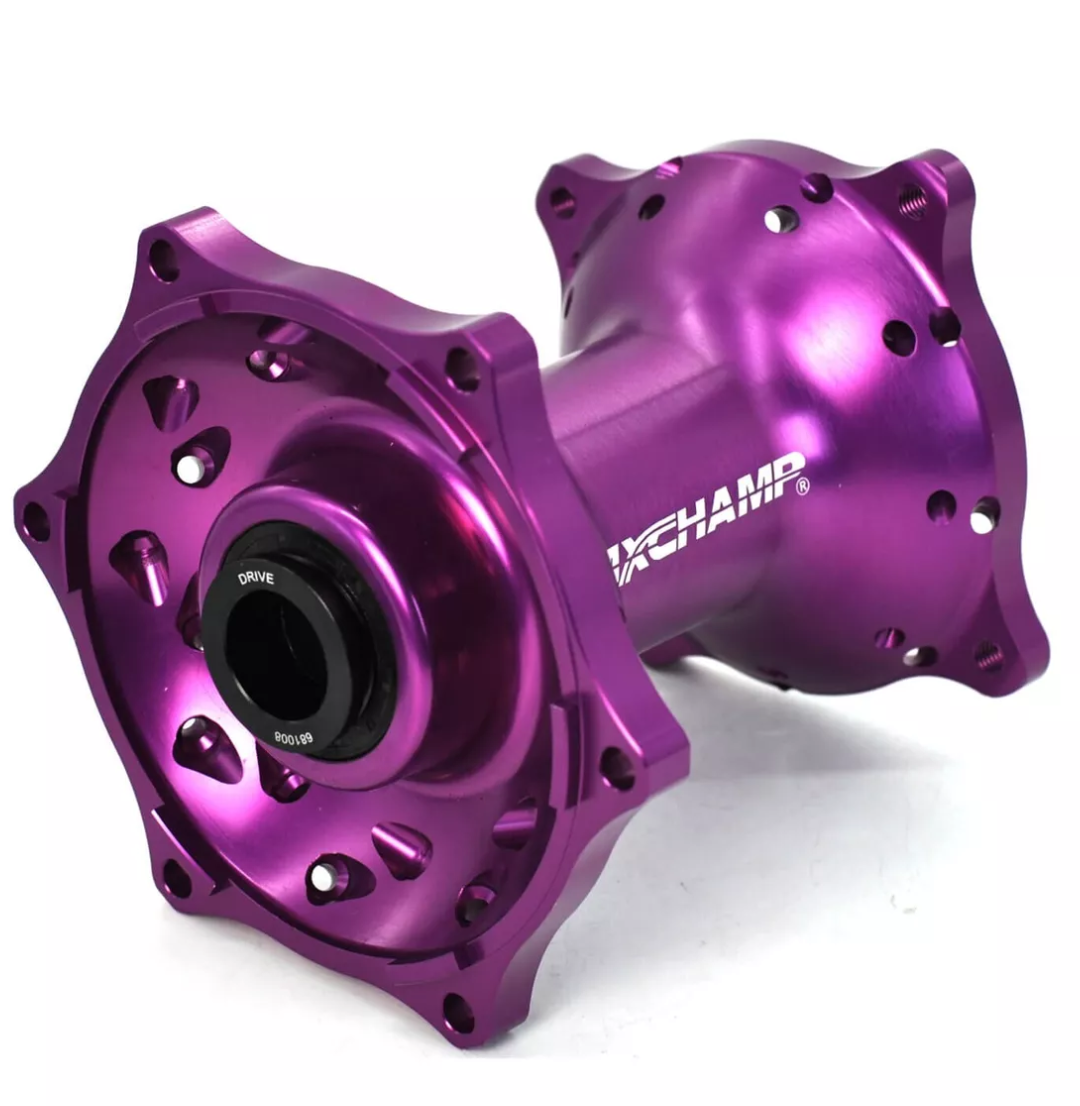

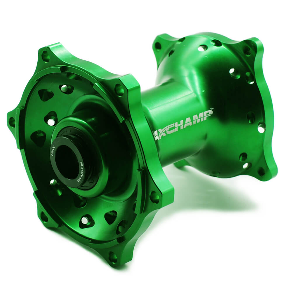

MXChamp are a high end Chinese brand that have nice billet purple and green anodized hubs, and upon request, they have special spacers to adapt to the older 20mm rear axles, and also advertise using high quality Japanese bearings, but these will still require the conversion rear rotors mentioned. My friend Sebastien has laced up this brand of hubs before, for a Boyko Racing customer, and vouched that they indeed seem to be of high quality.
As a workaround, there are some pretty nice 2003+ KX and KX250F rear rotor guards that double as caliper hangers, and these could potentially be modified and used with a basic but custom 25mm to 20mm bushing to fit the KDX axle while raising the caliper 10mm further radius to run a 2003+ 240mm KX/KXF rotor in place of the KDX's 220mm rotor...IF the swingarm interface would also be compatible or able to be modified within reason (I wish I'd saved the links for those trick rear rotor guards for KX250F's, I'll dig it up when I get a chance.)
The Tusk and MX Champ hubs will use OEM style spokes, which is nice, but not the period correct off-the-shelf rotors. The Talon, Warp 9, KKE, etc will mostly use their exclusive spokes I believe - double check this. Talon in particular I've read that the hub flanges are taller to run a shorter length spoke for more wheel rigidity.

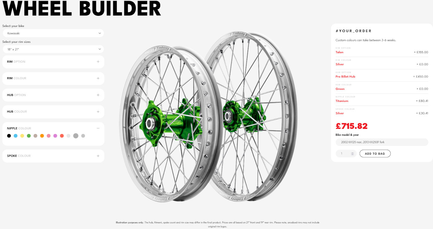

Talon's complete custom wheel builder ordering form tool is quite nice... In my eyes, these will be the best wheels you'll find:
https://talon-eng.co.uk/talon-wheel-builder/
It's an upcharge of + £80.41 for alloy, anodized alloy, or titanium nipples, if one were trying to cut costs, they could forego that option.
