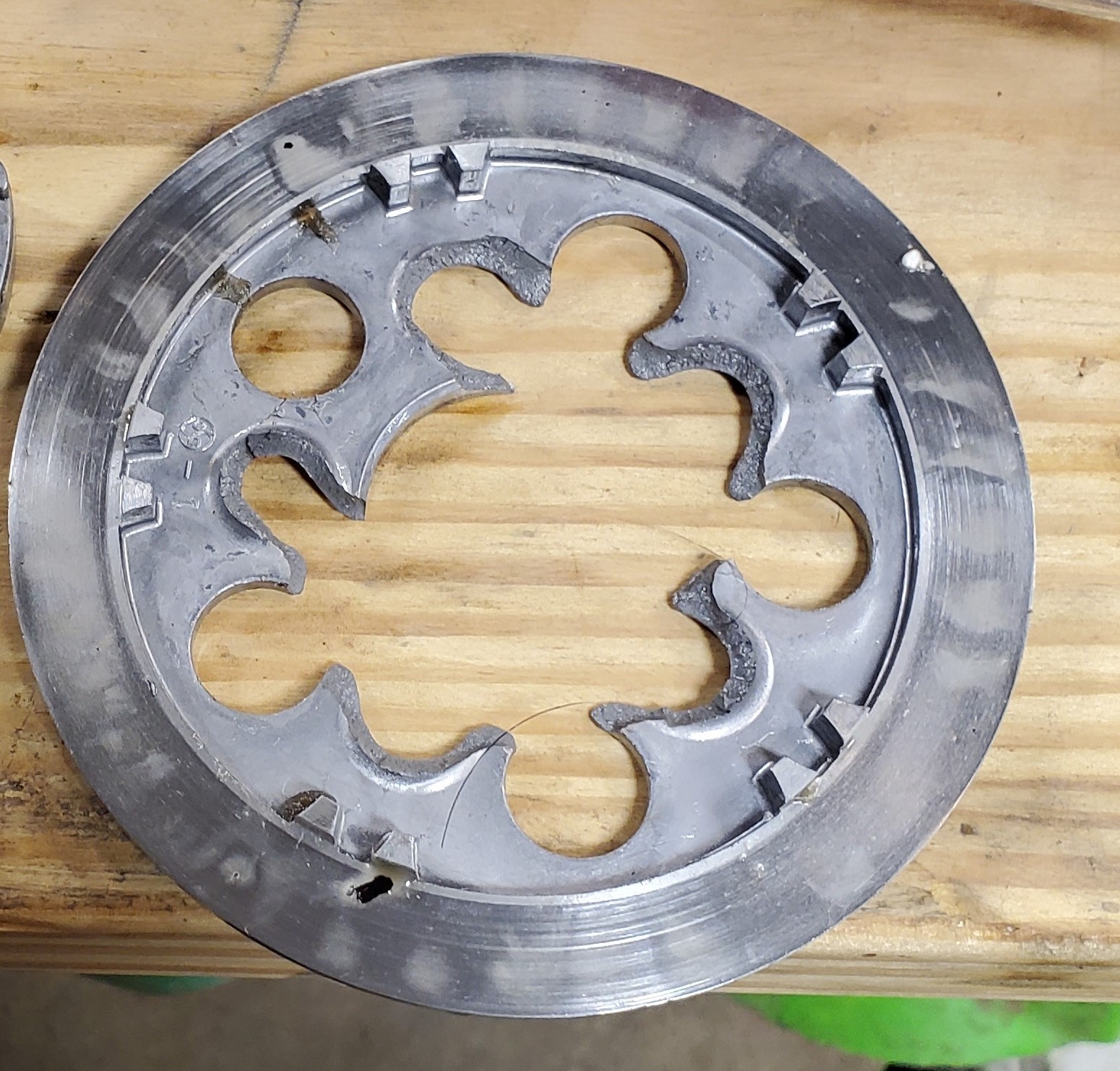

I just got a project 1989 KDX200 and the guy said the there was an issue with the clutch. When I took it apart I found out the clutch pressure plate (or 13086-1060 WHEEL-CLUTCH from the parts diagram) had basically sheared off the entire middle section, as you can see in the picture below. I have worked on quite a few bikes but have never seen this. I am assuming the previous owner just didn't put the clutch back together correctly, but I just want to see if anyone else has had this issue before. I just want to make sure there is not something worse going on. Thanks in advance.
- KDX200 Pressure Plate.jpg (536.17 KiB) Viewed 7064 times

Re: 1989 KDX200 Sheared Clutch Pressure Plate
Looks like installation error on his part.
I don't remember anyone reporting that before.
Yeah, that's what I figured. Unfortunately this is one of those parts that I guess they don't manufacture any more so I'll just be checking eBay until I find one.
