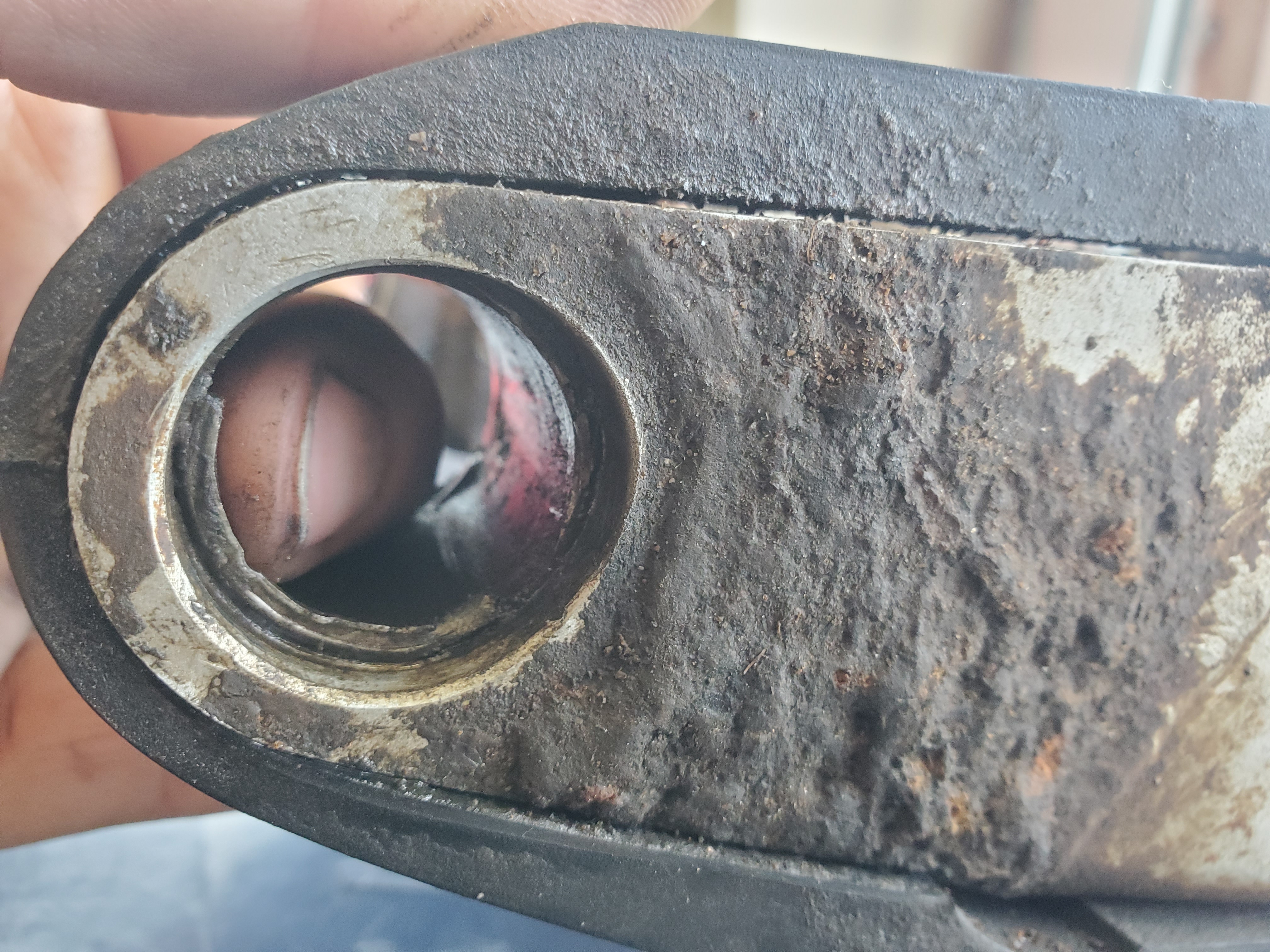

Has anyone attempted to, or is it even possible, to put a swingarm from another model on the kdx200 or any year within the E series? The holes where the swingarm connects to the engine case are a bit wallowed. I'm weary about purchasing a used one on ebay and running into the same issue. I'm not sure how to post pictures or I would ask for opinions. There's a steel ring inside the center of each hole on the swingarm. Is that an old bearing race or is that machined steel that was pressed in, to hold the bearings?

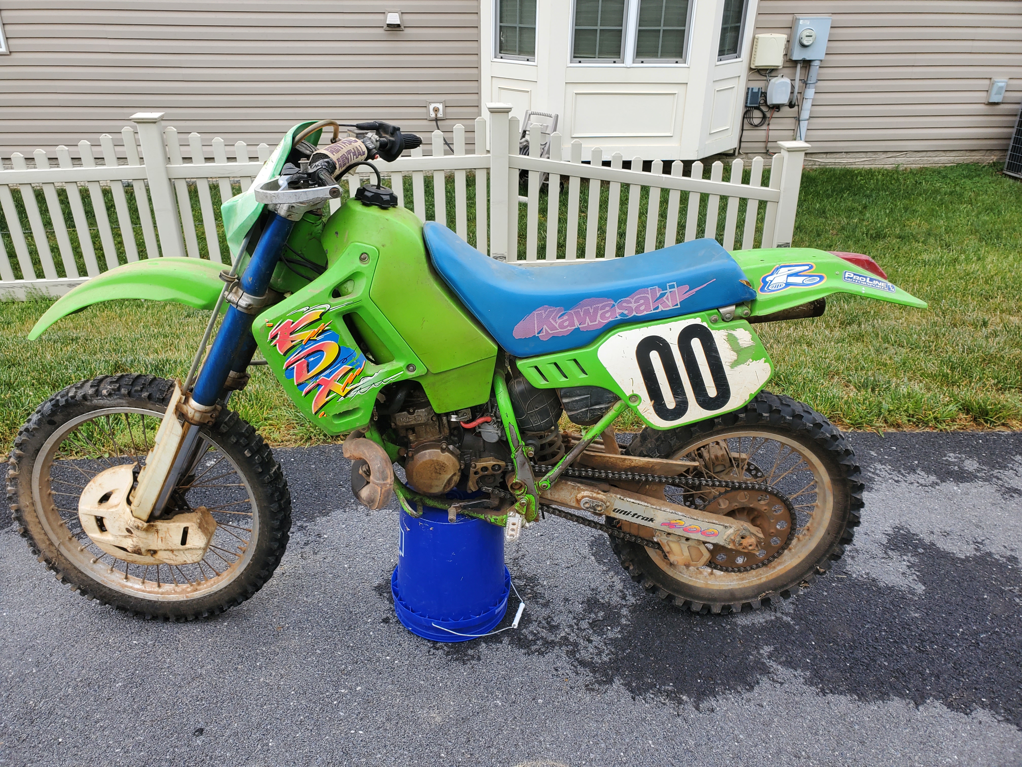

Thank you! Here's a picture of the bike I'm rebuilding (if it comes through).

Here's the reason I ordered a new swingarm.

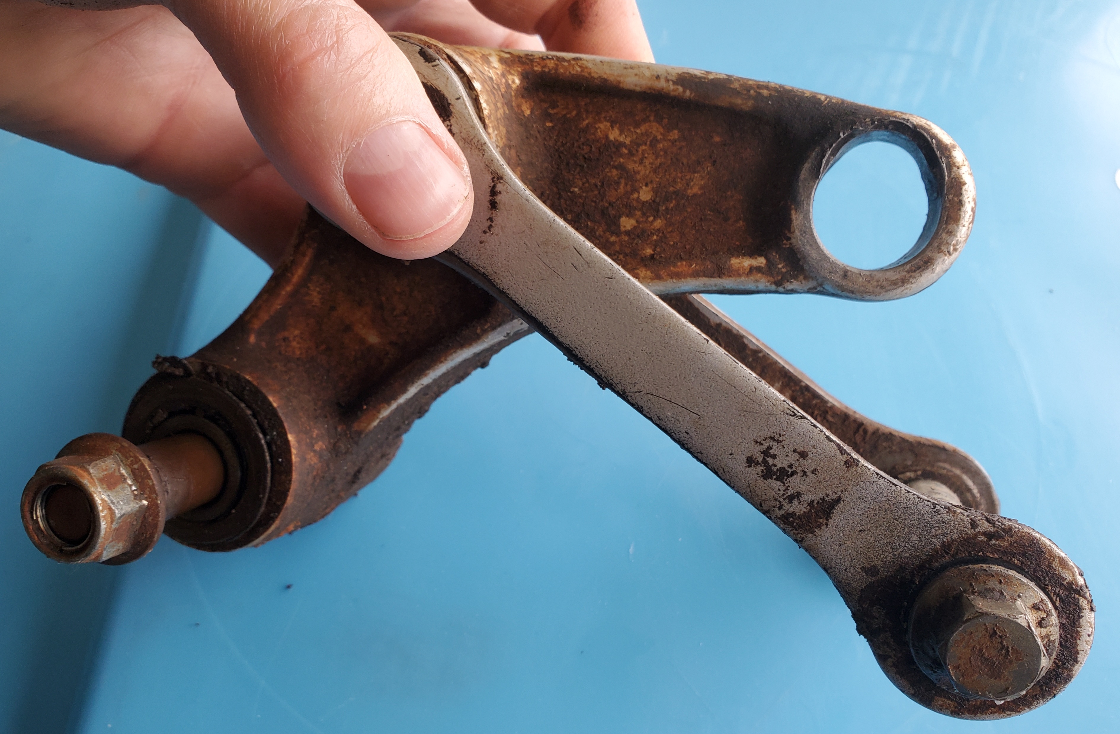

This is the reasoning for the new linkage.
- 20210530_175933.jpg (1.7 MiB) Viewed 10205 times
- Posts: 14741
- Has thanked: 181 times
- Been thanked: 46 times
Re: Kawigreen Frame/Swing arm bearing removal
I wonder how that could happen?
- ss109
- Posts: 6249
- Has thanked: 33 times
- Been thanked: 52 times

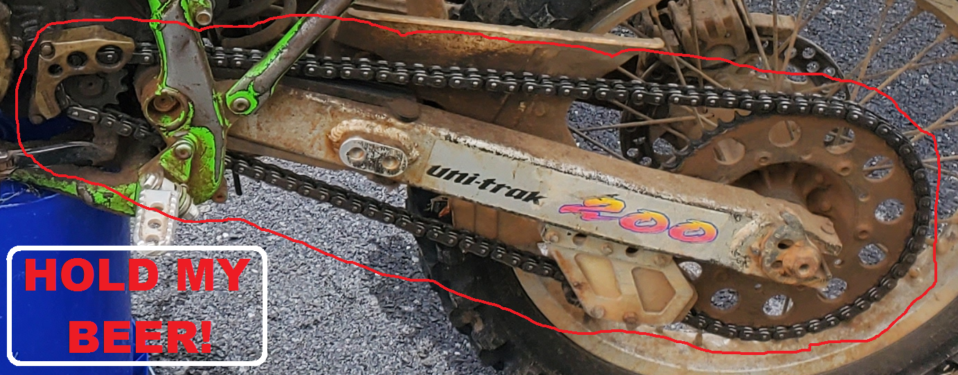

Man, that things begging to blow out the left hand case half!
- Posts: 14741
If you think it looks tight now, just imagine when the swingarm is parallel to the ground (tightest point of chain tension)
