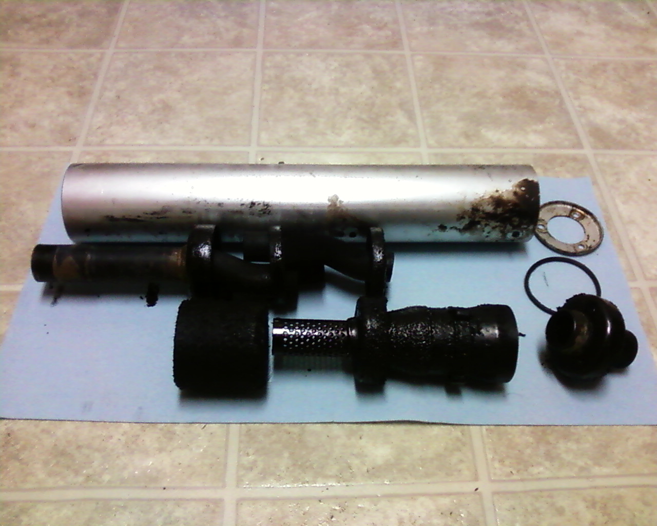

Shame someone cut it up. IMO it's the best silencer design every put on a bike by any manufacturer.
Here is a pic of the internals from an '89 to '94 stock silencer. Bottom left is the silencer packing. Sorry it's not a better pic.

I just got one off ebay to replace the cut up one. looked worse than that inside- the packing was basically pretified! I think I'll try running it without first.
