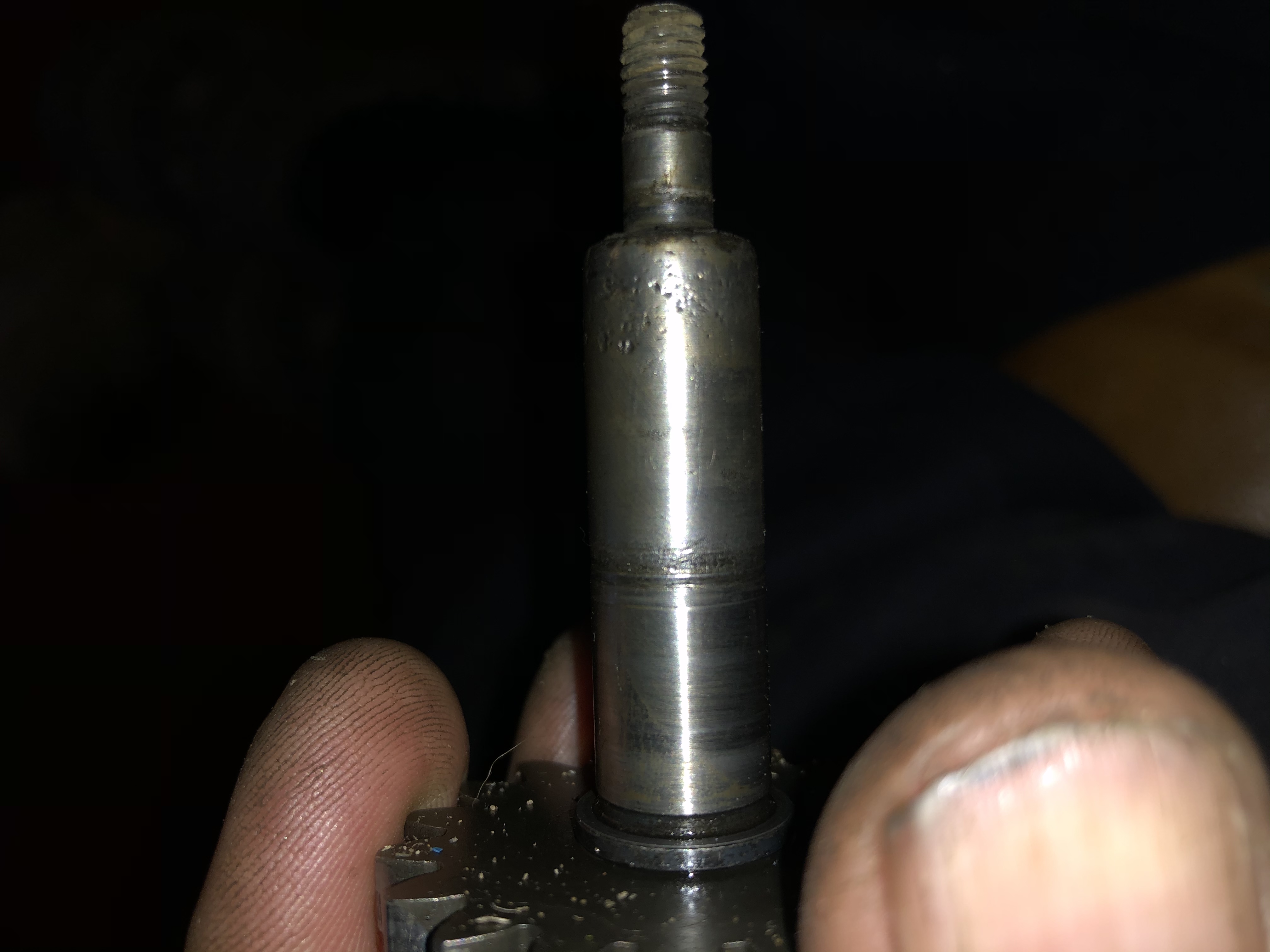

Hi all. My 250sr is getting water into the case past the water pump seals because the shaft is quite badly scored. The shaft is no longer available. Does anyone have any ideas for repairing it?

With no availability, as I said in the previous post, may be able to have a shop fill the score and turn the shaft back down to dimension. Not sure if JB weld would hold up in that application

JB weld won’t work.

Negative on the JB weld. I would tig it up & put on a lathe. After it gets machined down, you could polish it with emory cloth while spinning.

Molly's 70 wrote: 02:48 pm Jan 14 2020 Negative on the JB weld. I would tig it up & put on a lathe. After it gets machined down, you could polish it with emory cloth while spinning.
Wouldn’t it wear down again pretty fast without the chrome?

Maybe, but it would work for quite a while. I would have to look at a good filler rod selections.
