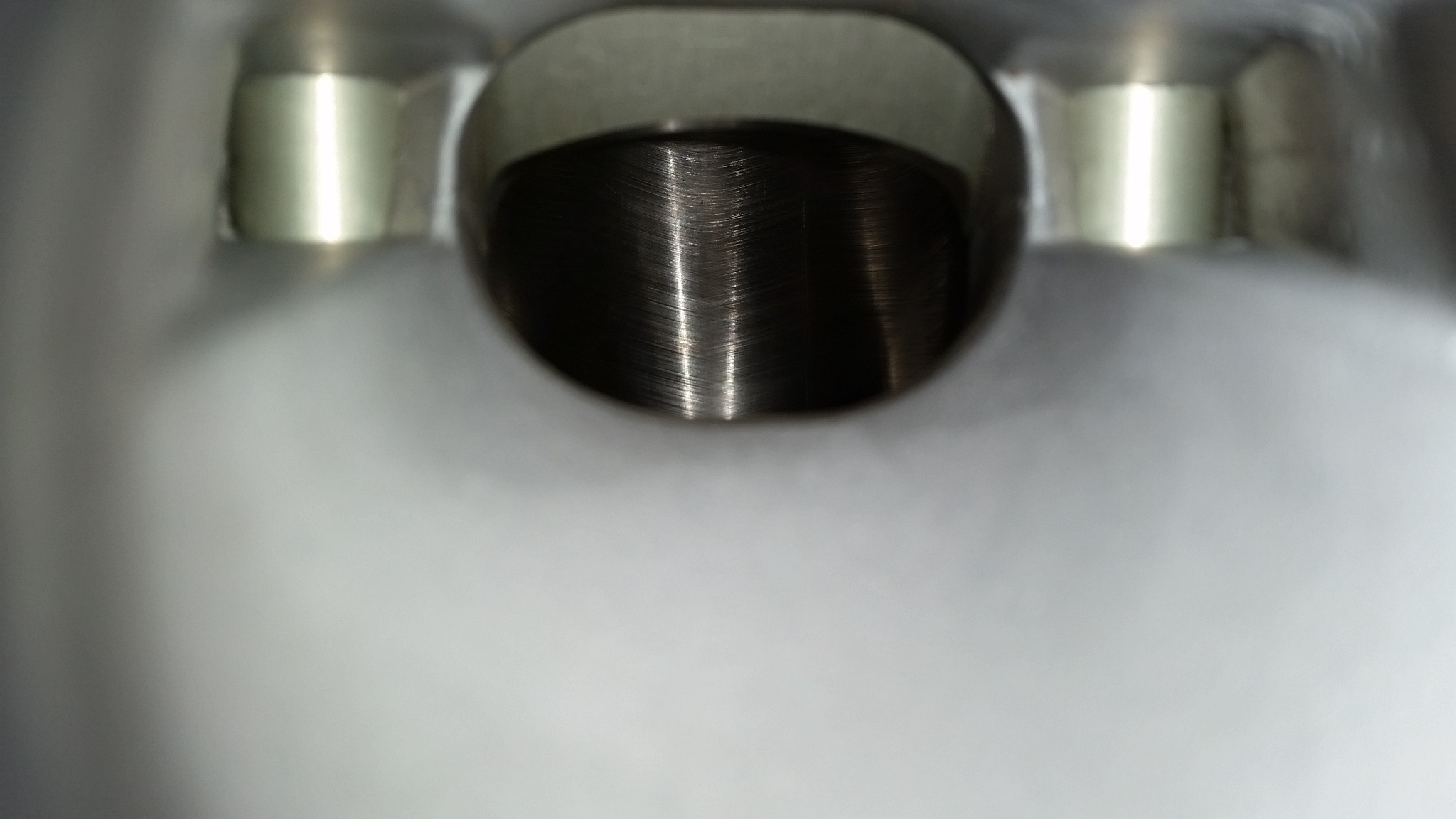

This morning I started on the motor. I looked through the exhaust and saw there was no cross hatch on the cylinder and noticeable wear and blow by on the piston so I figured the top end has never been apart.
Head looks untouched, was hoping it had been modded by RB Designs but it doesn’t look like it’s been changed at all.
Piston is worn with some blow by, time for a new Wiseco. Anyone know if this OEM?
Cylinder is pretty good for 15 years old. Once I get it cleaned and all the bolts out I’ll send it to Powerseal USA for replating.
Power valves will be next, wish me luck.

A Kawasaki Electrofusion cylinder does not have very much cross hatching new. If you were expecting "other brand" or aftermarket level of cross hatching, then that might explain it. I have had a new KDX175 cylinder and a new 1989 - 1994 cylinder. Neither looks like aftermarket. They are fairly smooth.
Here's a picture of my new 2005 KX250 cylinder, which is a newer style coating that they started on the 2003 KX's. New KDX cylinders look nothing like this.

I'm pretty sure that's the OEM piston. Mine had the same cross-hatching in the casting. That white coating on your head studs is "white rust". It's the remnants of the zinc plating. You can wire-wheel it off, but then you'll have raw steel that will rust. Soak them in naval jelly or phosphoric acid to create a protective black oxide coating. To get the studs out, I found a 50-50 mix of ATF and acetone to be the best penetrant. Then really tighten a pair of jam nuts on the studs, heat the area of the case around the studs, and use an impact wrench. Don't forget to remove the coolant jacket plug before sending the cylinder off for replating.
I'm not familiar with Powerseal, but I'm really happy with the work Millennium did on my cylinder. I sent my Wiseco piston to them with the cylinder which they used for perfect clearance.

Measured the piston and it’s still within the service limits as are the rings. Don’t have the tool to measure the cylinder bore. Powerseal and Millenium are the two go to companies for replating. I’ve never done it but they both are highly recommended on the TT Forum. I was told to send them the piston like you said too.

Yup, that is what I expected. Apparently the Electrofusion isn’t terrible though cause it’s held on for at least 15 years in this bike.
