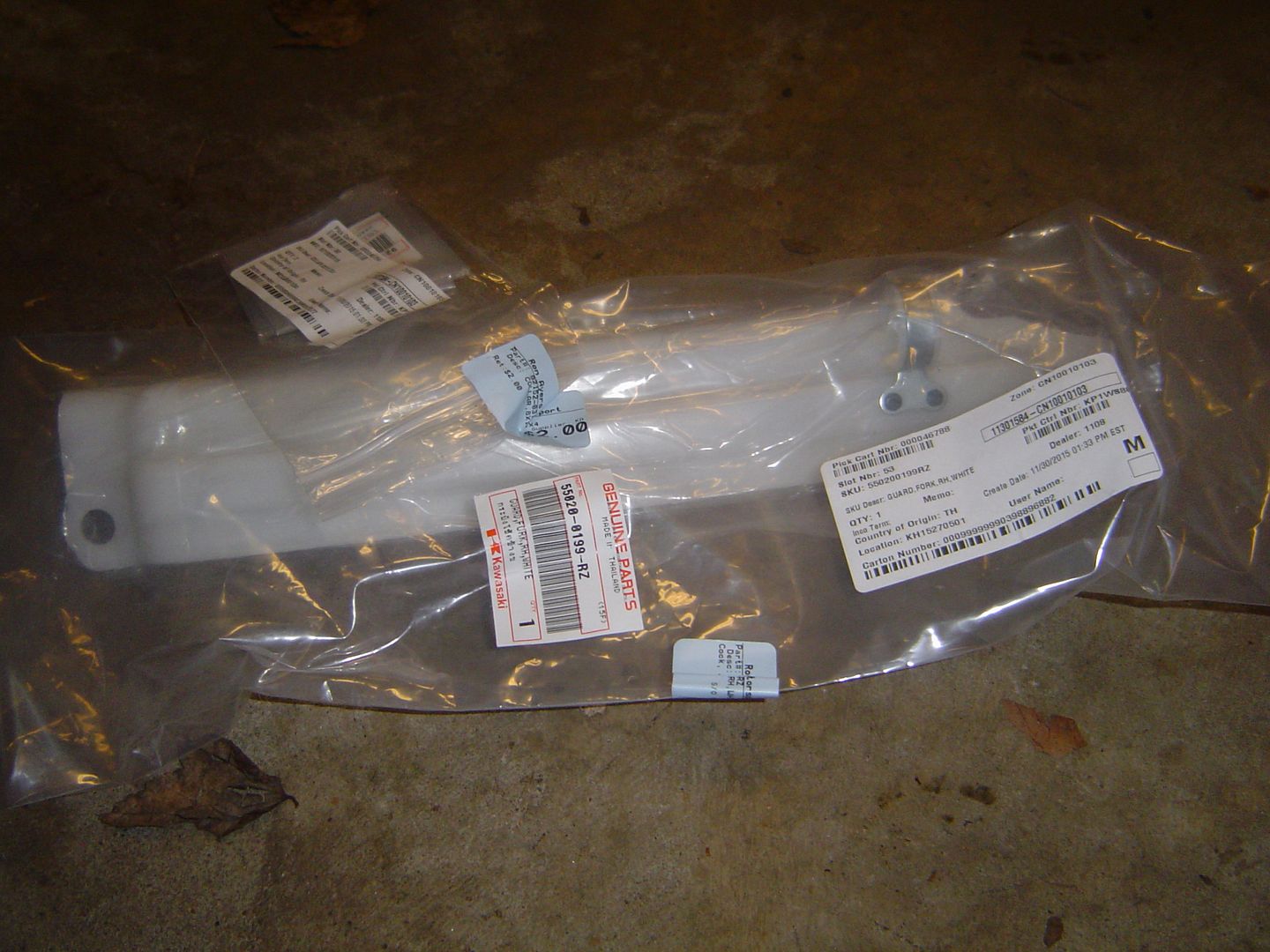

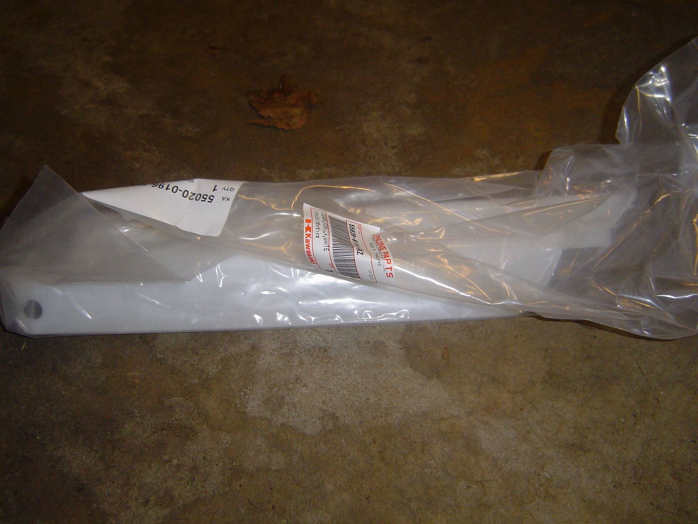

Well, like I said, haven't installed them yet. But, I lined them up with the forks and they seemed like a perfect fit! I used the regular stock number and found all my parts except for one, the RIGHT fork guide. The RIGHT fork guide I found as a KLX substitute with a couple additional spacers. I don't have the receipt of where I got them from online, but they are a substitute intended for a KLX and I was assured they would fit a 1993 KDX200.
Here's what I ended up with.

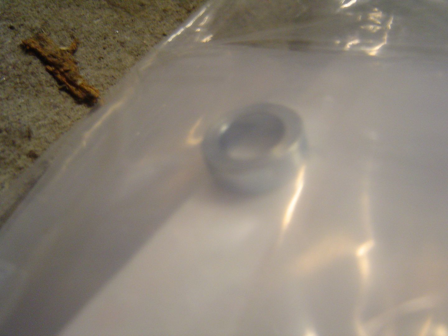

RIGHT HAND fork cover. This was the one that seemed to be out of stock everywhere and finally purchased the substitute that I was assured would fit my 1993 KDX200. I lined it up when it arrived and it matched my forks. It also came with these additional spacers (collars)? I'm sure I will need them.
Guide, Fork, RH, White #55020-0199-RZ AND Collar 8x12.7x4 SKU# 921520315 Qty. of 2
LEFT HAND fork cover. I found this to be available. Of course, I'm sure the KLX substitute is the also the same just different part#.
Guide, Fork, LH, White #55020-0196-RZ

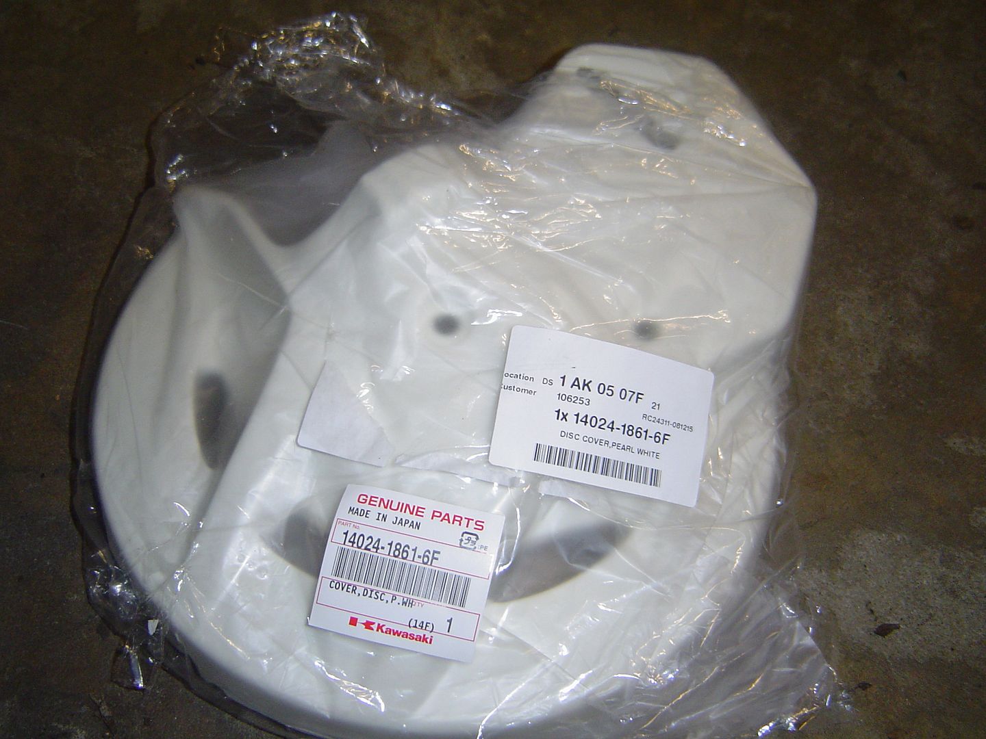

Don't forget the fork cover guides: Guide, Fork, RH, W and Guide, Fork, LH, W
And disc cover if you need it: Cover, Disc, P.WH
