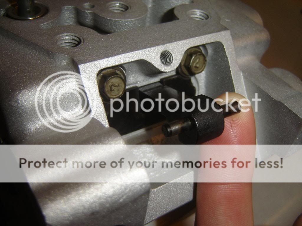

While refreshing the top end of my bike I discovered a mystery nipple. It had no hose attached and was a bit gunked up.
Should a hose from the carb attach ere? Should there be an additional hose attached?
My KIPS area is also missing these two bolts.
What function do they serve?

The "nipple" is used to plug the case breather hose...
The 2 bolts, if you mean the ones with the number "7" on them are used as stoppers if I remember correctly..
