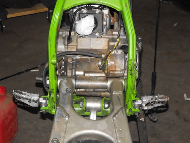

pics would be helpful ..

Agreed. I'm about 1000miles away from my bike right now, but I'll try to post some this weekend.

Rjcapt
Posts: 94
Joined: 07:11 pm Sep 25 2011
Post by Rjcapt »

doesnt look like an 01...

This is an 02. same as 01

No, it doesn't look like an 01. Anybody know what it is? I'm going to run the vin to see what's going on, but I have an 01 frame and they are identical.

It doesn't look like a 2001 because it's a 1997....

I'm making progress slowly.
I got a 2000 swing arm and modified it to fit, reamed the case and welded in new mounts. I stretched the pipe 3/4" to fit and sent the carb/head and cyl out.
I still need to mod the KX airbox to fit the KDX boot, fab up the silencer and fit the 97 shrouds to the 01 frame.
I'm pretty happy with it at this stage, hopefully it will work well for me.
