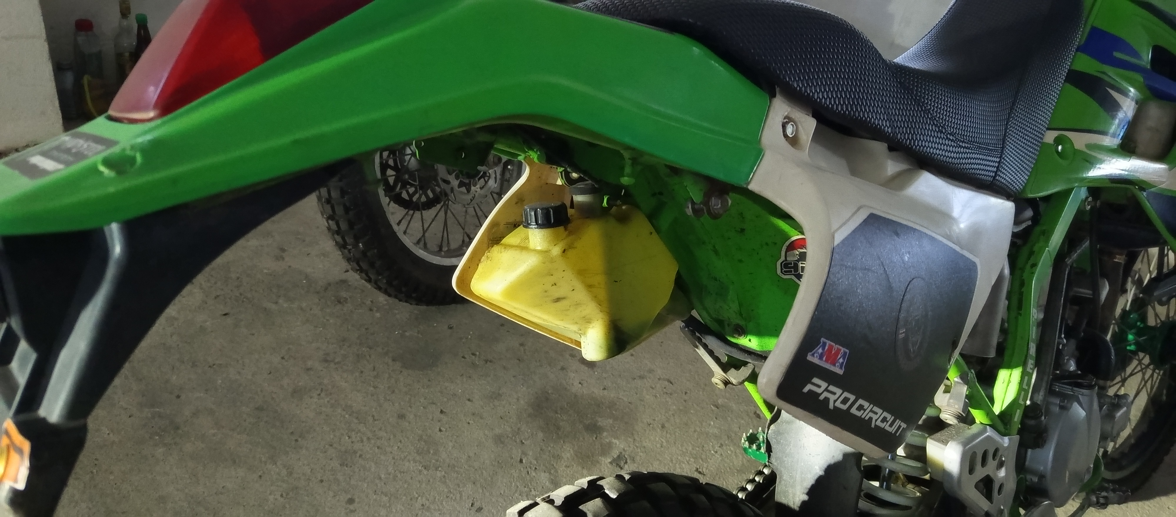

Will try get the photos posted, how much room do you have with the plastic tank ? As an idea, my kdx 220sr has a Clark plastic tank and there was no room to fit my fan so I heated the tank with my plastic welder to make room for the fan
kdxdazz
- Posts: 621
- Country: thailand
- Location: Thailand
- Been thanked: 41 times
Re: Plastic tank and autolube
Taken at night so not the clearest photo
- IMG_20251008_180131.jpg (2.01 MiB) Viewed 41871 times
Thanks a lot!
There’s not much space under the plastic tank, and the oil tank is quite bulky to try to fit it in. I think the original steel tank is c.2 litres smaller than the plastic one.
I’ve ordered a KDX 220 and will try to install it in the back instead of the coolant reservoir, hopefully that’s easier to adapt!
- Posts: 3559
- Been thanked: 10 times
You can repurpose the coolant reservoir to use for oil and just run the overflow tube that went to your reservoir anywhere else. If you do overheat you'll need to check your coolant level since there will be no catch tank. I run my 220 Hybrid without the coolant overflow and have never had any issues.
