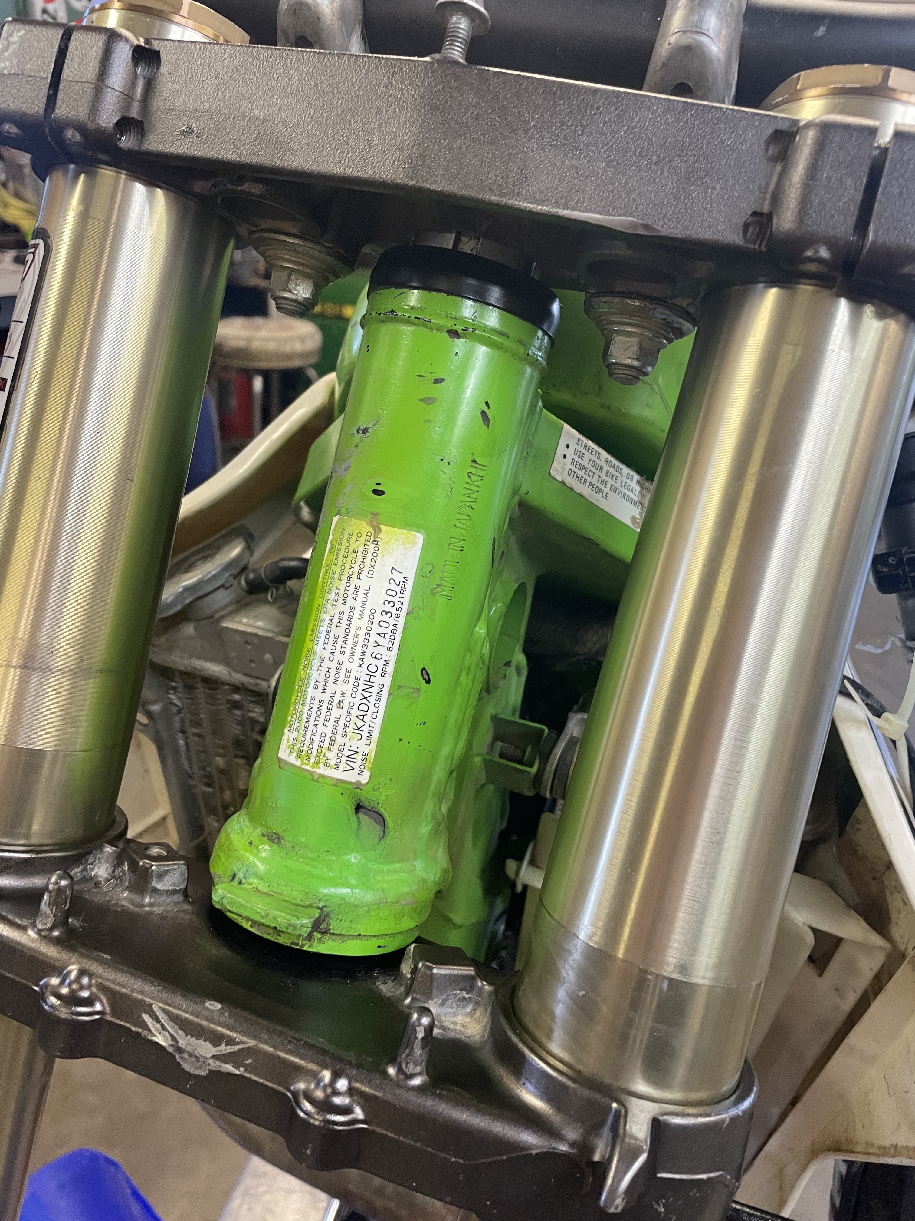

Upon looking at the YZ stem in the KDX head tube a little closer, it appears that it is slightly longer than the KDX stem. With that I have read on here that there is mainly one option, being option one below. Has anyone tried options two or three below?
1. Shim the upper bearing race slightly higher to get more crush to adjust steering movement. This appears to be done by either putting a shim on top of the bearing or underneath the outer race, if I am thinking of it correctly.
2. Take a 28 x 1.0 metric die and tap threads a little lower on the aluminum stem to where the steering adjustment nut then puts enough pressure on the upper bearing. Coupled with this I would run a concial washer on top of the top triple clamp, so I do not bottom out the flange nut on the top triple before getting the nut torqued to spec.
3. Press the stem slightly lower in the bottom triple clamps, effectively lowering the overall stem length to where it is closer in total length to the KDX stem.
Any insight is appreciated. :pop:

Where is the upper bearing steering stem position bottom limit located at in relation to the bottom of the actual bearing installed in the frame as stock, with the updated adapter bearing size? If it is anywhere in the vicinity of the bottom of the bearing give or take 2 mm, I would run it as is, and if you needed additional stack height on top, which from memory should only be a few millimeters, I would add an extra spacer above the bearing and seal on the steering stem, in order to get the lock nut to clamp down properly.

The only reason I would shim the upper bearing outer race higher in the frame with a custom shim would be if I were using the Japanese NSK (or All Balls version) 30x47x12 bearing where the KDX frame itself is 15mm tall, which one other's wise results in the bearing being 3mm down in the hole since it's a skinny profile height bearing.
I have a couple of these bearings for my swaps, the 30x47x12 NSK bearings... Pyramid Parts stoped selling the kit that I bought that includes the seal and a 3mm spacer, so that's unfortunate, but the bearing is still available from them. I'll have to look and see as the seals came from the USA and bearing from japan, even though pyramid Parts is from the UK somewhere. So perhaps I can get a part number off of the USA made seals and just get those separately. Cutting a spacer in my lathe there's no problem. Finding the time to work on fun projects is the only problem for me these days!
All Balls sells that kit readily, 30x47x12 with spacer and seal, but for your application, you would still need a custom machine to match up to the 28mm stem, a bearing reducer bushing that is 1 mm wall thickness with a large flange on the top like a washer to sit on top of the bearing and seal and keep the spacer sleep from sliding down on the stem into the frame.

Update - I ended up getting the bearings in that I had ordered. The outer races pressed into the KDX stem without issue. I also got enough crush on the upper steering bearing without having to tap more threads onto the steering stem itself. I ended up modifying some of the upper bearing seal off of my KDX to cover the new upper steering bearing. The bottom seal sat on top of the bottom triple without issue. I also included washed underneath the flange nut that tightens the triple clamps down as I was bottoming that nut out. Forks mocked up well but appear to be way too long. Potentially needing to shorten them internally by about 1 to 1.5 inches. I also will need to weld on a steering stop tab as the lower triples miss the stops by being slightly lower than the KLX triples.
So far this appears to be a viable option based on stem length.

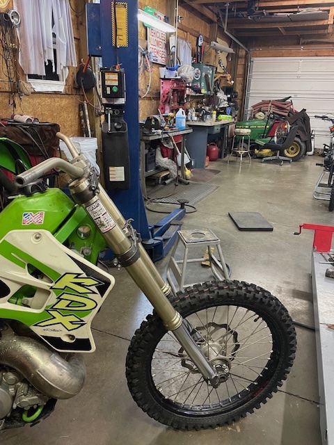

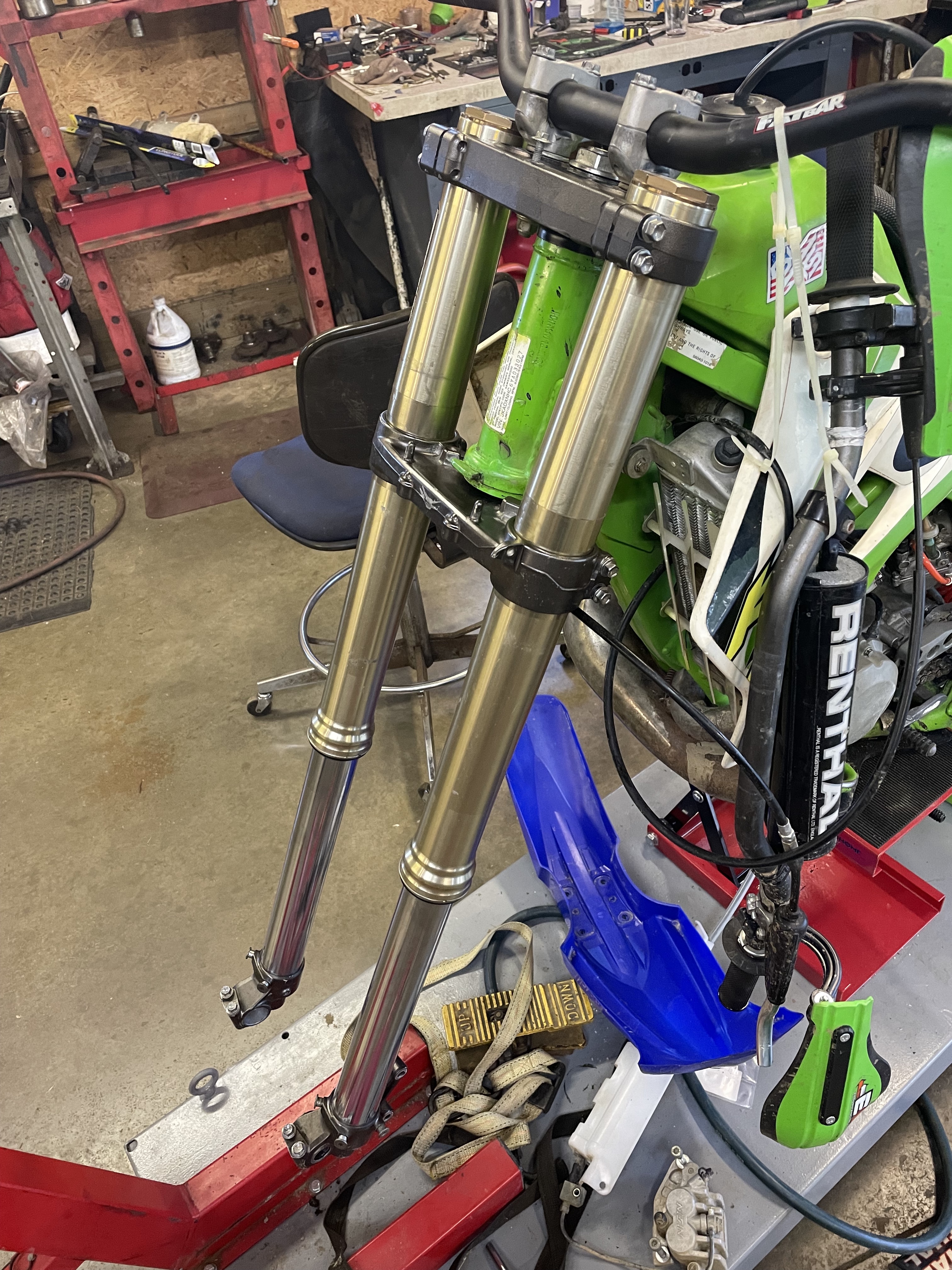

I ended up getting the forks mocked up in the chassis. It is apparent that I will need them shortened by quite a bit. The steering stop from trick engineering worked well, however, I needed to grind it down to allow for full turning radius. I think I will grind the stop slightly more after I get the shortened forks back from Protune. It looks like quite the chopper right now... ready for desert racing LOL

Hey, thanks for the update! I'm glad to hear that Trick Engineering steering stop worked out to be plenty enough material! It's better to have to file off a little bit, than to not have enough to begin with, that was my biggest fear with my recommendation, although I did give caution to that area of concern!

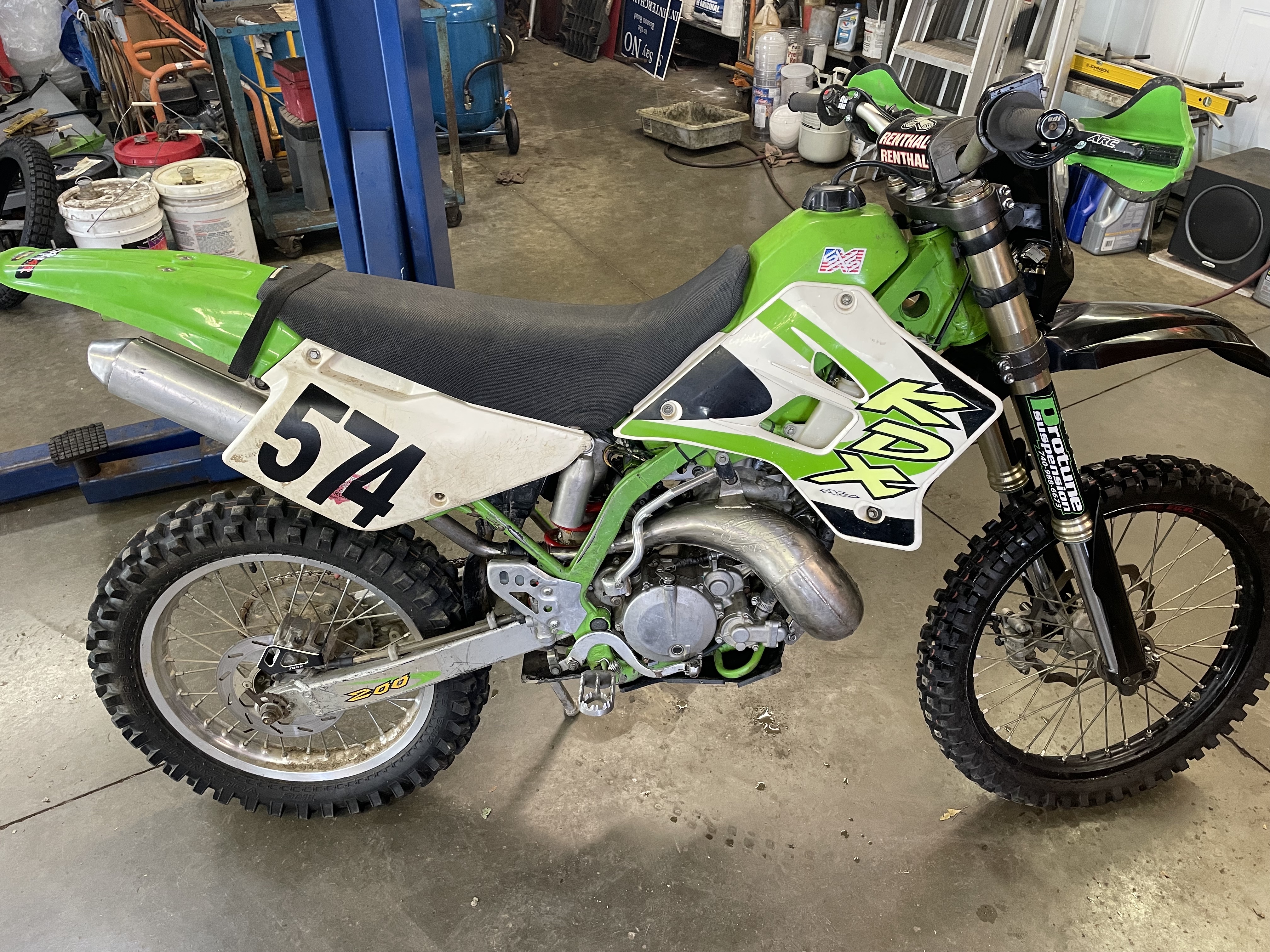

Here is the finished project. The only other to do is potentially get some KDXRider.net stickers for the front fender, figure out the headlight situation, and get a rear black rim mounted.

ebulic19 wrote: 08:47 pm Oct 09 2025 Here is the finished project. The only other to do is potentially get some KDXRider.net stickers for the front fender, figure out the headlight situation, and get a rear black rim mounted.
Looks amazing! Glad you got it finished. I bet it rides great!
