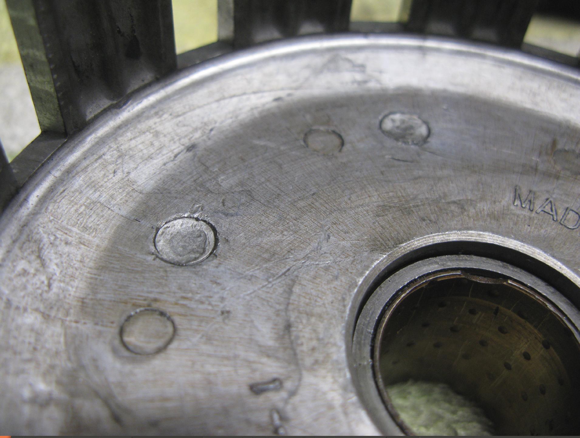

Back on my clutch with new rubber cushions - screws or rivets? I had a friendly back and forth with the local rivet place (Hanson Rivet) and they sent out their closest match. They were a little bit under on the diameter but seemed close enough.
My alternative would be to tap and use machine screws with loctite (which is not uncommon on replacement kits for clutch cushions and hubs).
It seemed like either method would be ok so I flipped a coin and went with the rivets.
Clutch hub riveting
_click here to zoom_
It did not take that long to hammer 'em down, some came better than others but, overall, I am quite happy with the result - one less thing to worry about coming apart :grin:
(Details and part numbers will be in a later post.)
