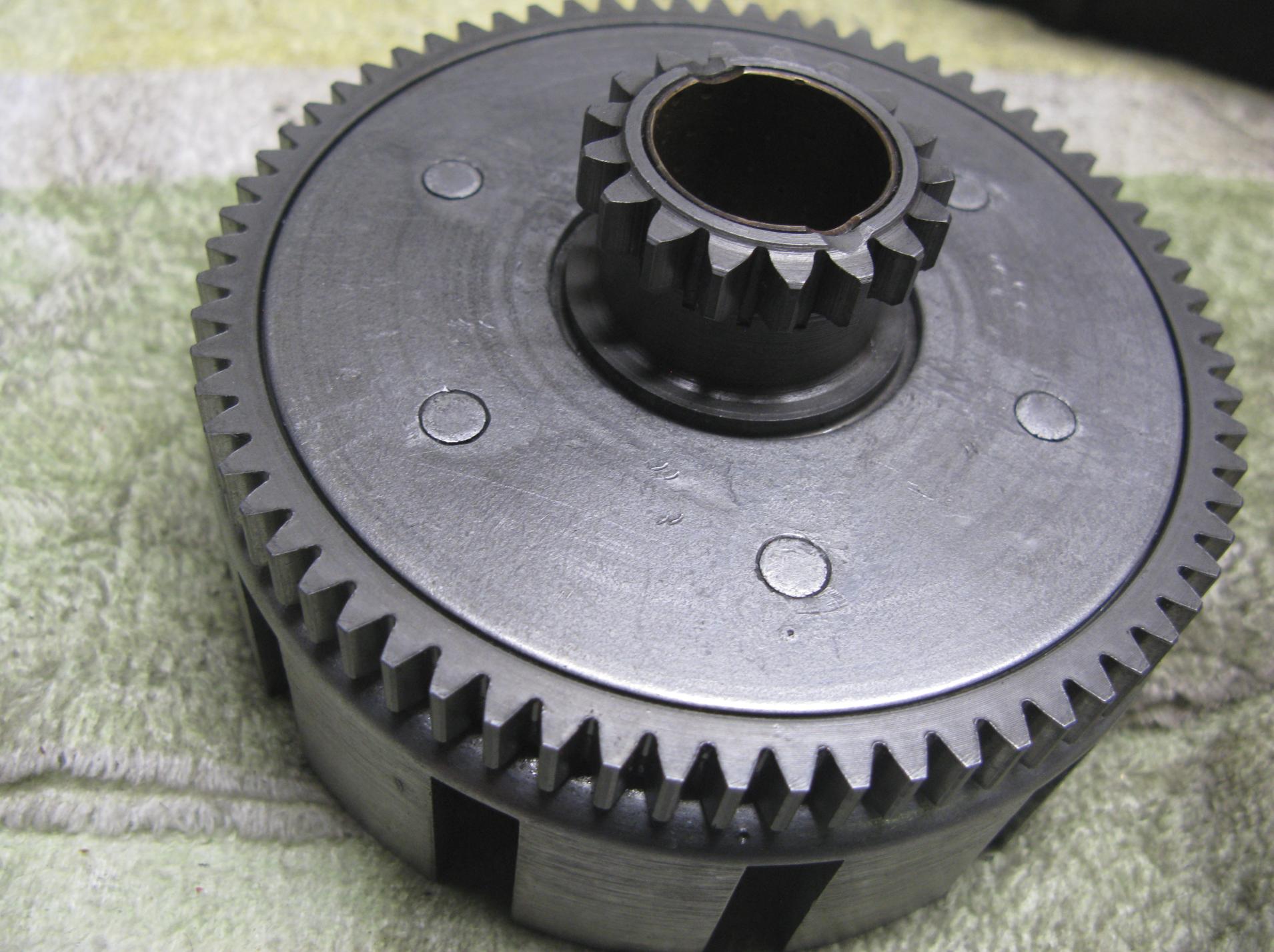

Back on my clutch with new rubber cushions - screws or rivets? I had a friendly back and forth with the local rivet place (Hanson Rivet) and they sent out their closest match. They were a little bit under on the diameter but seemed close enough.
My alternative would be to tap and use machine screws with loctite (which is not uncommon on replacement kits for clutch cushions and hubs).
It seemed like either method would be ok so I flipped a coin and went with the rivets.
Clutch hub riveting
_click here to zoom_ _click here to zoom_ _click here to zoom_
It did not take that long to hammer 'em down, some came better than others but, overall, I am quite happy with the result - one less thing to worry about coming apart
(Details and part numbers will be in a later post.)

KDX175 Clutch Hub Rubber Cushion and Rivet Details
The clutch hub replacement cushion seems to be unavailable for the KDX175. The closest match that I could find is the KX80/85/100 '88-20. It is slightly larger than the KDX175 cushion and needs to be shimmed for a snug fit on the "D" post. The cushion also needs to be sliced slightly thinner to fit (see a few posts back for details).
The rivets are not listed by the parts suppliers and, presumably, are not available from Kawasaki. Working with a local rivet place, I used a close match to great success.
Part numbers and sources follow. See a few posts back for dis-assembly / assembly details and photos.
Quick list
Sep 30, 2021
OEM KDX175 cushions Closest replacement KX80/85/100 '88-20 cushions Rivet diagram Replacement rivet - allow 0.156" Clinch Allowance for total length of 0.621"
The end result is a bit stiffer as the new clutch cushions are slightly larger in OD - it takes a little bit of coaxing to assemble.
That's it
Quick list
Sep 30, 2021
Rubber cushions (dampers) Pro-X seems to be the manufacturer/importer of the rubber clutch cushions which are available from several resellers. Clutch cushion Manufacturer Pro-X Part number Description ----------------- ----------------------------------------- 17.CRS4198-6 ProX Clutch Rubber Set KX80/85/100 '88-20 https://www.pro-x.com/search/?search-brand=2&search-model=245&search-year=2003&search-submit=SHOW+RESULTS - scroll down to "Clutch Cushions Clutch cushion sources SVS Powersports Part number Description Price --------------------------- ---------------------------------- ------------------ 115817 PROX CLUTCH RUBBER SET KX85 '01-18 $38 for a set of 6 https://www.svspowersports.com/ - clutch cushions may not be listed online - a call may be needed to order ----- Parts Giant Part number Description Price --------------------------- ---------------------------------- ------------------ 383948 ProX Clutch Cushion Set KX85 '03 $36 for a set of 6 https://www.partsgiant.com/p383948-prox-clutch-cushion-set?f=126306 ----- Amazon Part number Description Price --------------------------- ---------------------------------- ------------------ B07HF5498Y Pro-X 17.CRS4198-6 Clutch Rubbers $35 for a set of 6 https://www.amazon.com/s?k=B07HF5498Y&ref=nb_sb_noss - SVS Powersports sold through Amazon ----- Ebay is another possible source -------------------------------------------- Rivets Rivets are also unavailable from the usual motorcycle parts sources. The rivet place I went to had a close match that was fine. If you contact other rivet houses, however, you may find a rivet with a closer match of the diameter. Rivet Manufacturer and Supplier Hanson Rivet part Number Description ----------------------- ------------------------------------------------------------ Countersunk Head Steel rivet, countersunk head, 5/32" diameter, 0.621" length https://www.hansonrivet.com/rivets/solid-rivets/commercial-solid-rivets/ - call to inquire - ask nicely and a sample of 10 rivets cut to length may be forthcoming :-) - the OEM rivet has a diameter of about 0.167" - the new rivet has a diameter of about 0.156" -------------------------------------------- Rubber Cushion Shim Generic Supplier Description ----------------------- ---------------------------------------------------------------------- Vinyl tubing Black semi-rigid vinyl tubing, approx 0.590" OD, 0.075" wall thickness - as described in the earlier post, heat the end of the tubing and fit it over the "D" shaped post. - trim flush with the top of the post - the new KX85 clutch cushion will now fit snugly
That's it
