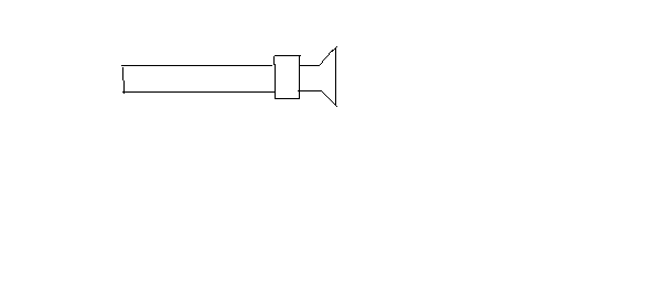

so I got to taking the clutch cover off and the basket out and laying in the bottom of the case there was a steel pin. The clutch basket had some pretty deep gouging on the outside but it should still be usable. That pin must have been loose in there the whole time I had it and grinding away at the basket and case. Now the thing is I have no idea where that pin is from. I was wondering if anyone whos rebuilt these motors can recognize it. I had some friends look at it to see if they know and I looked at parts diagrams but no luck. My phone camera is broken so I cant take a photo of it but enjoy this crudely drawn ms paint drawing of it, it's about an inch long for reference. I got new plates and basket ordered but I'm definitely worried about that pin.

no idea why the photo uploaded three times but yea there it is

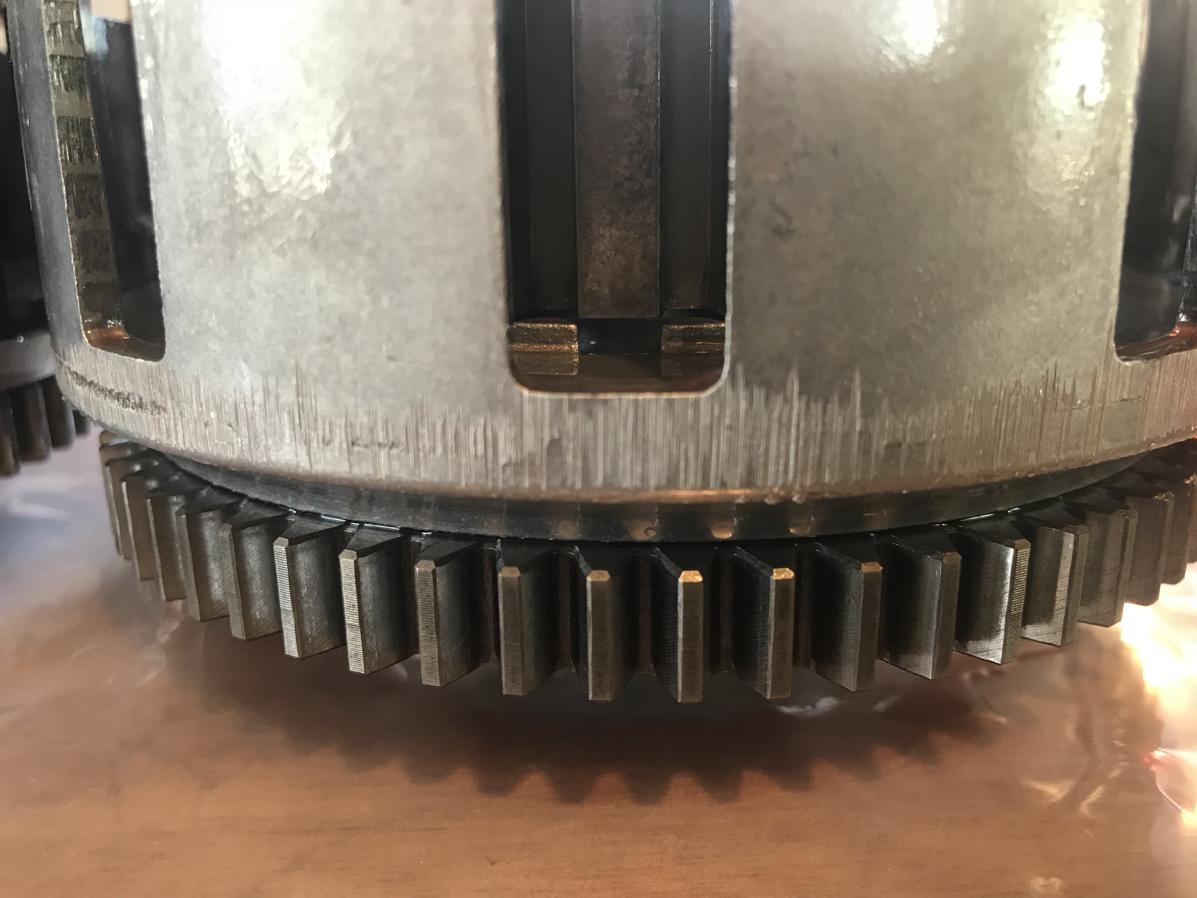

Is this what you’re referring to as gouges on the clutch basket? If so, that’s completely normal and comes that way from the factory.

no about halfway up the basket there's a ring all the way around where that pin would catch between the case and clutch cover and gouge the splines. I ordered a new basket too because a couple of them are almost halfway eaten through. shame because that basket looked brand new.G22inSC wrote: 04:17 pm Nov 07 2020 Is this what you’re referring to as gouges on the clutch basket? If so, that’s completely normal and comes that way from the factory. 9E932D2B-D7C8-41F5-8A24-ED586D5C6A51.jpeg
