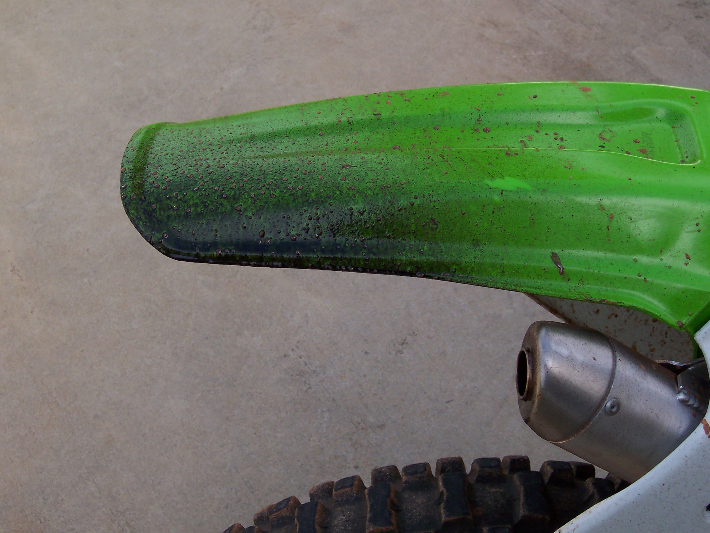

As far as the oil goes, you need to drain it first. Then measure out a certain amount and pour that in. Run it for a while and then drain it back out and measure what you get. This will give you an idea if you're losing it or not. Just keep an eye on the vent hose and make sure you aren't pushing any out. You're only other option is the oil getting passed a main crank seal. If that's the case, the bike will be smoking more and if it's bad enough or the seal finally really lets go, you're rear fender will be covered in oil. See pic for when the seal went out on my old KX250 while on a brief ride behind the house years ago.
