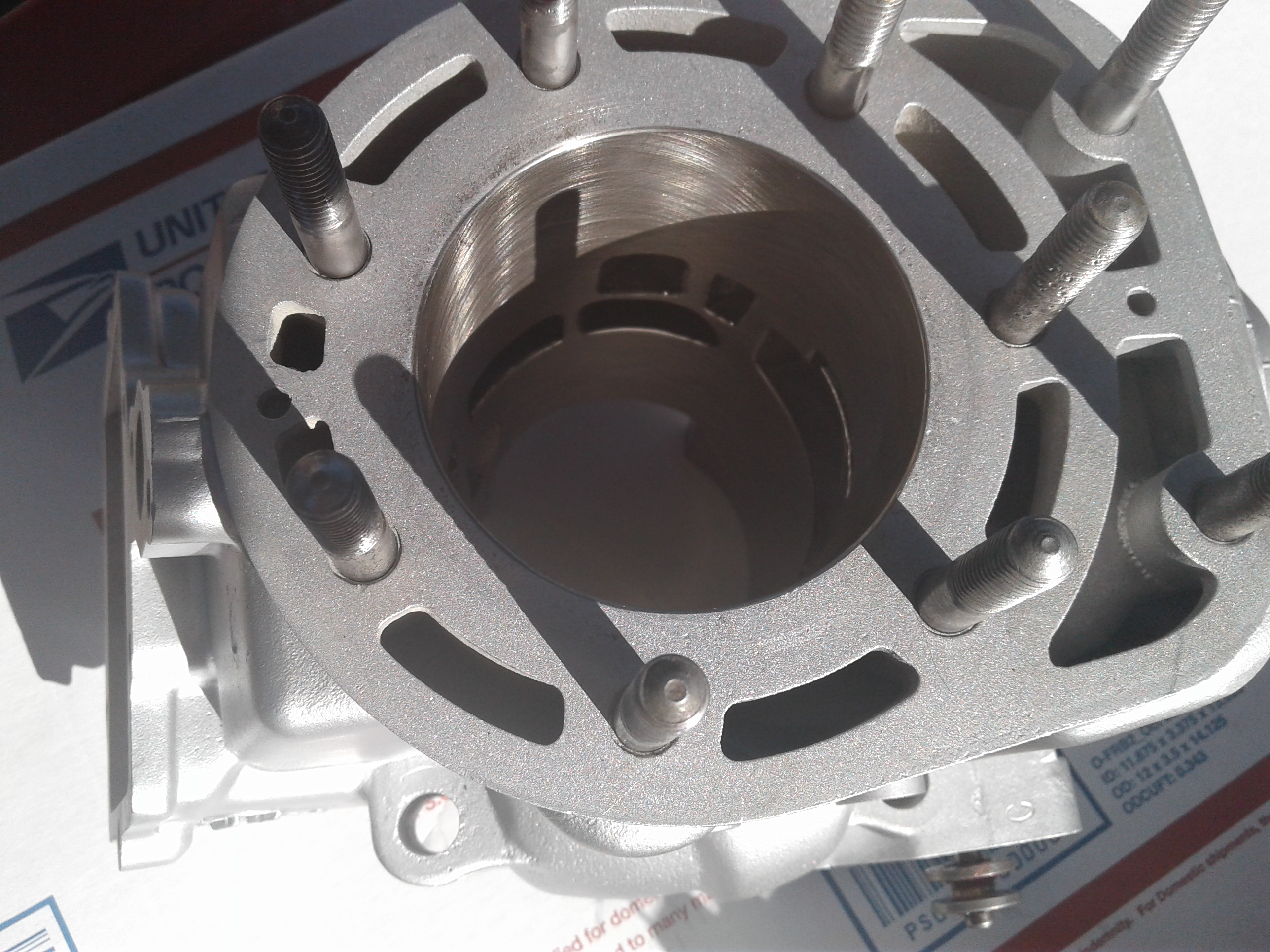

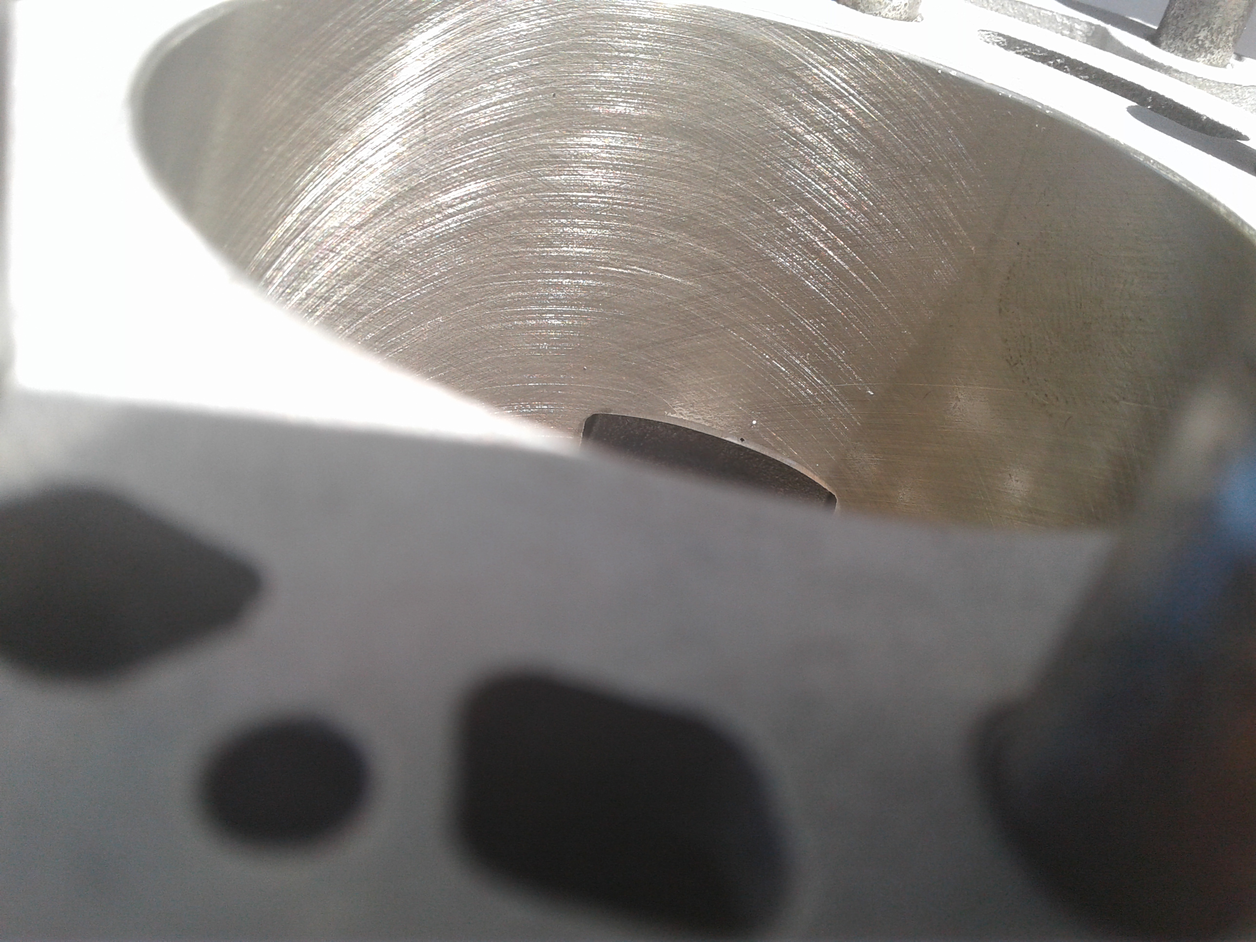

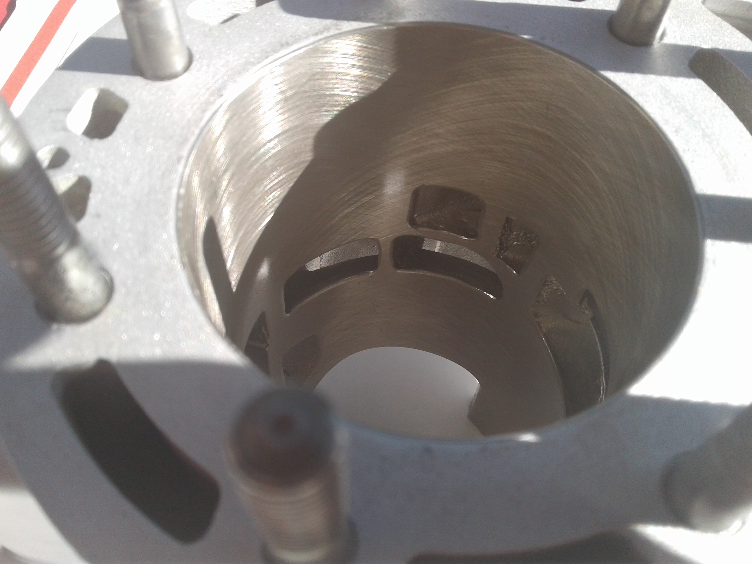

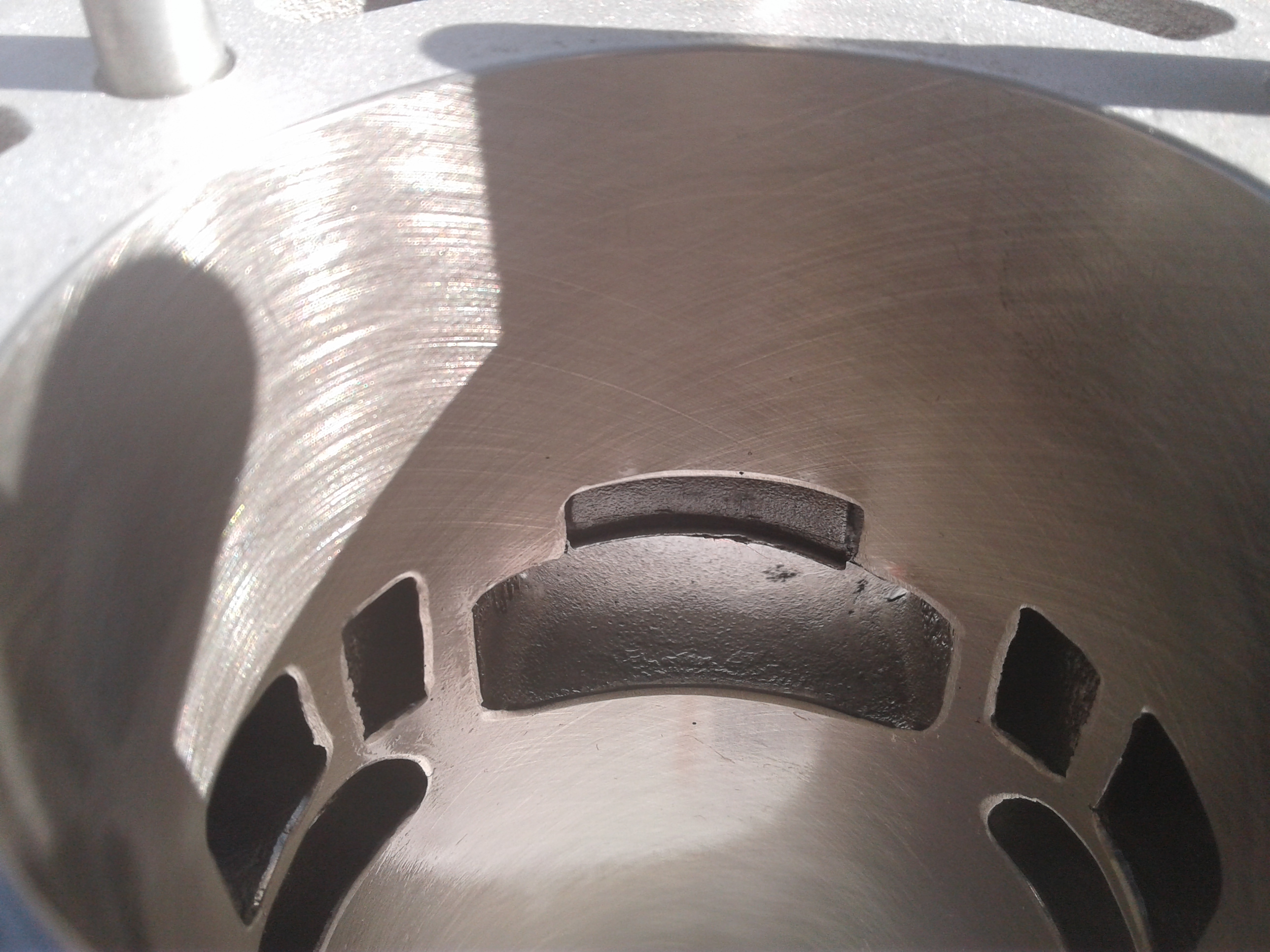

Hard to show the beauty and smiles this brings. Take a look at the first pictures of the porosity in comparison to how it looks now. Wowza!
Amazing!
There is a bunch of oil smeared on it also
Amazing!
