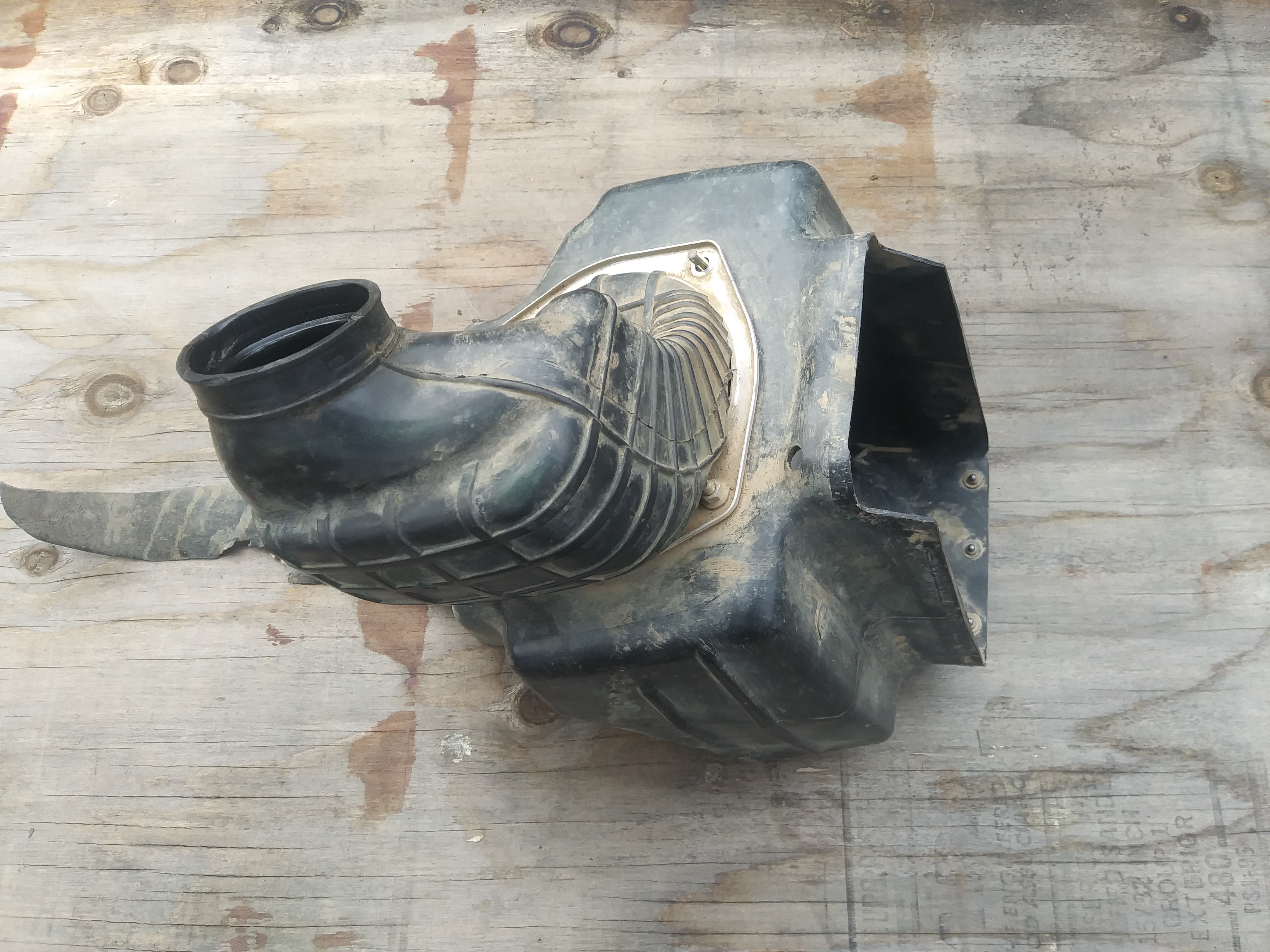

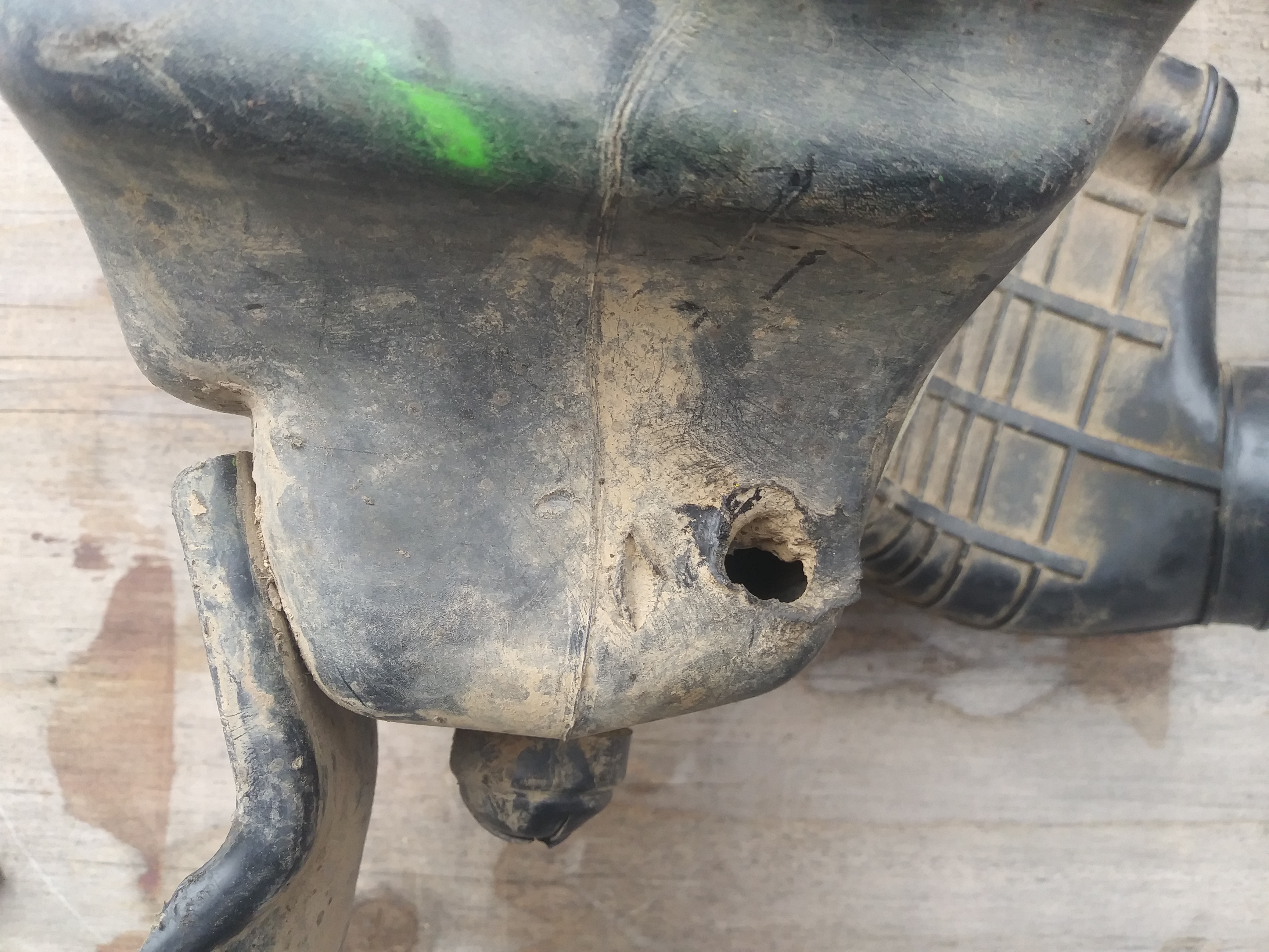

Airbox... Notice the awesome High flow upgrade, simply stab your biggest red hot drill bit into the side of the airbox and wiggle it around until you have the desired high flow hole size. :butthead:

Inside the boot, AFTER the filter.
Healthy sand and dirt, so your bike can get the minerals and micro-nutrients that it needs! :shh:

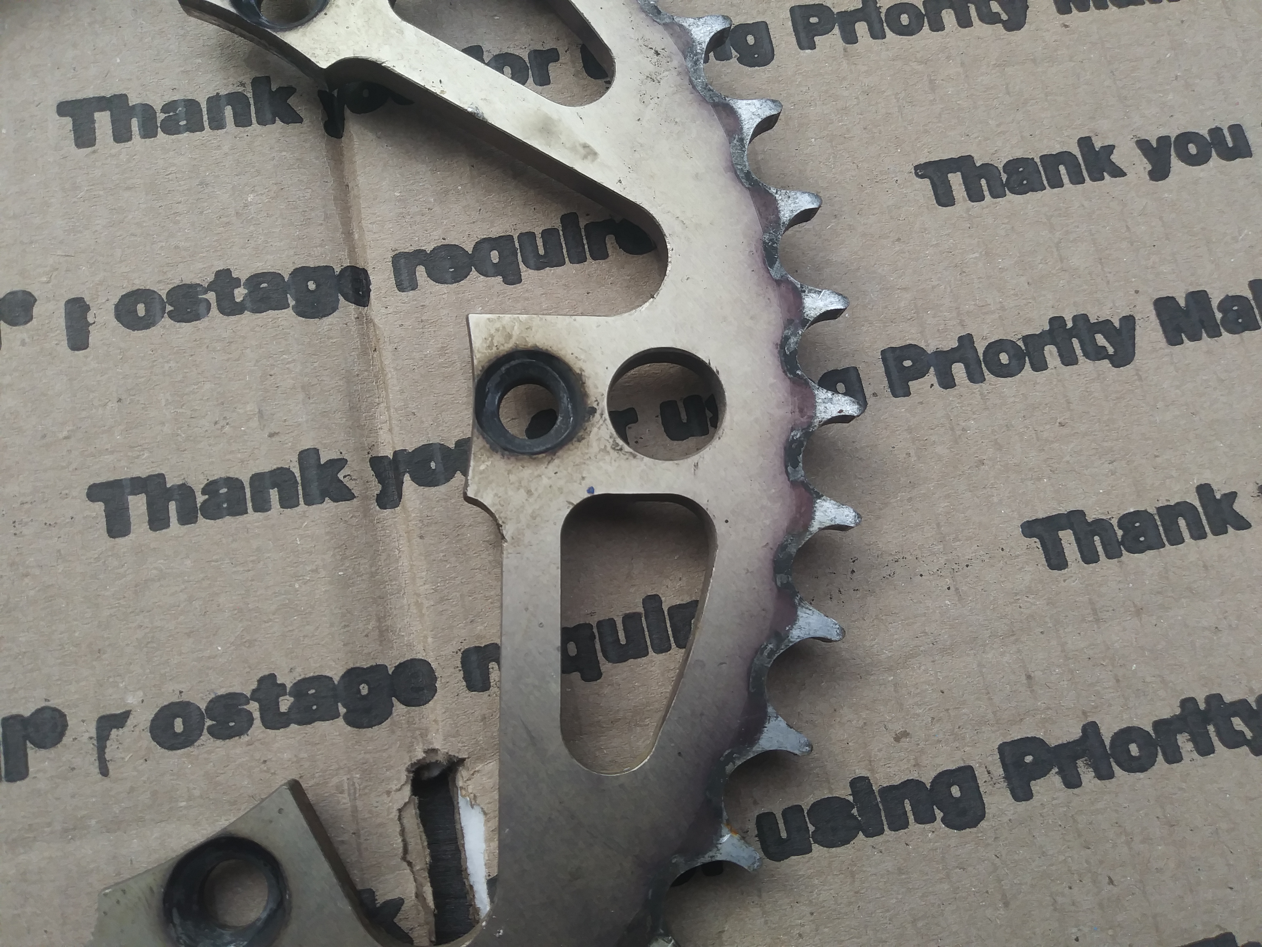

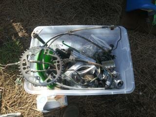

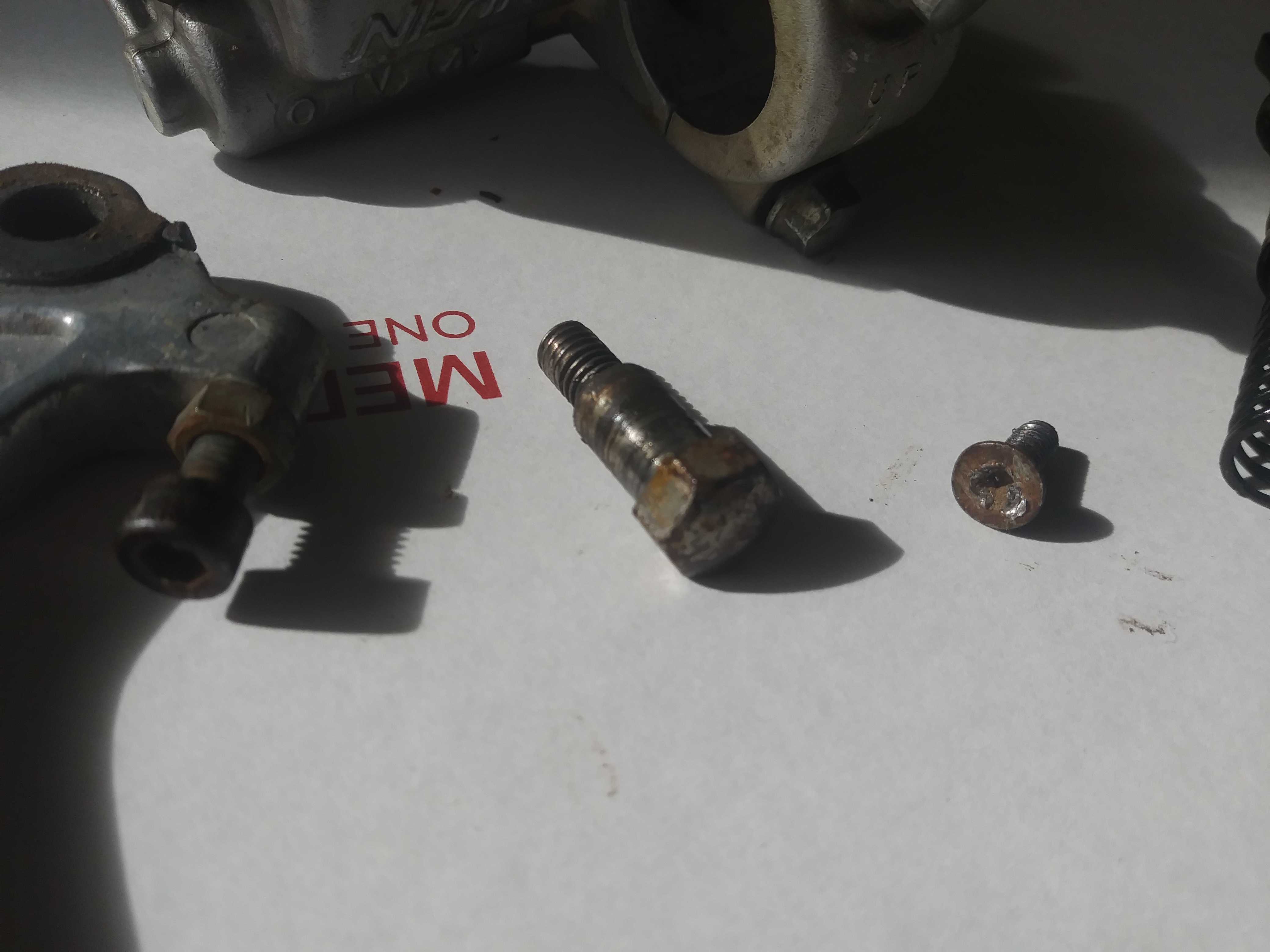

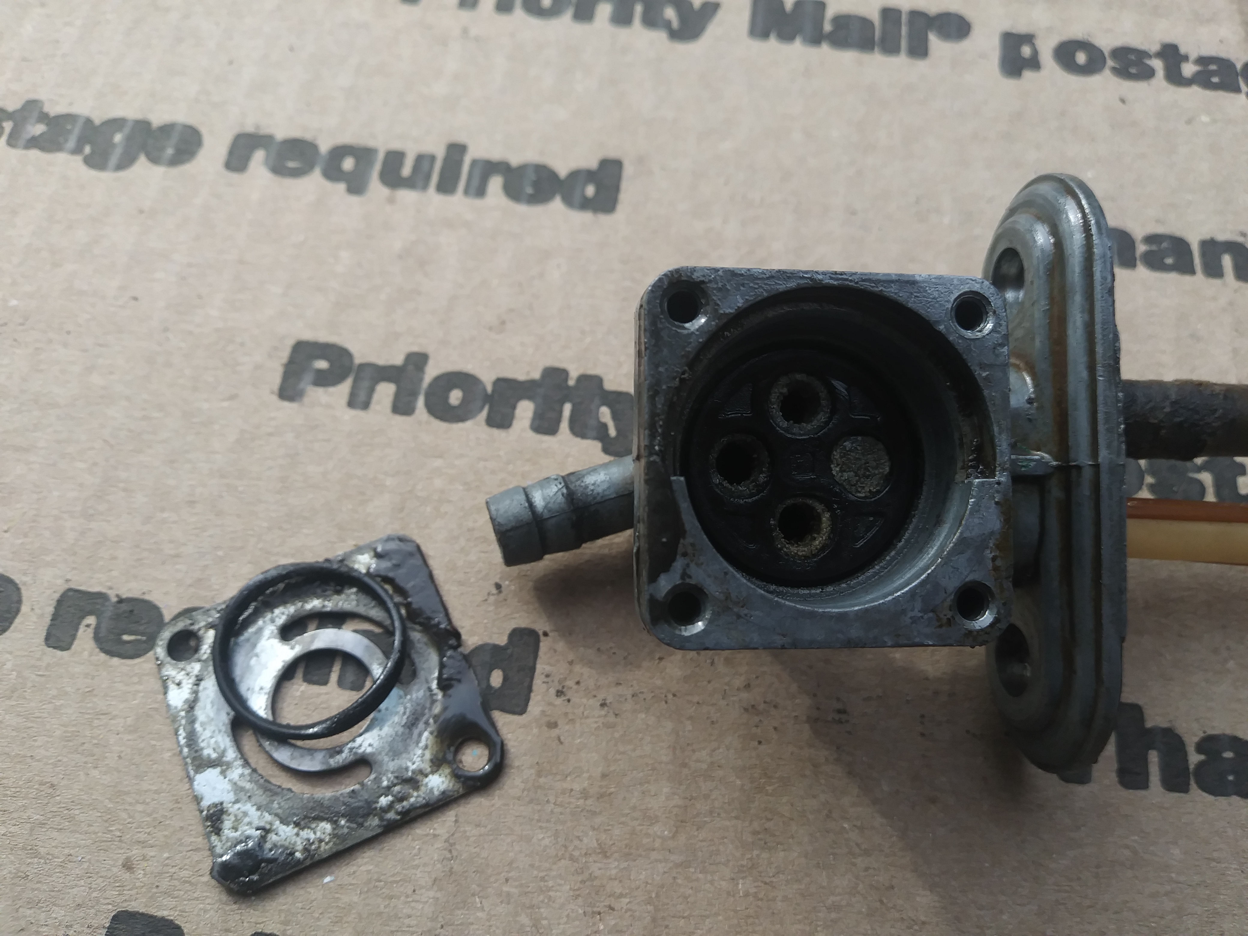

Some other worn parts, stuff to look for if you guys are looking at bikes.
obviously worn sprockets & chain, i could bend the chain into a rainbow sideways.....
broken swing arm rubber - probably means there is some bite on the swing-arm from the chain
fuel petcock - hard to turn, gritty - probably means had bad fuel or dirty fuel in it, looks best to replace the whole unit they are cheap

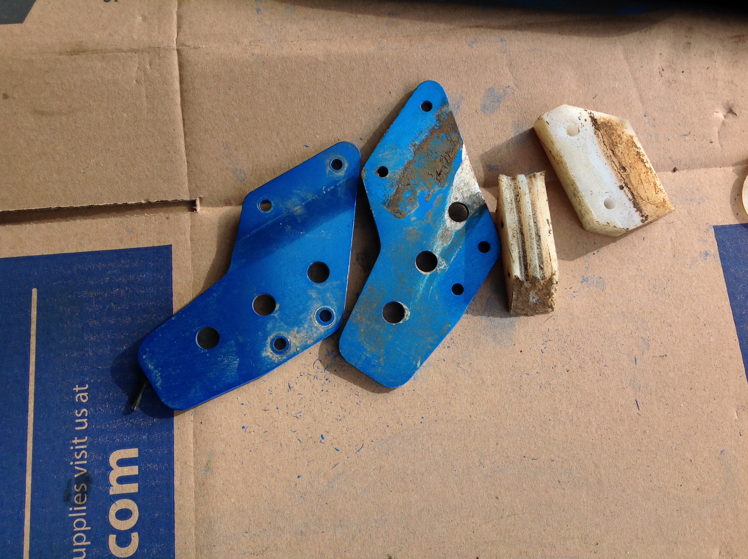

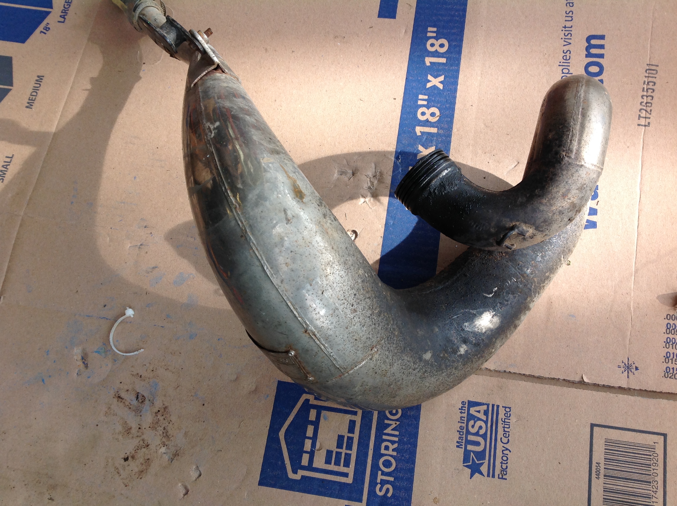

You can also look at the chain guides to see how worn they are, can give you an idea of how well it was maintained, if they payed attention to chain tension.

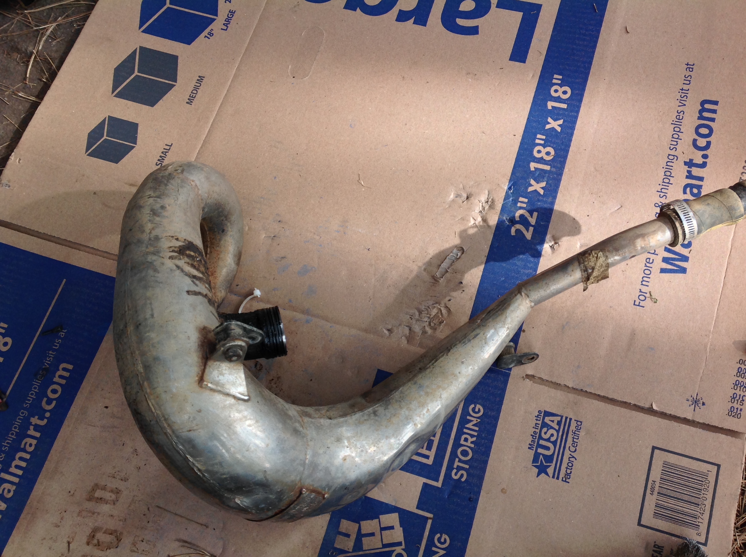

Looks like it has a somewhat original PC pipe, it is stamped with "KDX 250 '94" on it, so not original to bike, but from that era, pretty cool.
I read pipe dents can hinder performance, and if it has a dull sound when you tap it, its probably full of carbon and needs to be burned out.

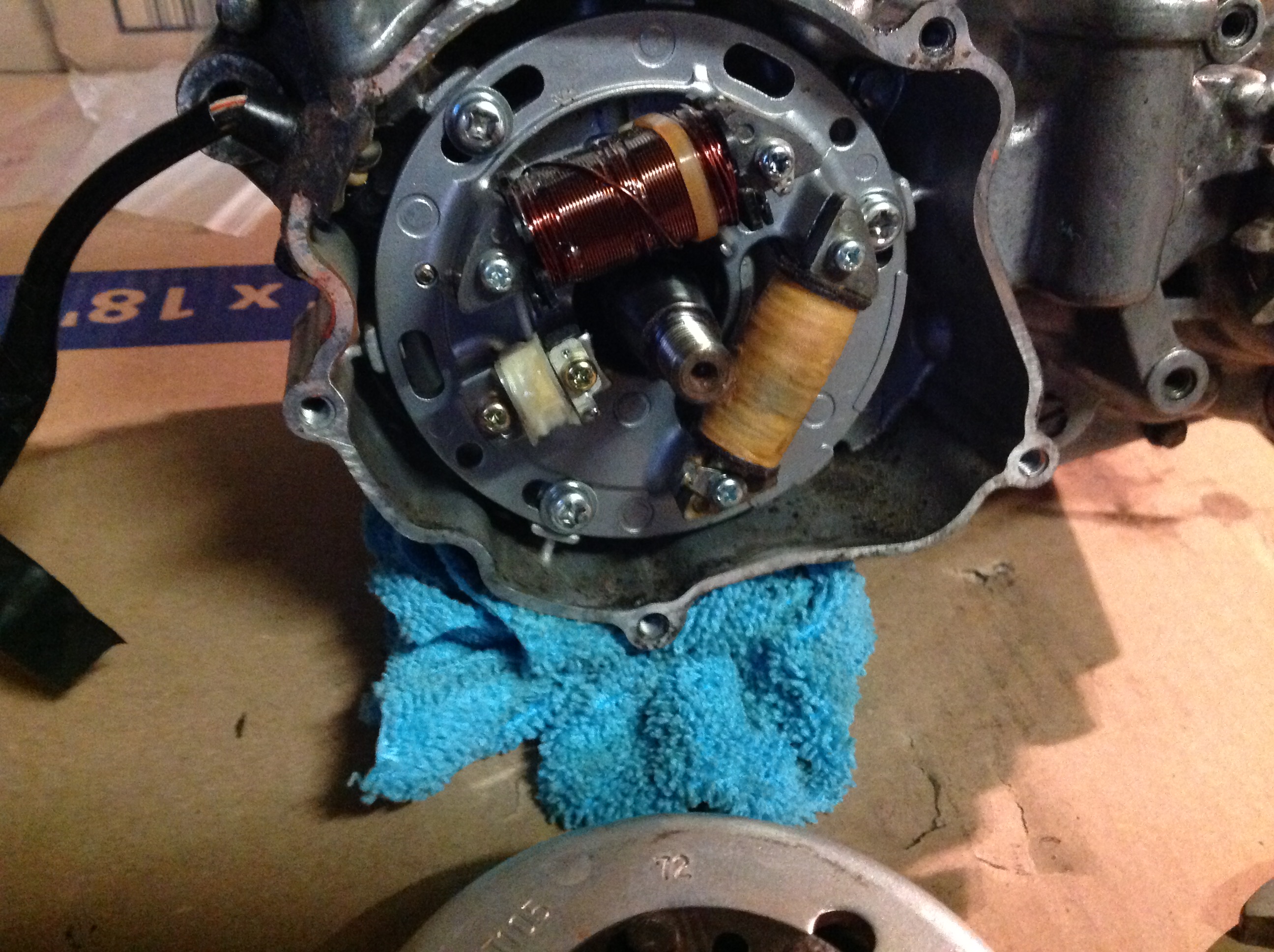

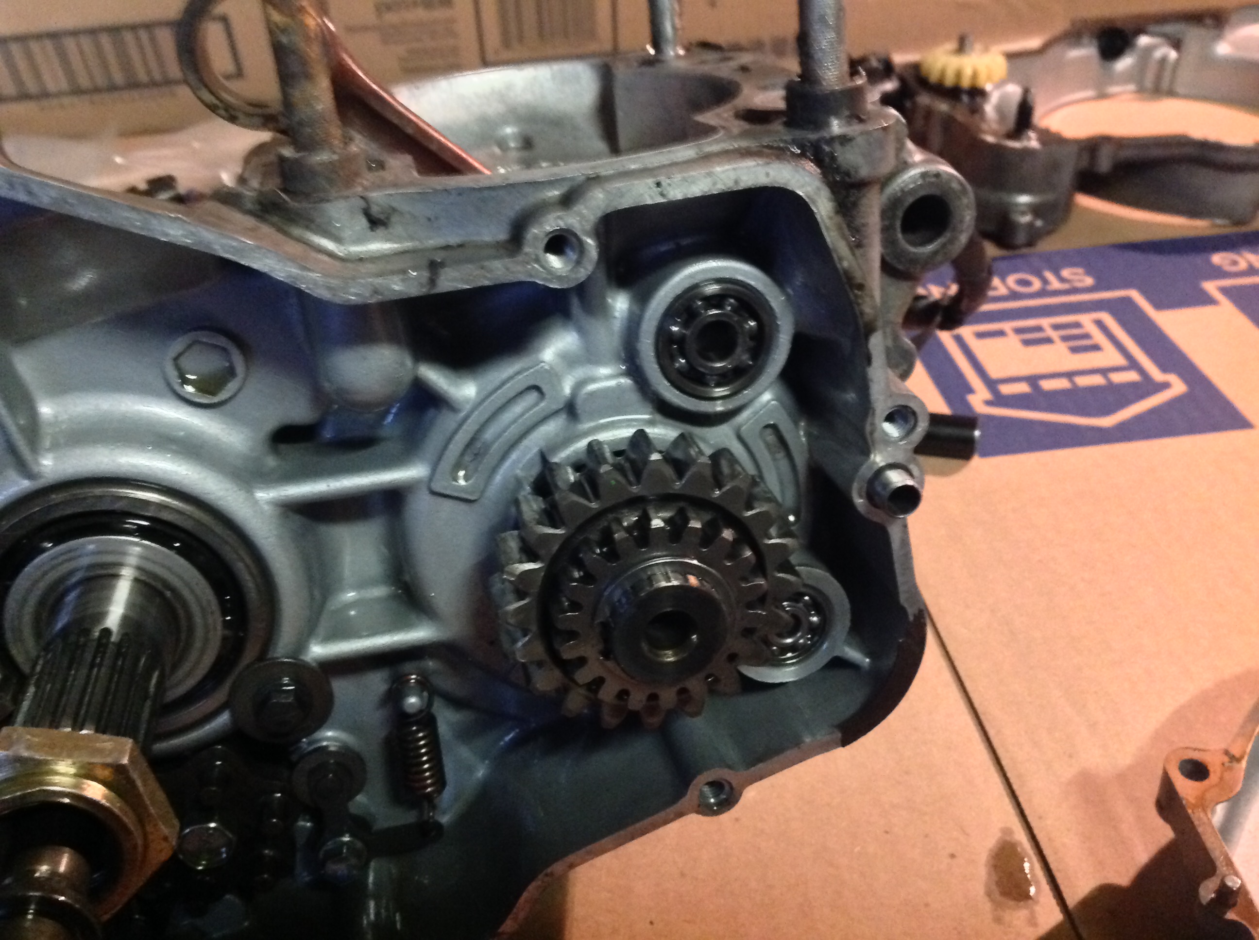

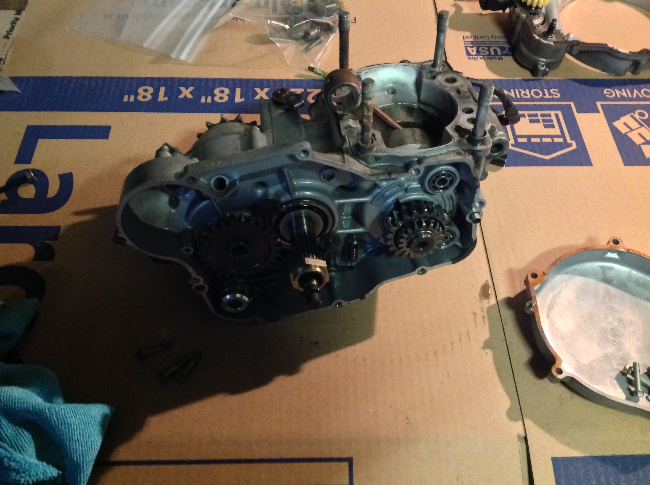

Bottom end time...
Actually looked a lot better then I anticipated...... nice and clean, no rust on the bearings
'91 KDX 250 D1

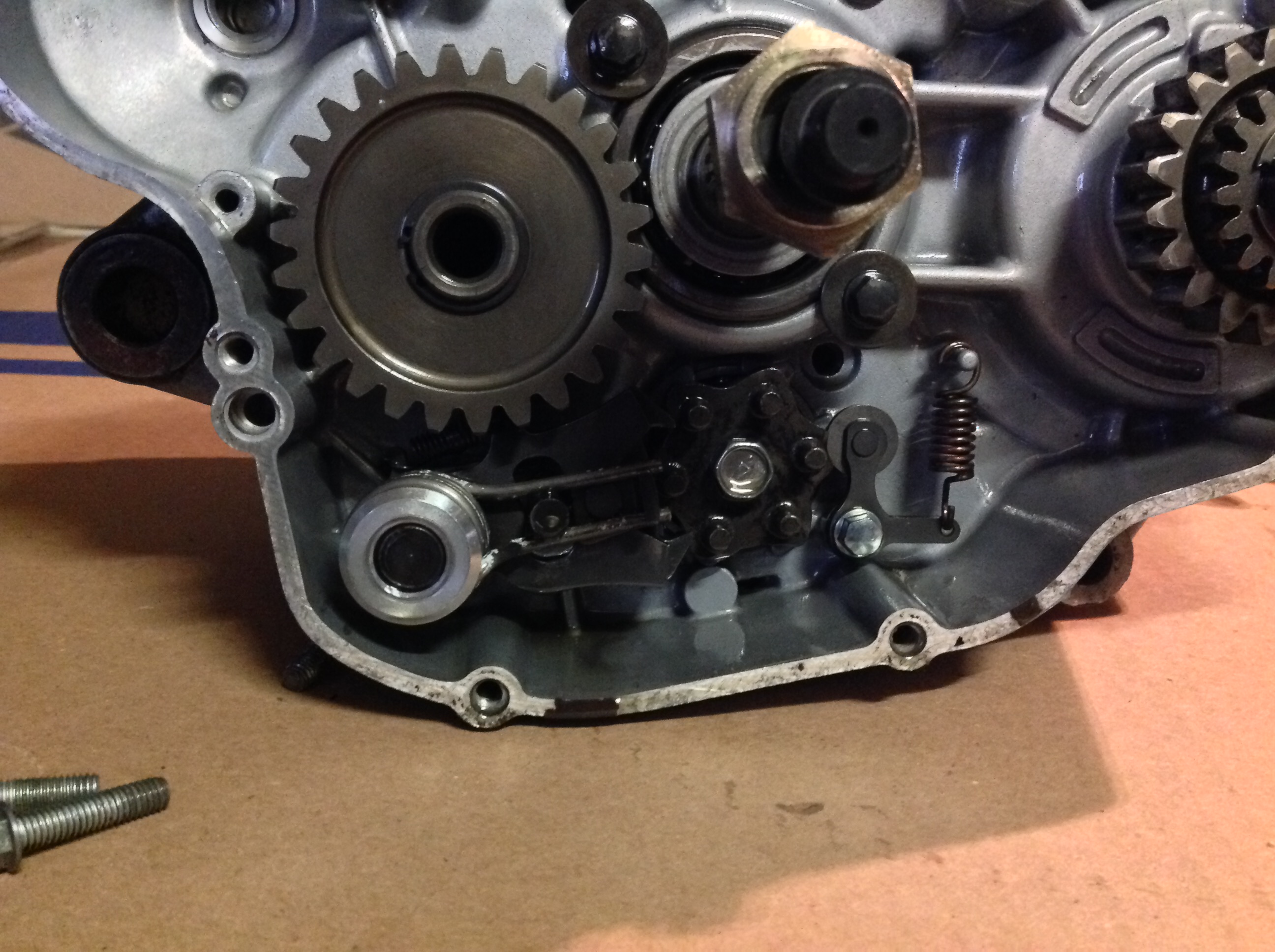

Post by PacificNWRider »

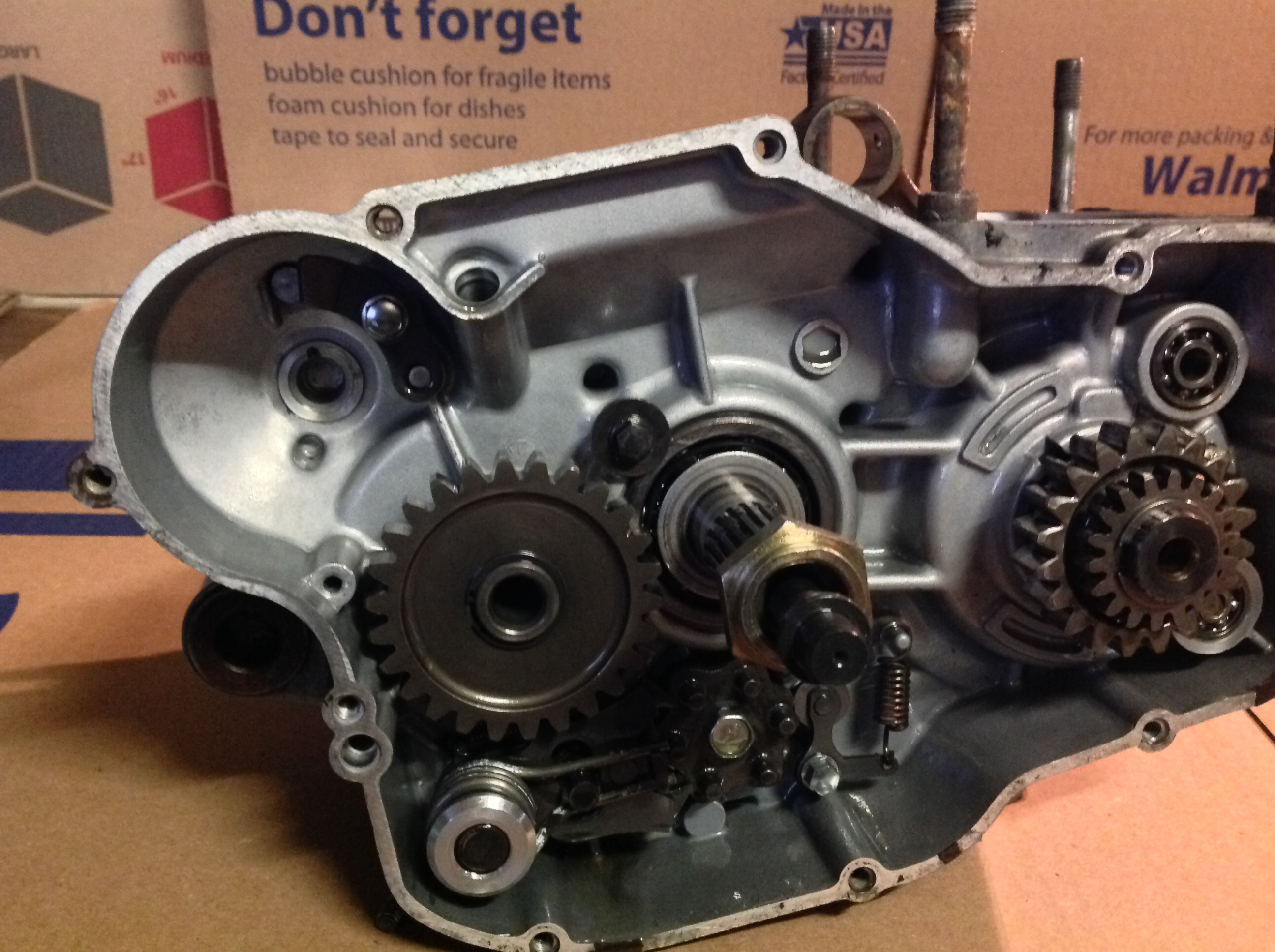

not bad...
'91 KDX 250 D1

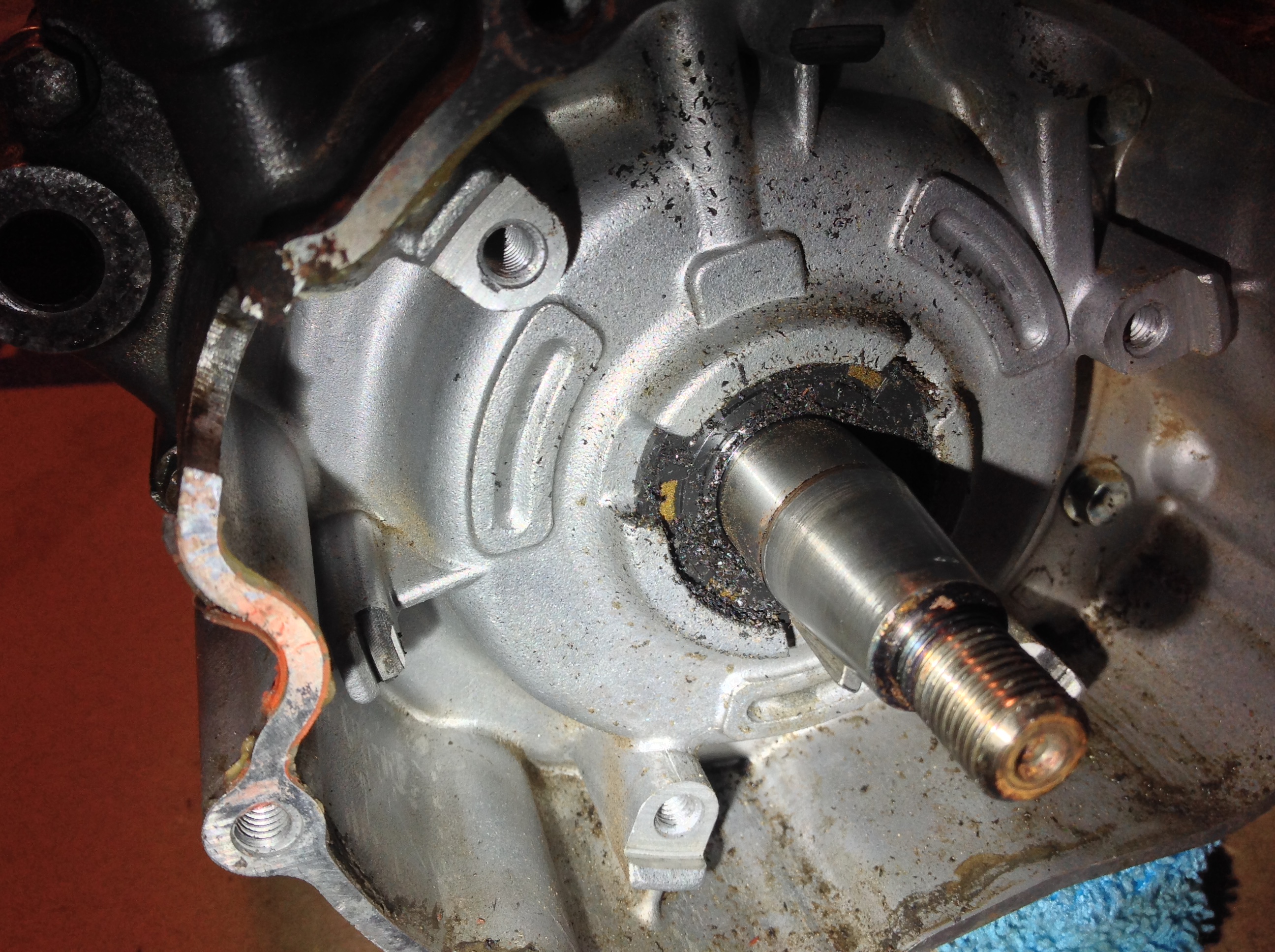

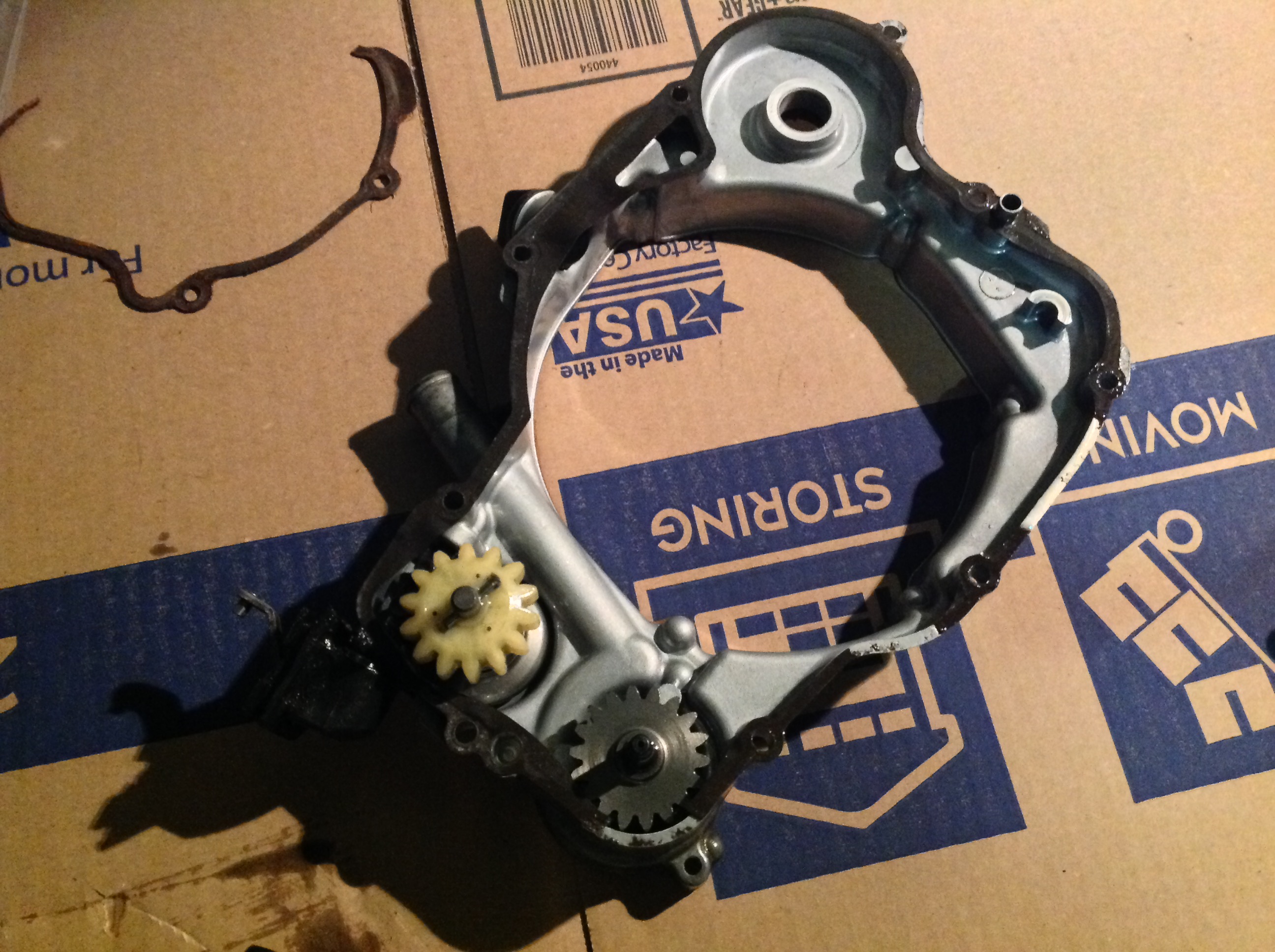

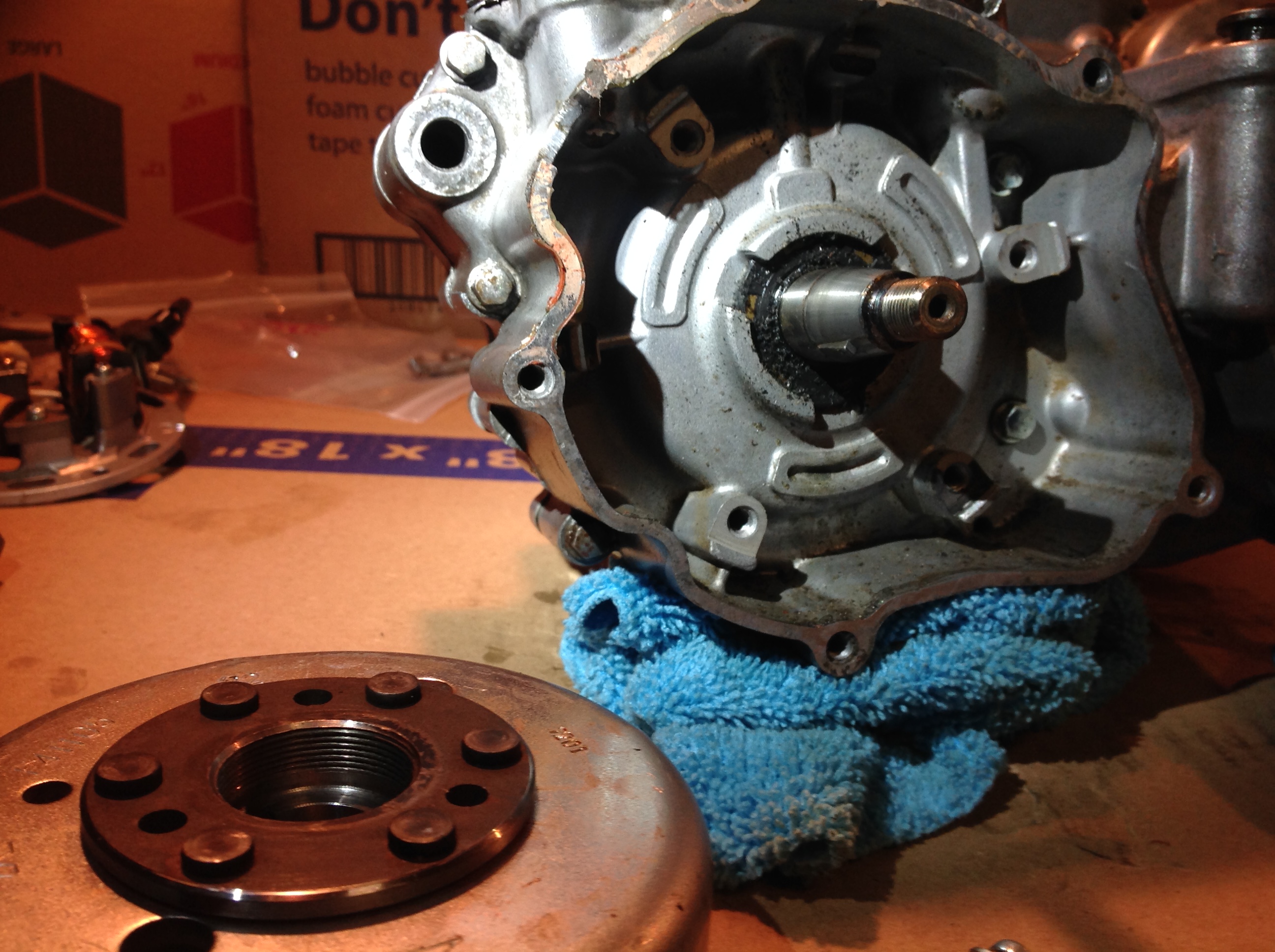

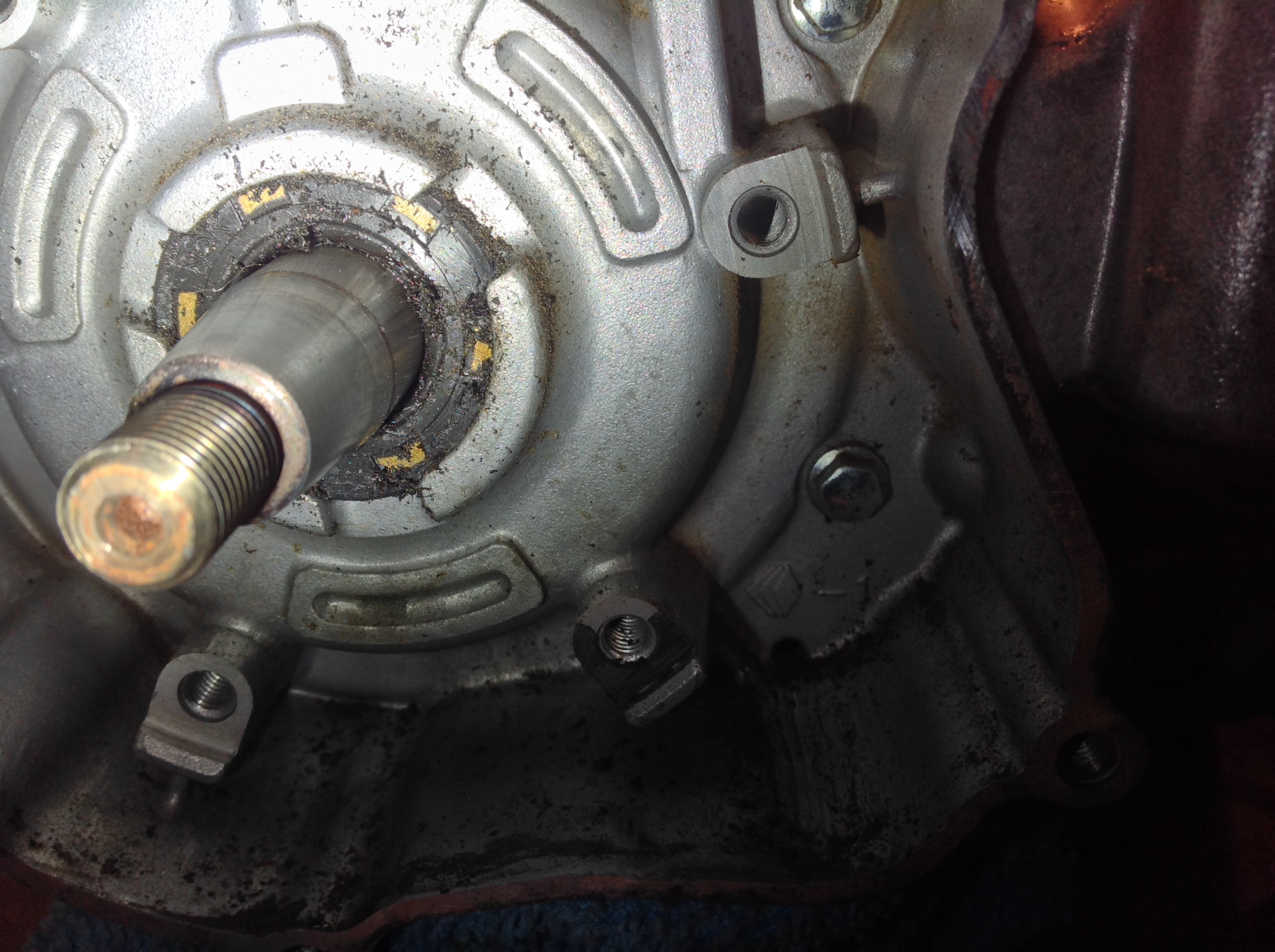

You can clearly see what looks like to be that leftover RTV that I mentioned earlier that was gooped everywhere. Shredded around seal?
must have been smeared around the seal because of the awkward way you press these in backwards??
Look at that MESS. wonder what the other side looked look INSIDE... How does this even happen? Seal spinning? so much rtv it gooed out of the seal on the shaft and then got spun out? wow...
