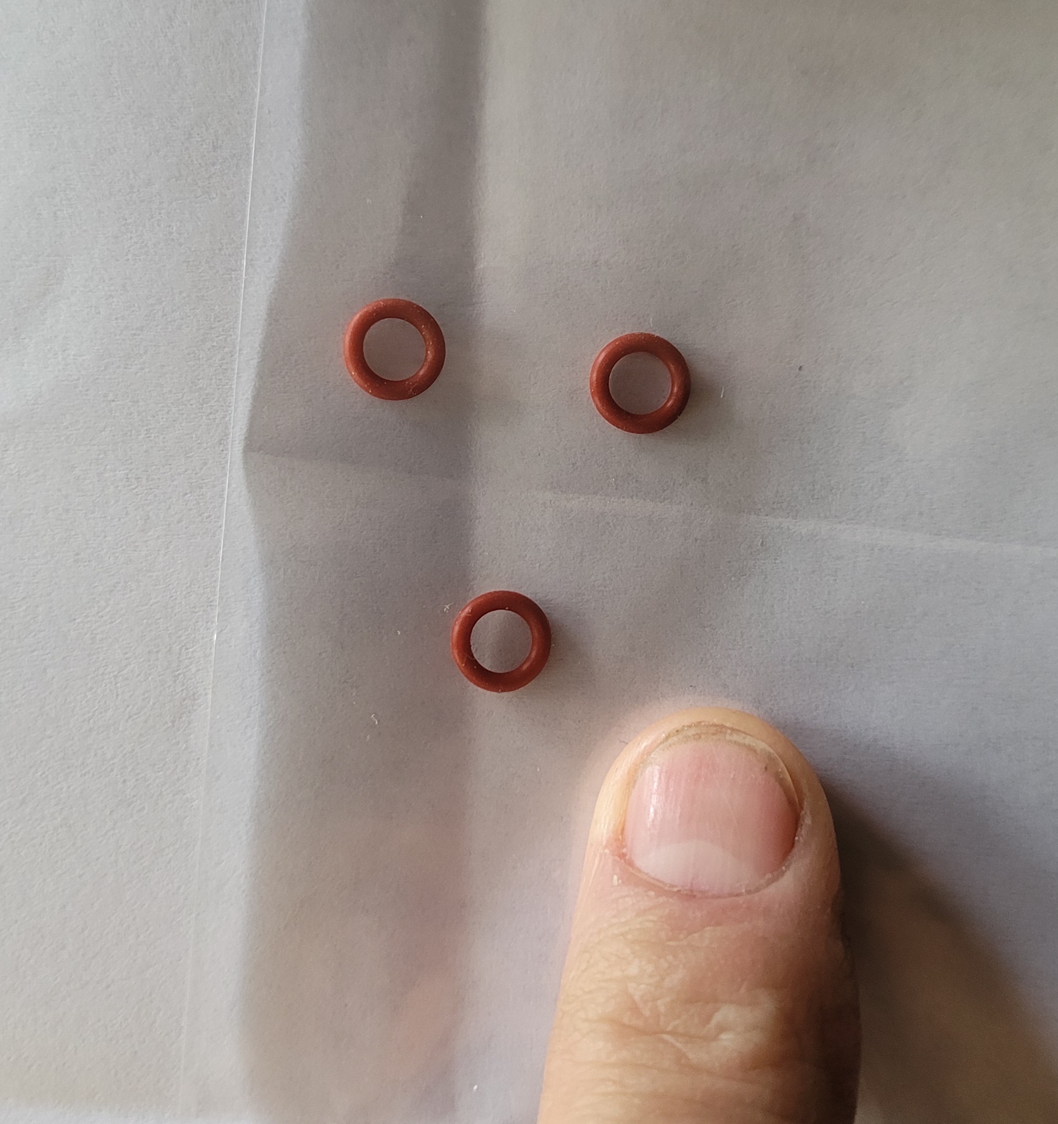

All,
here are the dimensions and photo of the silicone "Fredette O-rings."
Commercial vendors indicate the maximum temperature for silicone o-rings is 205C (400F). Even though Jeff Fredette told me on the phone that these o-rings have worked well for him, I may install a higher temp material if I go with o-rings.
Cross section (CS): 1.6mm
Inner diameter (ID): 5mm, maybe 4.7mm
Outer diameter (OD): 8mm, maybe 8.2mm

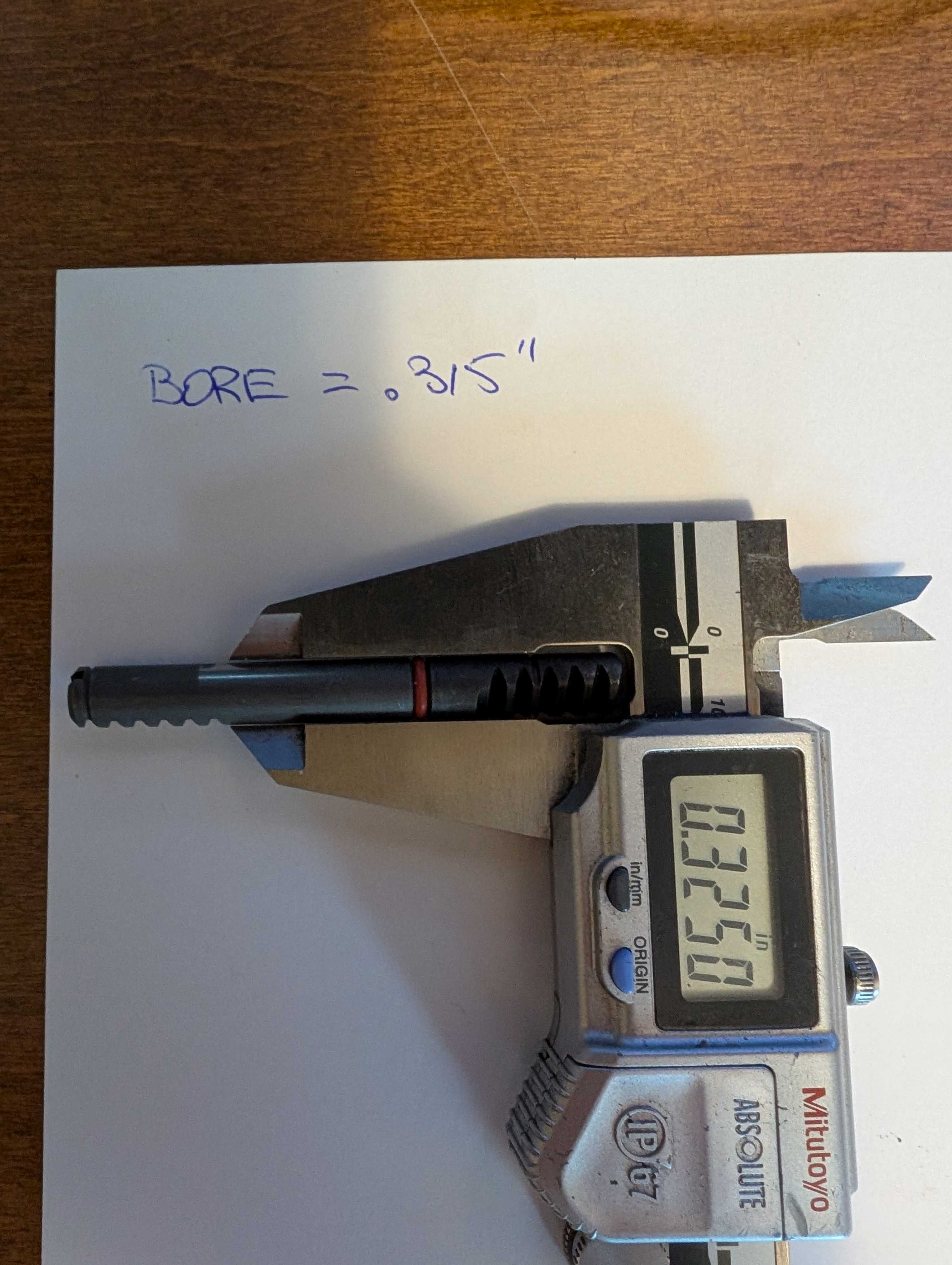

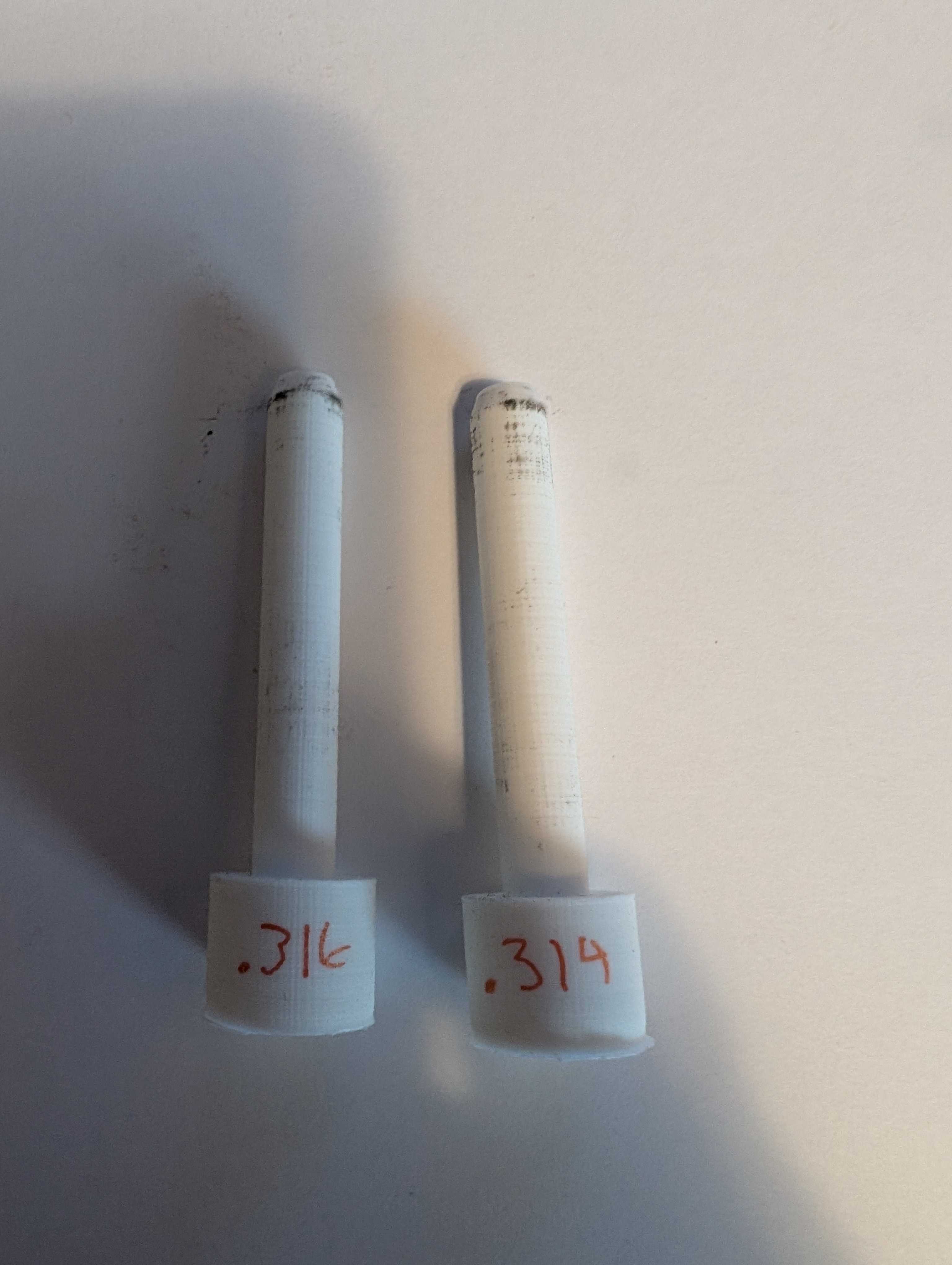

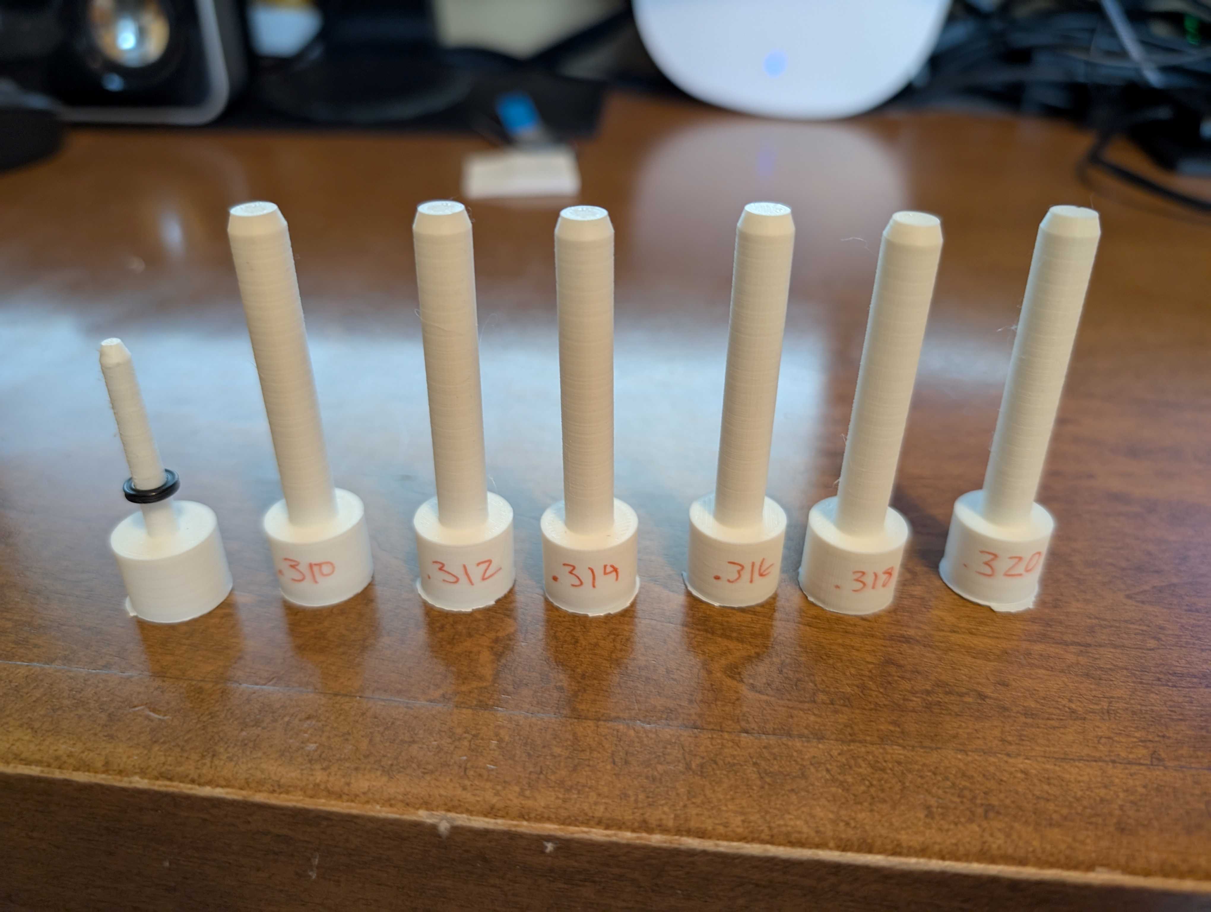

Ok, so some fun updates!
First I'd like to thank billie for shipping me the sample, it showed up today in the great white north! Post card and Freddette sticker and everything! :) Very much appreciated. That's what these communities are about. So first thing, these orings above from Fredette should work just fine. Assembled it measures .325" OD. So on the high end of what I suggested in my above post, but should work fine and I'd never aruge with the likes of Jeff Fredette.
Now I wanted to know what the actual bore was. So I printed some homemade pin gauges. On my cylinder I'd say they come in at .315".......... my .314 would go in, but no way .316 was going, so I'll call it .315"
If you go to the above post you'll note that my original measurements with the factory packing on was .317" OD. So that's only .002" squeeze. Which sure ain't much. Now seals can "take a set" after a time for sure. But my guess is Kawasaki wanted as low a sliding friction seal as possible, so don't run a bunch of squeeze.
So I also printed out a little stepped tapered shaft that I could load this Xrings on. The idea is to find the exact groove diamter to give me in that .320" to .322" OD of the XRING with the seal installed. My initial numbers show a groove ID of .190" will do that. So that plan is to triple check that by doing a few more prints, then hold my breath while I get some machining done........... will post again once that happens!

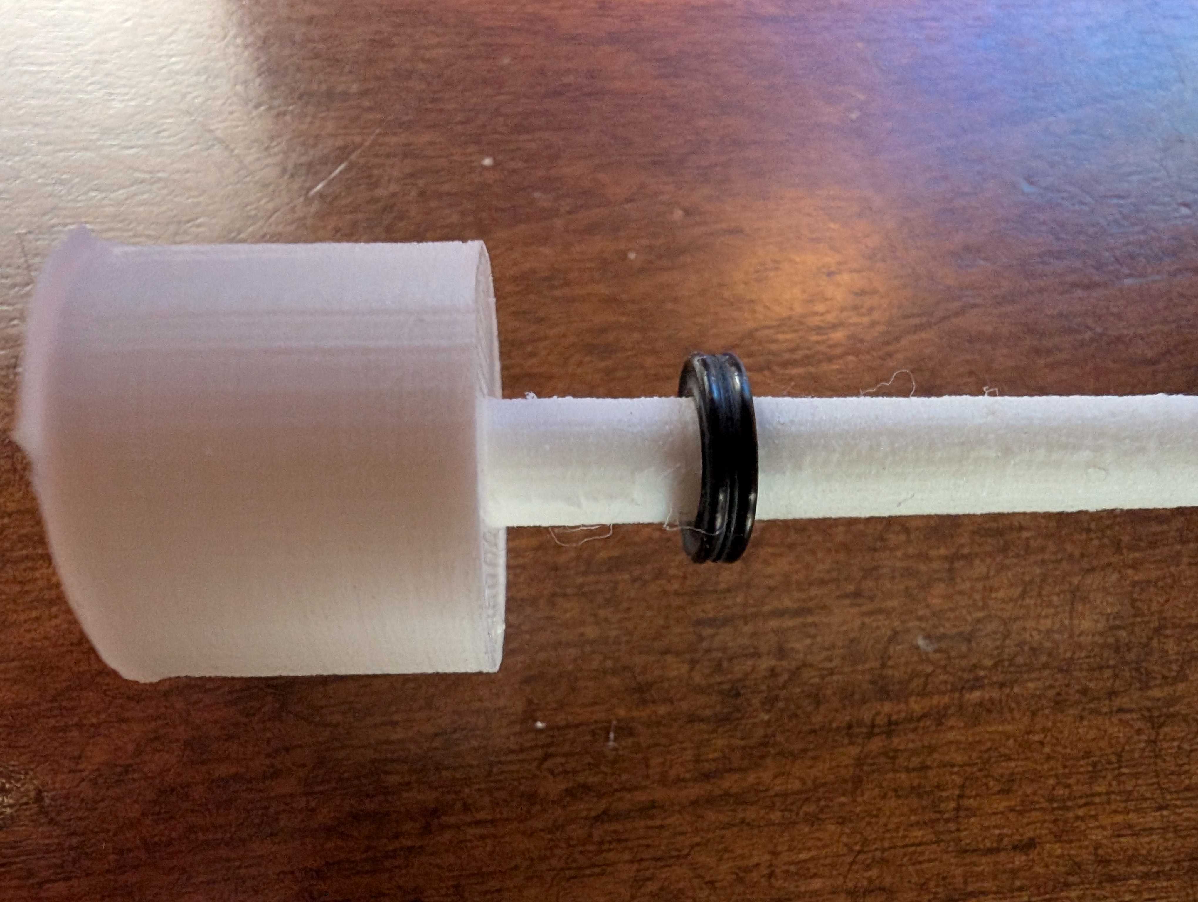

Pic of XRING on test shaft to determine what my groove diameter should be........

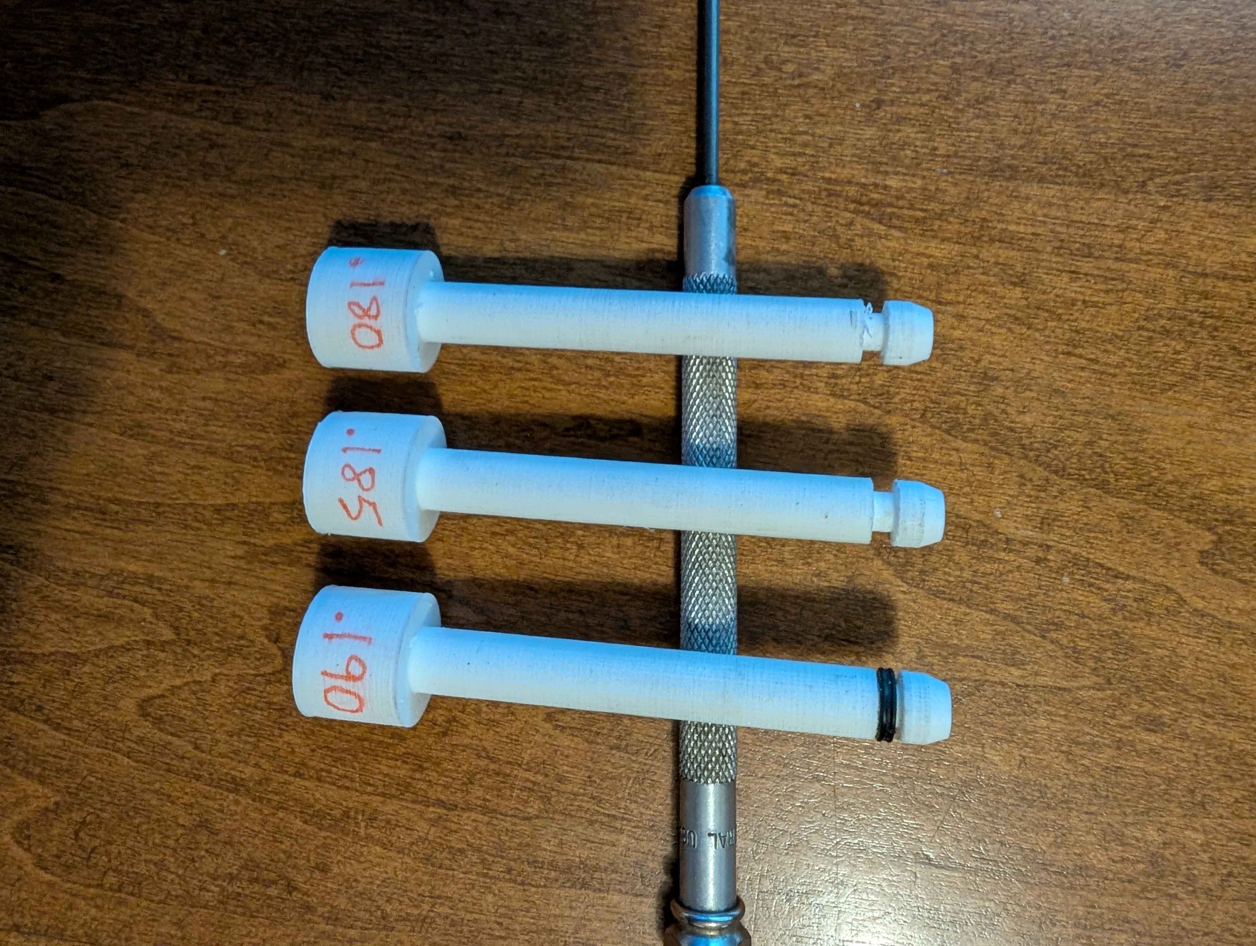

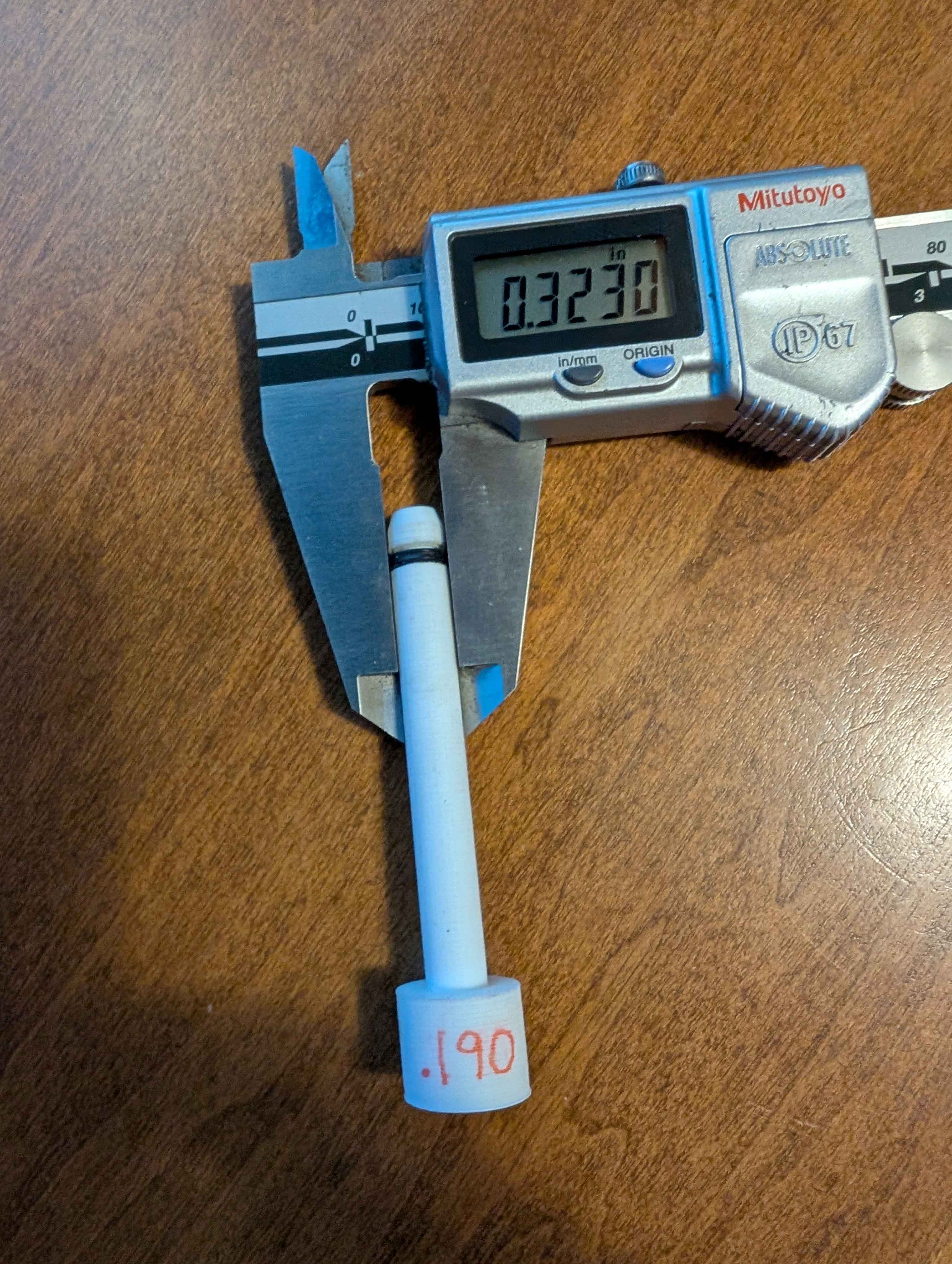

Latest update:
I tried .180 / .185 / .190 seal ID's. The .190 seemed to be tbe best coming in at .323" OD.......
But in all honesty, after running it into the bore with some grease, sure it goes no problem, but I'd like to feel a little less friction. Seems a bit tighter than I'd like. So my .190 will definitely be my max. The .185 comes in at where you'd expect, with a .318" OD. So I'll probably give it a bit of an odd tolerance on the machine drawing of .190 +.000 / -.004 on the shaft........
Will update when next steps are completed!

Re: Kips sub shaft o-ring
Kawi, you are clever!
For kicks, please do a drag "feel" test with the silicon "Fredette" o-ring.
I transmitted an email to the sales contact at Millennium early this week. This email inquiries whether Millenium installs this:
008 X-RING --- McMaster-Carr 6540K118
No answer so far. Chopperpilot expressed interest in asking Millennium what x-ring they installed. Haven't heard whether he did or not. Chopperpilot also offered to disassemble his KIPS to see what he can see with the "Millennium" x-ring. Can this help us / you in any way?
That I can do, kinda curious too........... as for clever, not so sure about that. Maybe "handy" some days according to the wife, but I've done too many stupid things to be accused of being cleverbillie_morini wrote: 06:15 am Mar 20 2025 For kicks, please do a drag "feel" test with the silicon "Fredette" o-ring.
