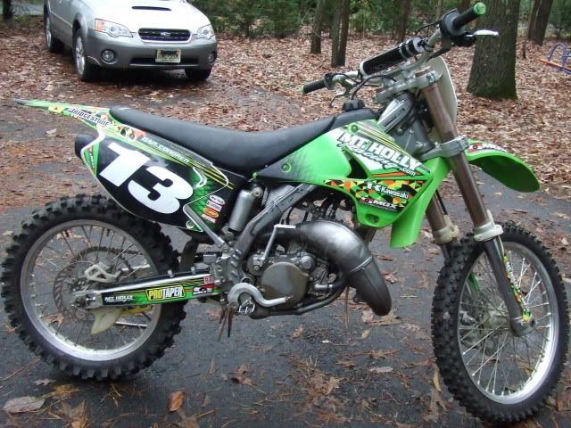

What we have here is a 2003 KX 125 that the owner believed spun a crank bearing on its last ride. It showed up on CL last week, and what do you know, it was literally five minutes from my house. After a couple offers/counter offers, I got it for $880.
I was kind of hoping to get it for closer to $600, but it's complete, so I can hopefully sell the motor for a few bucks. It has lots of compression, it just won't start and makes a few weird noises when kicking. My seven-year-old son is just itching to take the motor apart, so maybe we'll take it apart to see what's wrong with it before I sell it.
The bike's pretty clean. Everything is straight, good-ish tires, the plastic is usable underneath all the stickers, lots of pad on the brakes with firm lever and pedal. Pretty much all good. The only gig I could come up with is there's a lot of stiction in the forks--they don't compress very easily when pusing down on the bars. But that's it. I'm likely going to send the forks and shock out for a woods revalve, anyway.

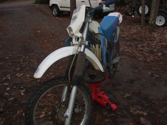

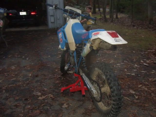

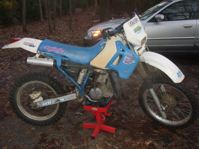

Anyhoo, here's the second half of the upcoming frankenbike.
You ever feel like a thief?
I did, after I grabbed this 1990 KDX 200, mostly complete, for $380. I wasn't sure what I would find when I drove to look at it, but it was pretty much all there (minus side panels, kickstand, odo, headlight bulb/socket and miscelaneous fasteners). It was advertised as a runner needing a top end, so I tried to start it in the guy's yard. Long story short, I have so far kicked this bike a total of eight times, and it has started EVERY TIME. It runs up through the gears just fine, the clutch feels good, finds neutral easily, idles great. I really haven't ridden many KDXs, but it felt like it had great low-to-mid. I didn't run it to the top end (destroyed driveline, hundred-year-old, dry-rotted back knobby, loose head bearings, and I didn't want to terrorize the neighborhood too much). But I think I got a seriously good deal on this. Almost makes me sorry to steal its motor. Almost!

I've done a bit of disassembly to get the motor out of the Kdx, and I found a couple of things. First, the bike has been running without an air filter for who knows how long. The airbox had its lid, and the filter cage was dutifully fastened in place, but no filter. No wonder the kid said it needed a top end!
Next, I found the tranny drain plug threads are stripped. The plug was held in mainly with RTV. Hmm... Helicoil?
Third, I was a little dismayed at how much play the new-looking countershaft sprocket had on the trans output shaft. Plus, I could see a bit of wear on the shaft, too. I noticed in the forums that lots of folks have lots of play in the countershaft sprocket and there doesn't seem to be much concern about it. Should I be concerned?
These things are adding up to what looks like a complete rebuild. I was sort of hoping to not split the cases, but with the history of filterless running, I'm not sure how well I trust the bearings in the bottom end. Also, I've never placed a helicoil before--is there any reason to split the cases just for the helicoil, or is that somehing that can be done without splitting the cases? Also also, should I think about replacing the tranny output shaft because of the sprocket play?
