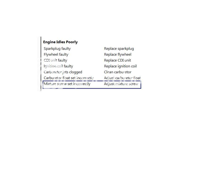

Re: "The mixture screw is NOT the idle screw for the same reason the idle screw is not the mixture screw.... Two different screws."
Kawasaki refer (online manual) to this black nylon mixture screw as an "idle screw" under "Periodic Maintenance - Engine Idle Speed"
And, I am confident many other bike riders also refer to this mixture screw as the idle screw.
Yes Canyncrv - I did know that the black mixture nylon screw is the idle screw...... and I sense another empty 'google' flavoured discussion coming on.... :rolleyes:

There is no mixture screw on a KDX carb. Only idle and air.

..... hence Kawasaki are incorrect.
.... from KDX online manual (Engine troubleshooting) ......
Byte

It is a misprint. Kawasaki didn't write that... Cyclepedia wrote that.
I would tell them.
Do you see any mixture screw? (Click it if you can't read it)
