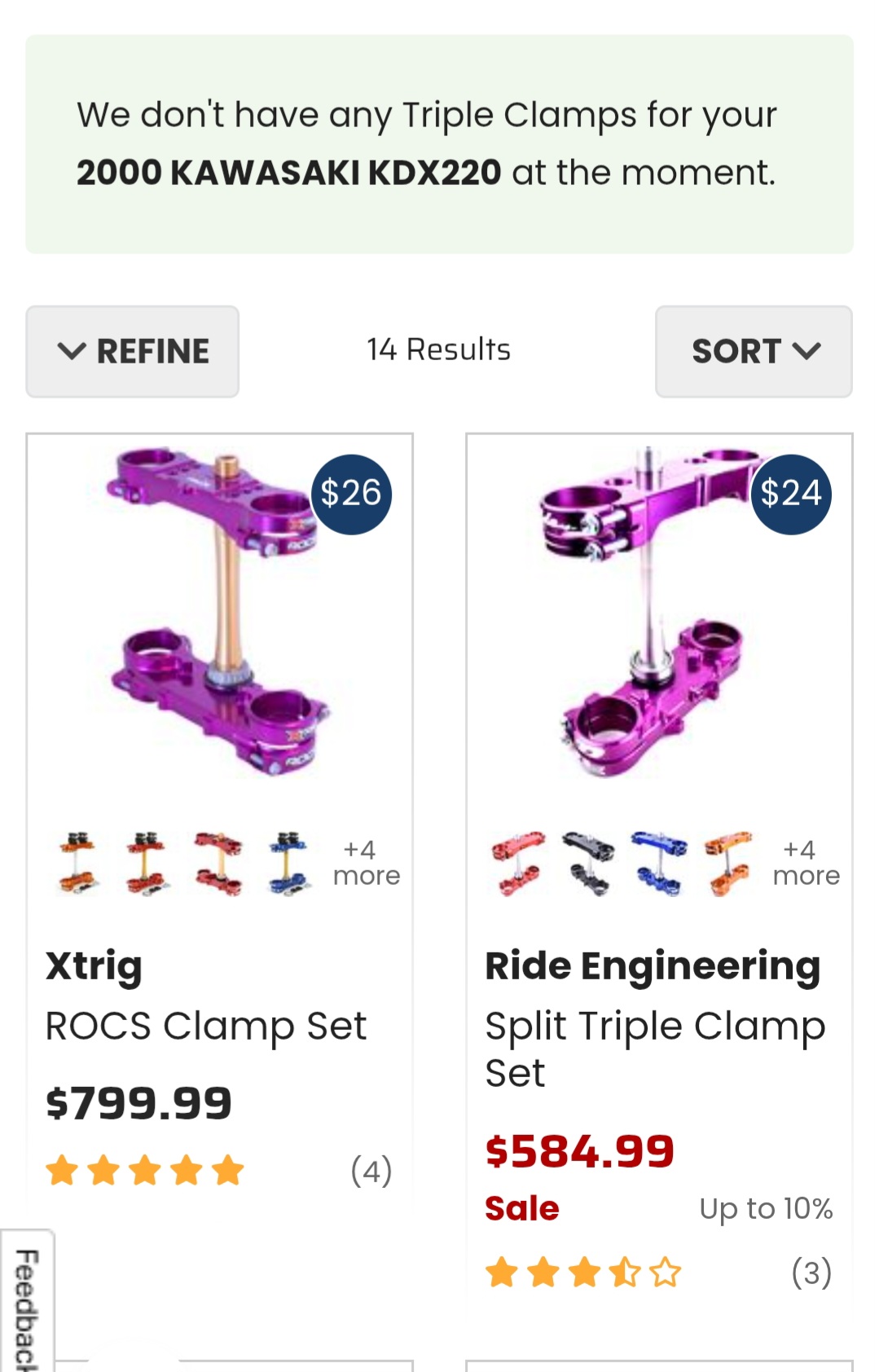

The vendor hyperlinked below is selling anodized purple triple clamps. They offer no clamps for the KDX at present. But, you can have this done by a coating service or DIY.
https://www.motosport.com/dirtbike/trip ... 7422208li1
PURPLE Triple Clamps (Not KDX)

- Screenshot_20260220_083209_Chrome.jpg (237.39 KiB) Viewed 1575 times

I've been eyeing up some used CRF450 RideEngineering triples to go from 23mm offset 2019+ KX450 offset up to an 8mm shorter (proper height for KDX & '02 & earlier KX frames), to 23.5mm offset as well as saving almost half a pound apparently over the stock KX triples...
Both bikes use the same family of 49mm Showa Twin Chamber forks, and clamping diameters are virtually identical.
I have held off because they used KX triples are $150 & the used Ride Engineering triples are $350-400+... BUT... Billie, your purple anodized post has me thinking I need to work harder to get more money out of this house sale so I can build a $6800+ KDX/KX hybrid worth $4700 resale, so that I can smash it up and crash it and tumble it down steep hill climbs and devalue it severely in 5 years time!!!!!

The Xtrig Rocs triples I avoid due to the upper clamp bolts protruding towards the tank, which could affect clearance on KDX tanks as well as oversized KX tanks. The RideEngineering design is preferred for this area's clearance with both upper bolts forward.

Ahhh... It looks like the Honda are not available in purple, only the Yamaha... Perhaps they'll do a custom request, however? I'll probably stick to a used late model black Ride Engineering set for 23.5mm offset, to cope with my hard enduro tall "fatty cheater" front tire preference, as the 23.5mm offset vs stock late model KX 23mm helps bring the steering trail back to KX125/KDX specifications.
