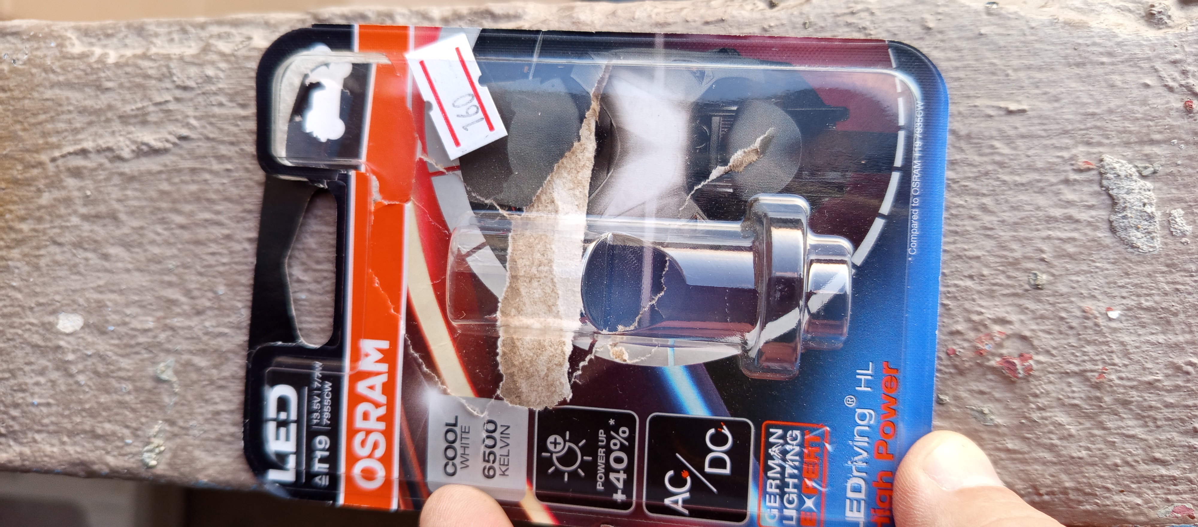

I'm not that knowledgeable when it comes to electrics, I tried installing bridge rectifiers and diodes on my old wr450 just so I could run led indicators and swore I would never do it again, yes this is the SR model which is also identical to the Australian model in terms of electrics, as far as I know it's just AC to all the lights, the higher output would be because there is the constant tail light, then the brake light, then indicators, then individual dash bulbs of which there are manyGOT WOODS? wrote: 11:44 am Dec 24 2025 Thanks for this Daryl!

In regards to flickering I did leave out an important point, most kdx's have a very poor and inconsistent idle due to running too rich,or the airbox lid removed and other factors, it also increases the clutch rattle, my kdx SR is dialed in fantastic with its little Keithen pe28
I threw the packet in the public bin in my condo building, if the cleaning lady hasn't already emptied it I will dig it out and take a photo
I have no idea about ECE regulations, everything in Thailand is it bit more relaxed and my bike has no registration,no insurance and most of the time I don't even wear a helmet lol. So I'm the wrong guy to know about rules

Here is the led bulb
- IMG_20251225_175038.jpg (2.09 MiB) Viewed 35357 times

7 watts at 13v is not a whole lot of lumens output, but drastically better than stock with an incandescent lamp at 25W

The "magic" with this LED bulb is the operational current can be alternating or direct.

I was just talking about this the other day with my father, with how it's common to find 120v LED bulbs that convert to DC internally, talking about house lights, which is obviously necessary in said situation. I was originally discussing the lighting system with him and he was surprised it was an AC system, which got us talking about LED bulbs in the headlight.
This confirms that 12v LED bulbs that convert AC to DC internally exist. I wasn't sure so this was perfect timing.
Thank you for sharing. I might pick one of these up for myself if I can. I'd like to eventually float the ground on my KDX and convert the system to DC, and I definitely will once I get my E start for it, but I am unsure when that is coming. It's almost been 2 months since the original order, so likely a couple more months 'till it is here at least.

This is a high/low beam driving light, I'm sure they can easily make more powerful versions but then that becomes a risk to other vehicles when driving on the road at night, also with increased watts will be increased heat and that runs the risk of melting the headlight plasticChuck78 wrote: 12:22 pm Dec 25 2025 7 watts at 13v is not a whole lot of lumens output, but drastically better than stock with an incandescent lamp at 25W

I tried looking for the bulb online but couldn't find it for sale outside of Malaysia. Kind of odd. For reference, from what I could make out from Darryl's picture of the packaging, it is an Osram 7955CW. If anyone finds a source available to the US please post it up!

I tried searching as well for that Osram brand version T19, or similar from the same company, but no luck at all (in the USA).GOT WOODS? wrote: 12:26 pm Dec 26 2025 I tried looking for the bulb online but couldn't find it for sale outside of Malaysia. Kind of odd. For reference, from what I could make out from Darryl's picture of the packaging, it is an Osram 7955CW. If anyone finds a source available to the US please post it up!
I did see this, Partzilla sells this same Rivco LED pictured under the same name brand, this perhaps is the manufacturer's website. This is an H6M socket style, which is what the KDX OEM lights from 1990 on newer take, that T19 does appear to be the same or compatible base/socket.
This is 2000 lumens / 11 Watts, not a lesser 7 Watts like the Osram, & I don't know if this is advertised as AC/DC. Also, it's $55. The Osram I did find on eBay from Thailand or somewhere else would end up being more than this after tariffs into the USA currently.
https://rivcoproducts.com/shop/atv-utv/ ... lbs-white/
Here's a $15 generic that claims that it's backed with a one-year warranty and from a company that claims to be based out of the USA and stands behind their products. It also states that it works on AC or DC. I bet a lot of these would because there are probably a lot of copy cats of that Osram design.
https://ebay.us/m/mN2G4o
(Edit - this is the same one Bullie has linked below
You should be able to find similar LED lamps labeled as H6M, but I was having some trouble finding any of it quality known name brands.
If you want something about 4 times as bright, look up the Cyclops Adventure Sports LED kit for the Honda XR, it is the H6M bulb they offer, with an optional inline rectifier, as well as an optional on off or high low off switch with kill switch integrated into it. Their version is SIGNIFICANTLY brighter and will be putting the stock KDX stator close to it's maximum output capacity.
https://www.cyclopsadventuresports.com/ ... b-kit.html
It costs drastically more though, but it is well capable of doing night rides with no moonlight deep in the forest.... Very bright headlight. They will draw so much power that you may not want to run a tail light, and if you do, it needs to be an LED of low output. For tail light and brake light and any other usage, you would need to run the aftermarket stator on the KDX with this Cyclops LED headlight. Minimal rewiring is required, but it's very simple. This option just costs significantly more like $144 versus I'm guessing about $20 if that bulb in the video here was available in the USA at least.
