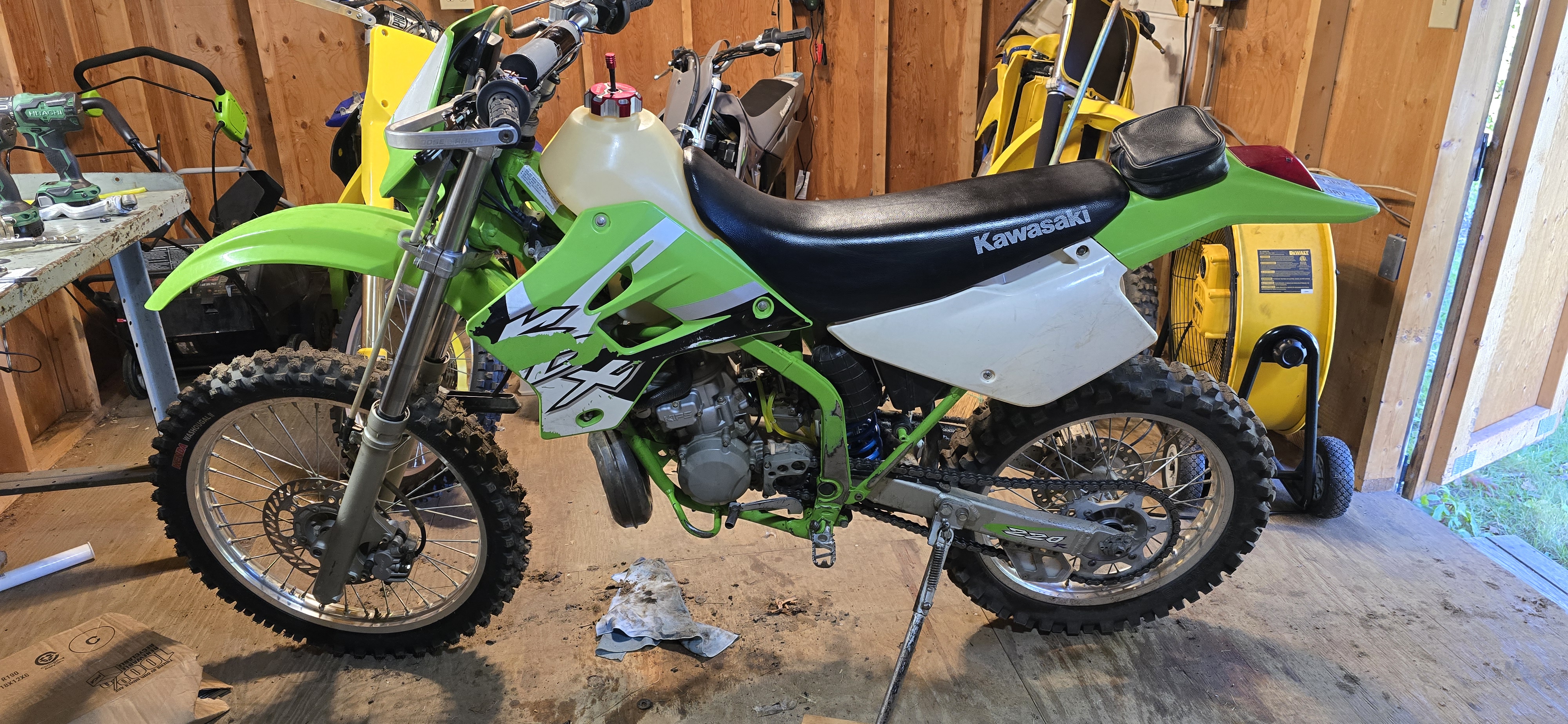

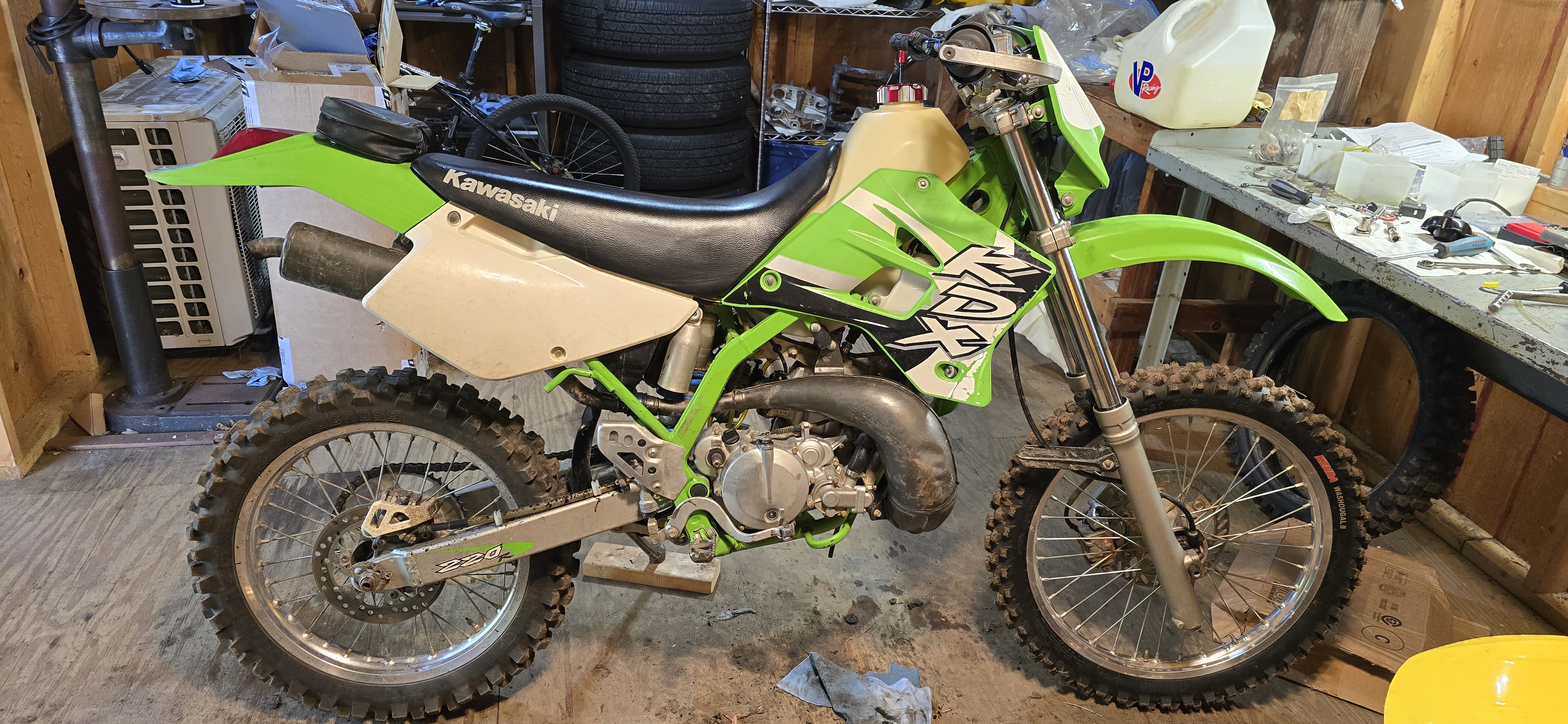

Chuck78 wrote: 10:59 am Nov 05 2025 Welcome! What year and model KDX do you have? Where do you ride? Do you have any photo album links for your bike?
No albums yet, I have videos to edit from my ride this weekend. I typically ride in lower peninsula in Michigan. Here are a couple pics

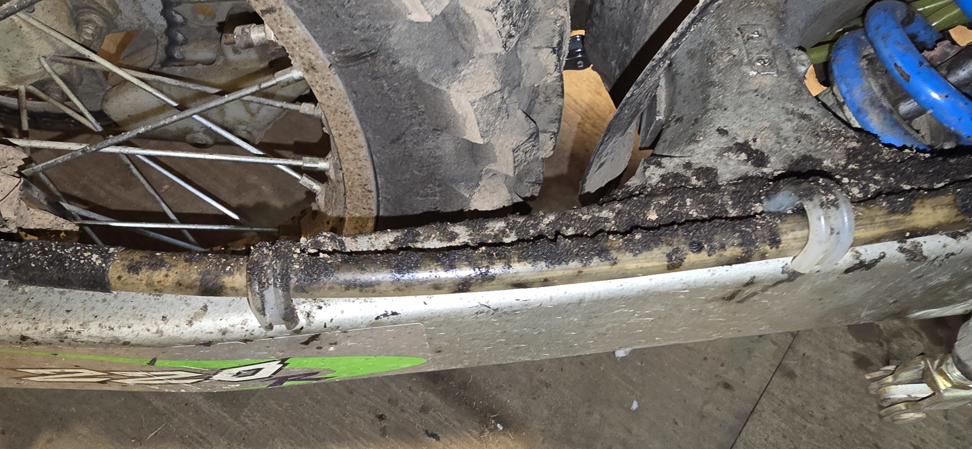

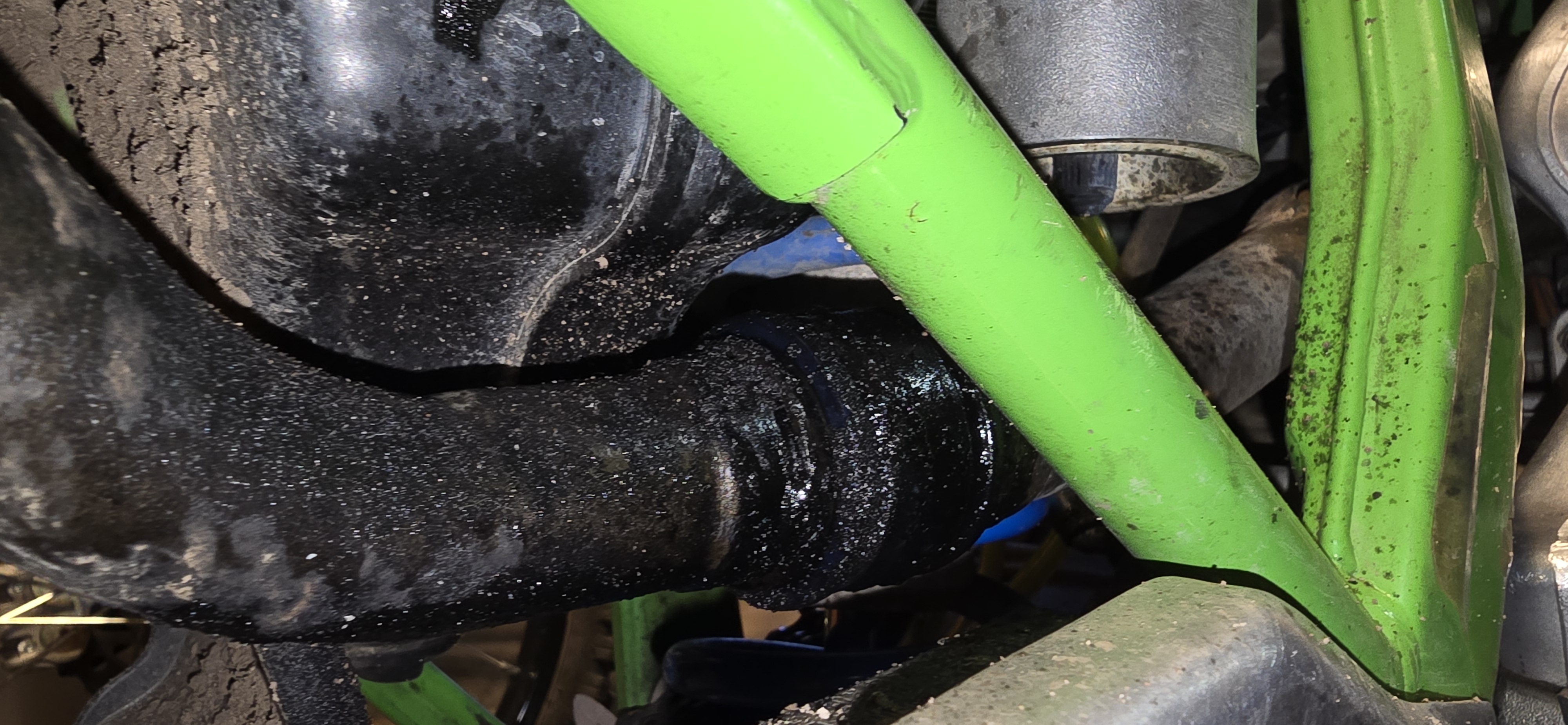

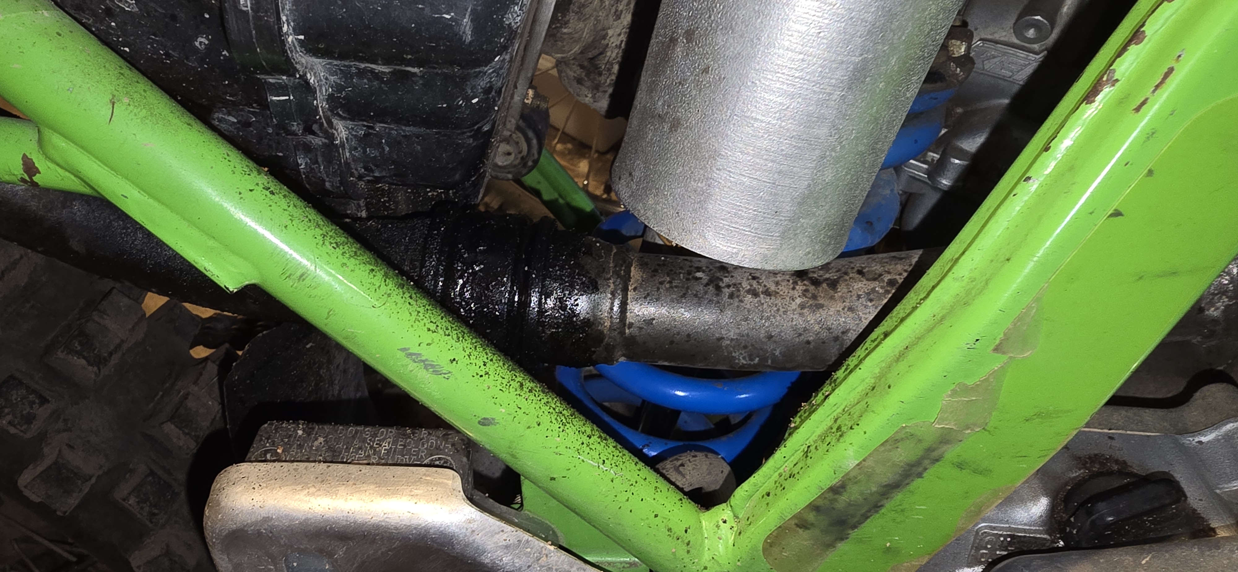

"...still blowing out oil from the connection point of the expansion chamber and silncer."
Can you post a pic of the joint? It should seal well there.

Here are a few pics, this is after about 60 miles of riding, i cleaned the swing arm between the 2 rides

That's quite a lot of oil coming out of that exhaust coupler... I'd say you may need to #1 replace that exhaust coupling, & #2 pull the drain bolt plug on the spark arrestor bottom rear, and see how much oil is sitting inside it that drains out (make sure the hole isn't plugged with carbon buildup preventing excess oil from draining out), and possibly remove your spark arrester silencer and flush it out with solvent to clear some excess residual oil and carbon.
#3 perhaps replace the carburetor's jet block gasket with a genuine Keihin piece from JDJetting.com (PWK33/35 Long Body carb). This requires a tamper proof torx security bit to get at, abd this part is NOT on any OEM parts diagrams from any manufacturer using Keihin PWK carbs, FYI.
This leaking any tiny amount of air can foul up your jetting and state of tune in general until replaced, and no amount of rejetting will fix it.
