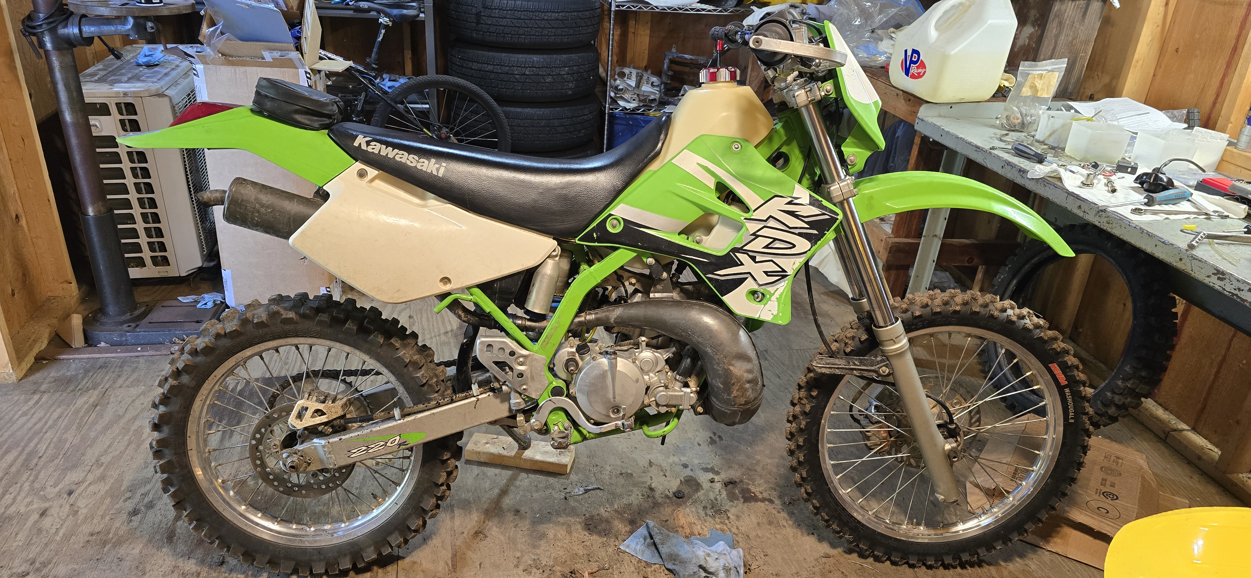

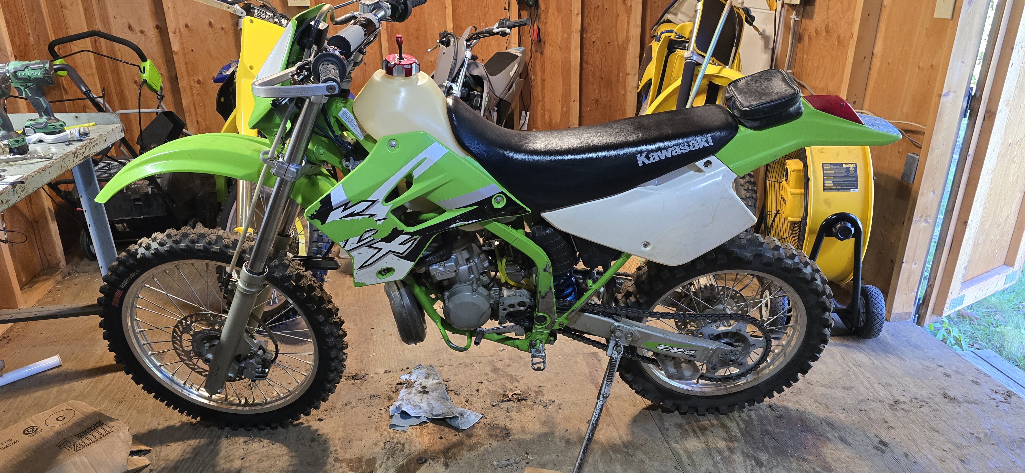

No albums yet, I have videos to edit from my ride this weekend. I typically ride in lower peninsula in Michigan. Here are a couple pics
