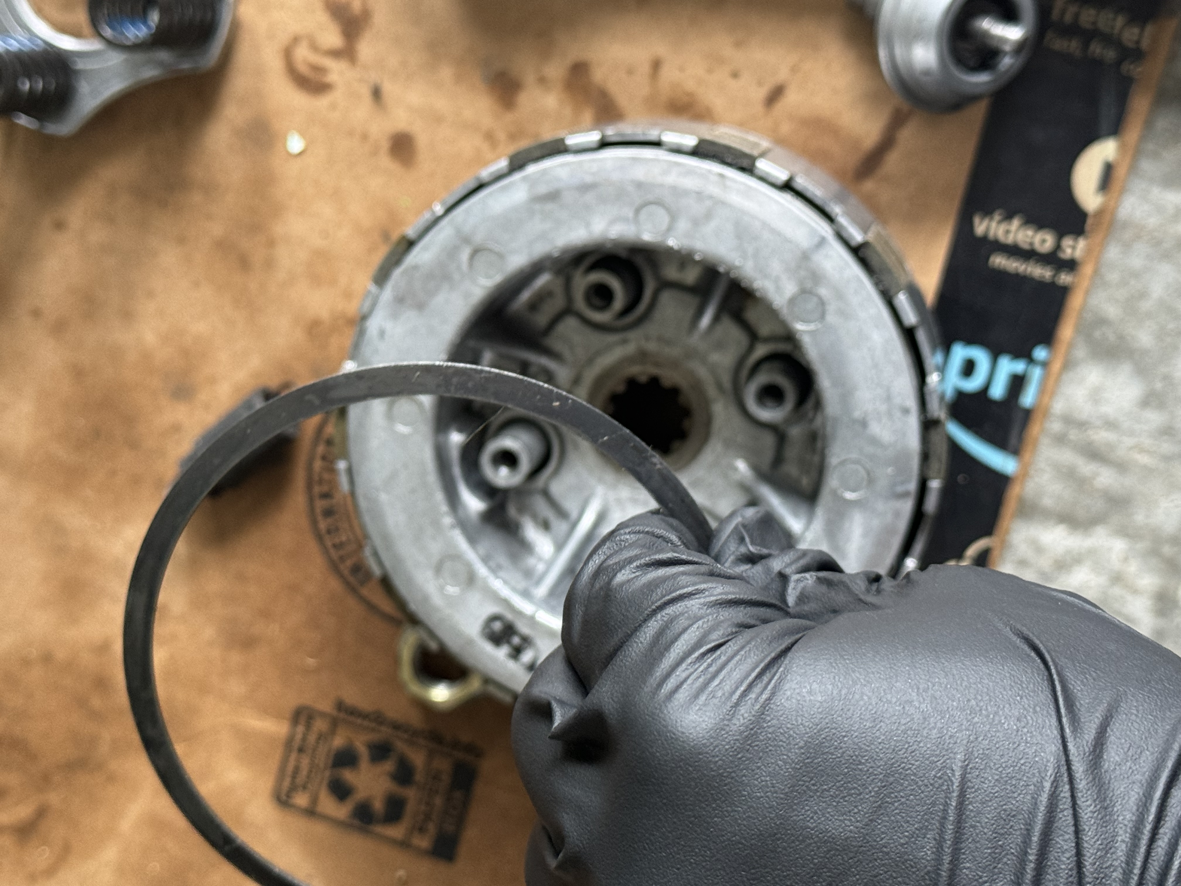

Putting together my clutch after tearing down doing a water pump rebuild, where tf do these things go? Concave large rings I believe there’s two
- IMG_3223.jpeg (2.12 MiB) Viewed 2182 times

Those are the judder springs, very important for slow speed technical riding, refer to service manual on how they fit, I don't have a service manual handy to show you

The judder spring smooths out the engagement of the clutch, effectively making it less on/off and in theory improving the modulation. There should be a conical one (the judder spring) and a flat one (the seat). The seat goes on the clutch hub first followed by the judder spring such that the concave side is facing away from the seat.
Also, make sure you get the washer stackup correct when reassembling the clutch or it will have issues.
