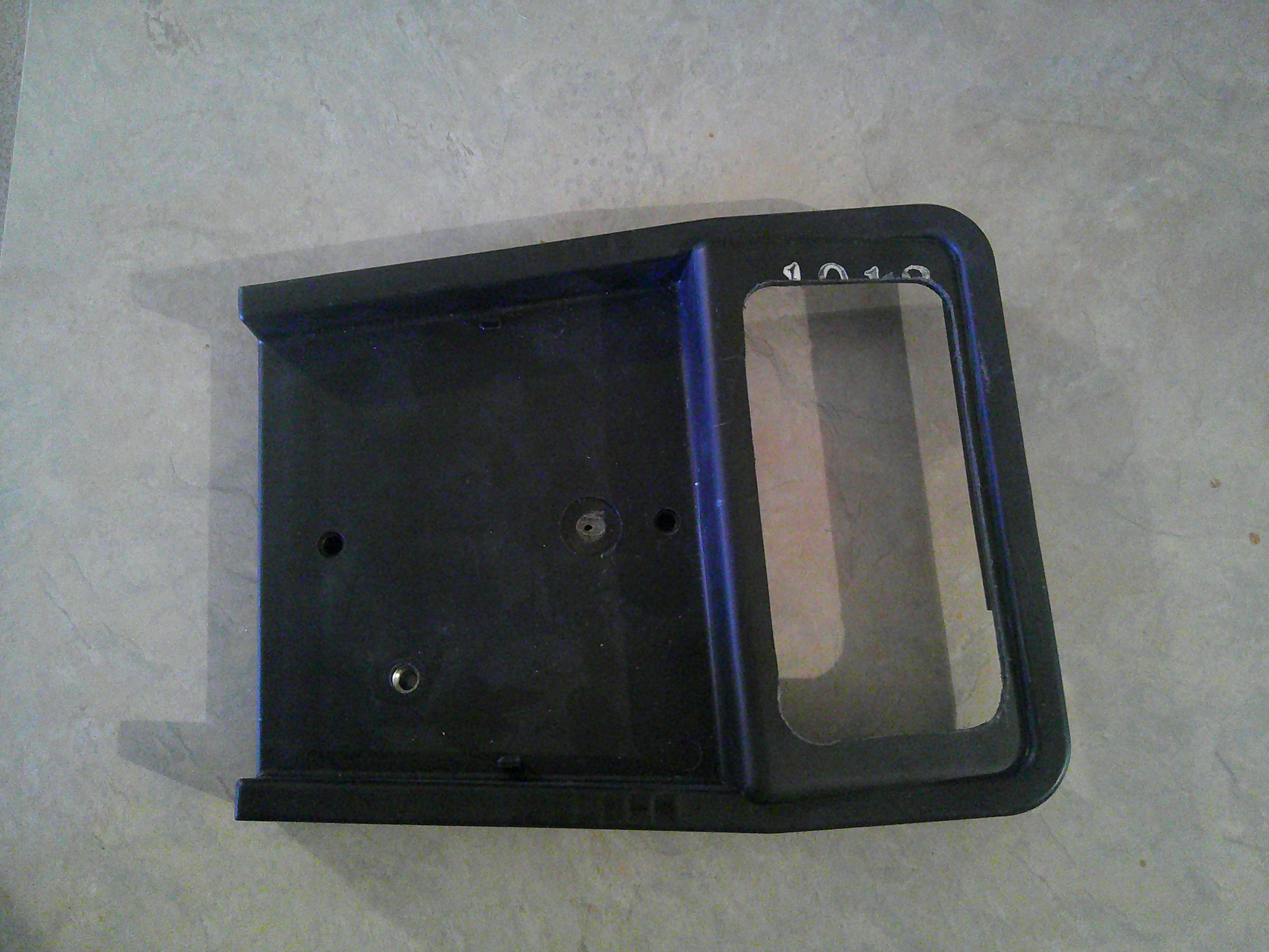

OK, here's what I did to my airbox lid. I am unaware of any certain size to cut it out to. For my case, I wanted more air, so I removed
the snorkel. Then I carefully clamped the airbox lid in a vice on my friend's vertical mill. I just milled the elevated part where the snorkel goes
to about a 2 x 4-inch hole. It's really about 2 1/8 x 4 1/2 inches. I just eyeballed it. I used a 2 flute 1/2-inch end mill.
I like a quieter bike, so this worked for me better than with the lid removed. I did not use any science, I just did it.

Posts: 675
Has thanked: 6 times
Been thanked: 3 times
Re: Airbox snorkel cut out size
Here is a picture of my airbox lid. I kept the stock one so I can go back if I want.
