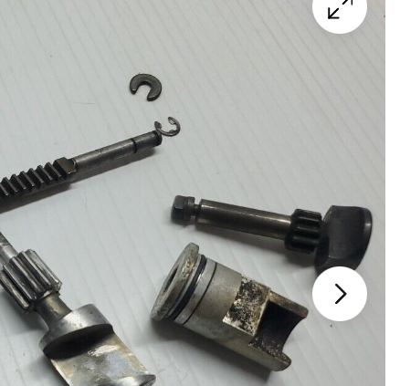

I looked at the exploded view of the cylinder and kips parts on Partzilla and it you're missing the 92026-1333 spacer that sits inside of the cap. It seems like that spacer would press against the center valve bushing like your finger is doing and only make it worse. But, its gotta be there for a reason and it being named "spacer" sounds promising.

Post by John_S »
The piece at the top of this picture is the spacer (from the looks of it) on the exploded parts view from Partzilla. It looks like that would slip over the groove in the shaft coming out the front and keep the shaft from being pushed in too far when you tighten the cap. A quick test I'm thinking is to push on the outer part like you're doing in the video (to make it stick) and then grab that front facing shaft with a pair of pliers lightly, pulling outward and seeing if it will then rotate left and right.
If it works you could take a regular washer that fits into that groove and then make it a 3/4 washer with a grinder to match the OEM spacer. It won't be fun getting the right thickness and OD but hopefully you'll be back on the trail soon.
Great info, that clip was missing when I took it apart.

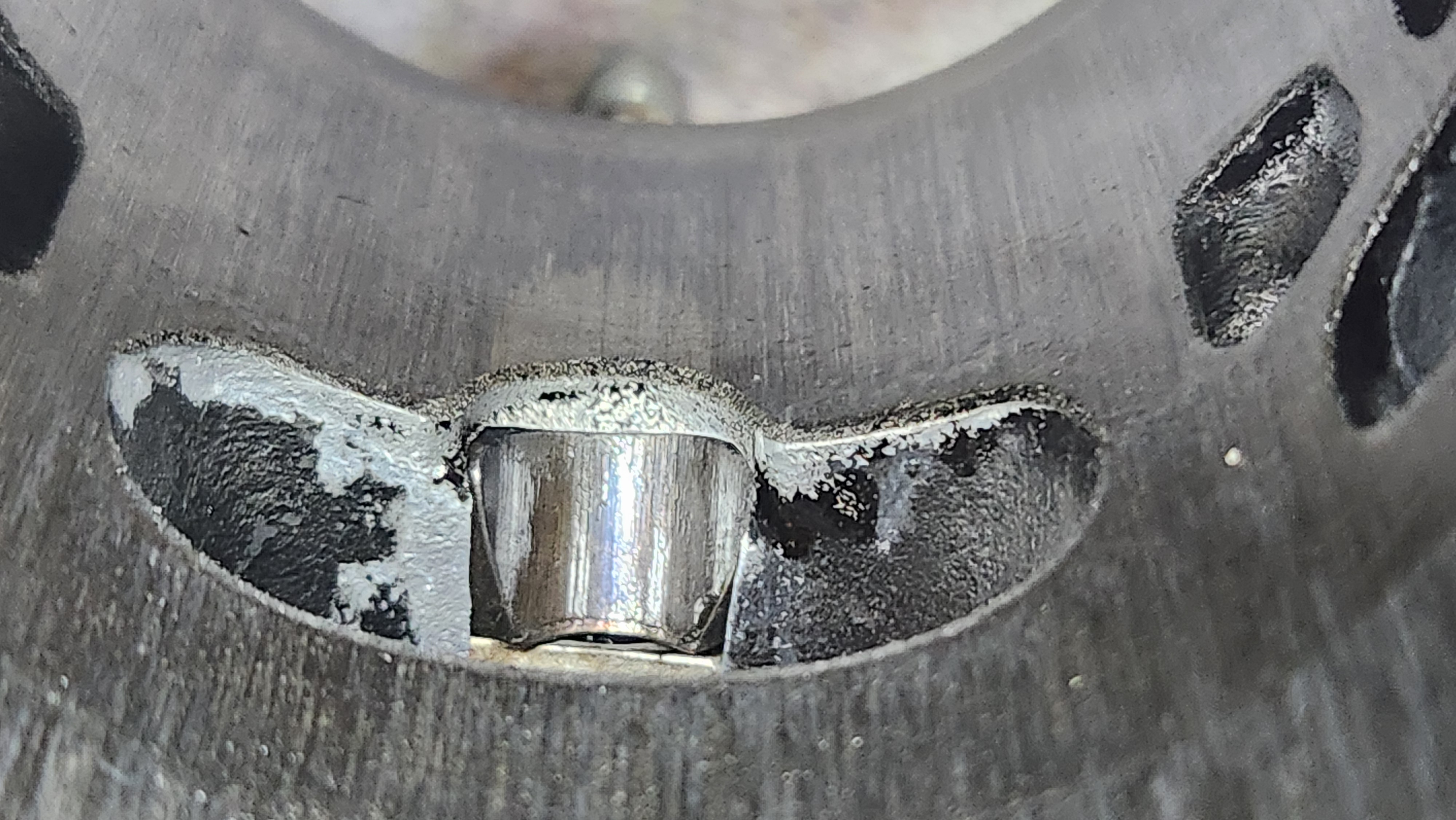

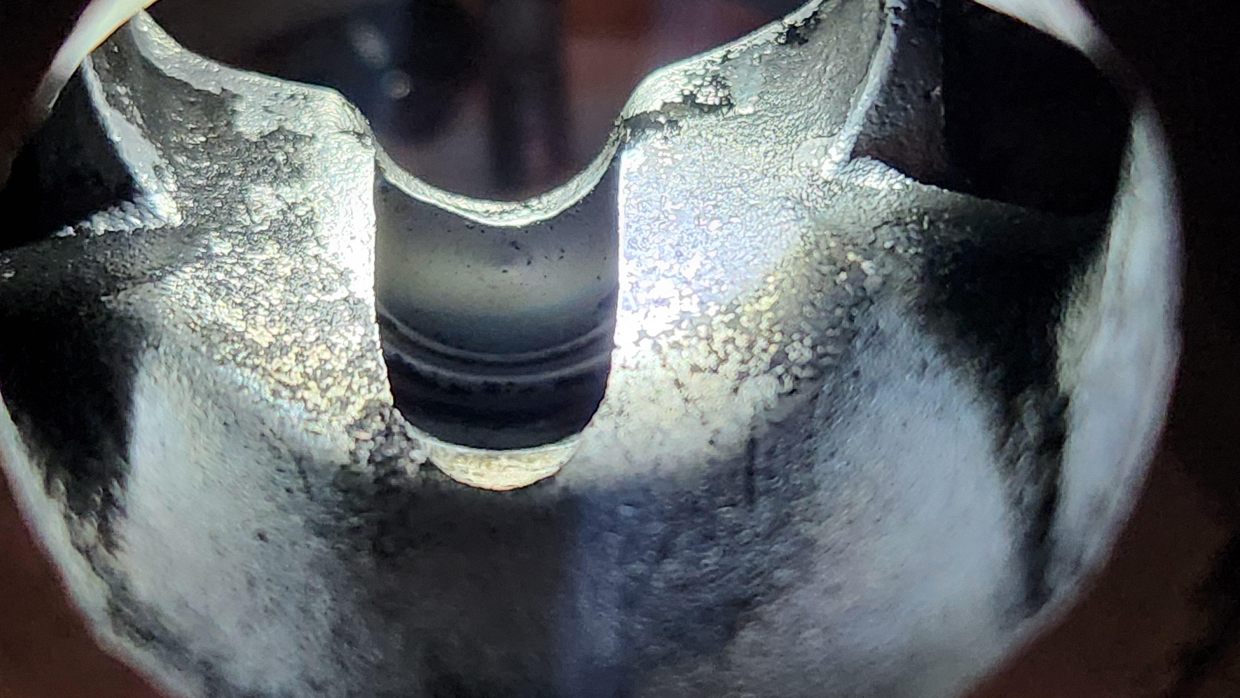

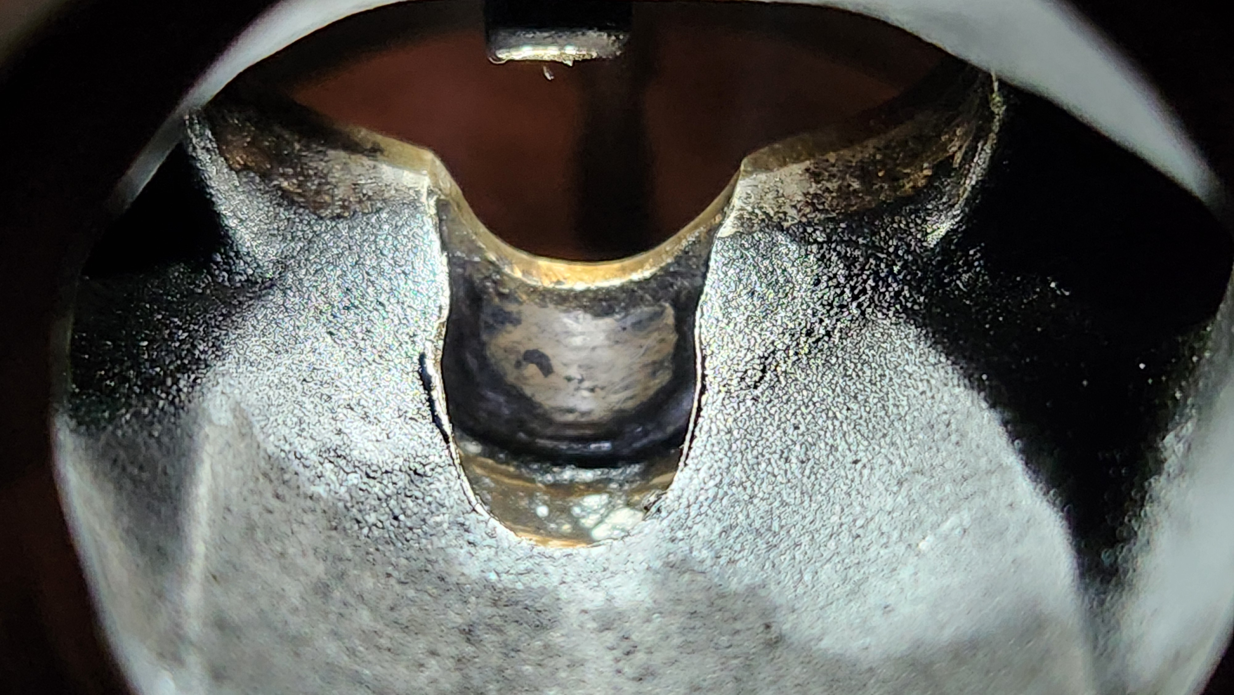

Re: Need help diagnosing bound up KIPS valve...
IN the photos above I assume the sleeved cylinder is the lower one? Looks to be wear on the back side of the sleeve in about the area that the center valve would be rotating. Also looks like the wall thickness at the point is different between the Upper (Plated?) and lower sleeved cylinders. That lower one also looks like it may have some burrs along the cutout, and the shape of that port isn't the same between the two. The machinist dye trick that JimmyB suggested should tell you a lot.
