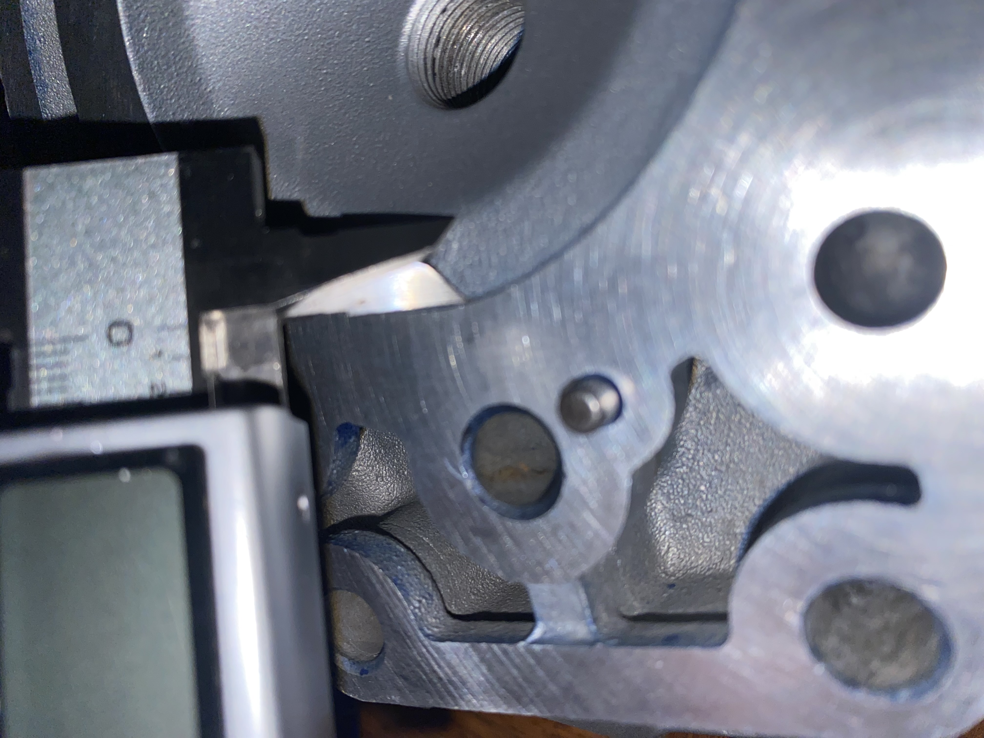

Ok I might give it a try. It’s the entire surface as you can see that’s textured. Here’s a pic that I took while trying to measure the squish band width that shows the texture. Hopefully I’m getting my terminology correct when I say casting marks. There isn’t anything that I would consider an edge.SS109 wrote: 09:49 pm Jan 10 2024 Casting marks in the chamber itself? Weird. Got a pic?

That’s how they look from the factory. With everything you’ve been through, a perfectly running, reliable 200 with a stock head would be a beautiful thing. Bolt it up and let’s see if all of the other issues are gone. Most of the KDX’s out there that everyone praises over the years have been running that head.
Edit: I reread your 2nd sentence. My 220 head didn’t look perfectly smooth until I got it back from RB. It had the same micro stippled look that your 200 has. You’re too close to the project if you know what I mean. I deal with that at work where I’m worried about something that isn’t really an issue. Sweating the small stuff as they say.

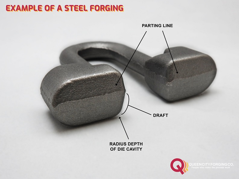

Yeah, I agree with John. That is just the factory casting and not anything to worry about. Leave it be, bolt it on, and go ride! Please disregard my first post completely. I thought you meant it had a casting line (a.k.a. parting line) in the chamber like in the pic below.JZ05220r wrote: 12:11 am Jan 11 2024 Ok I might give it a try. It’s the entire surface as you can see that’s textured. Here’s a pic that I took while trying to measure the squish band width that shows the texture. Hopefully I’m getting my terminology correct when I say casting marks. There isn’t anything that I would consider an edge.

My stock chambered 220 heads look perfectly smooth except for a few detonation marks on one or two of them... Not like the textured casting pictured on James' 200 head.
My RB heads looks perfectly machined in contrast, whereas my stock chambered 220 heads look like a very smooth cast finish.

Yeah, part of RBs squish band work involved reworking the head volume. My 220 head has the typical sand cast finish as well.

Yes, RB takes a fairly significant amount off the head gasket surface in order to create the sharp break at the edge of the squish band vs chamber dome (vs more rounded transition as stock), so in order to safely run 90 octane (USA octane rating), and also to keep peak cylinder pressures under the max 200psi-ish safe zone, the chamber volume needs cut to bring the total head volume back to near stock.
