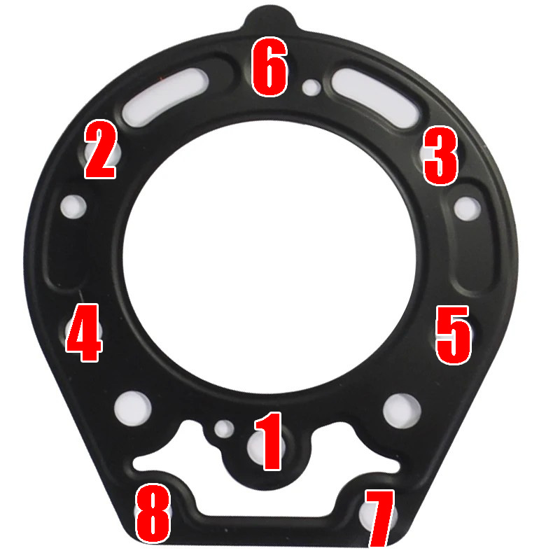

Dug up an old post from 2012 where you mentioned stock head and base gaskets are your go to. With all your experience with the kdx’s do you still stand by that?SS109 wrote: 09:11 pm Dec 28 2023 This is how I do it. I also torque it in two stages. (Yes, I'm OCD when it comes to how I do things!) I do the pattern once at 10 ft-lbs and then follow it again as I finish torquing it to it's finals spec of 18 ft-lbs.

Yes, I do. Factory head gaskets have always worked for me with both stock and RB modded heads without issue. As evidenced by my Youtube vids, I don't take it easy on my KDX or any bike! I still prefer the OEM base gaskets as I do believe the material they use is of higher quality and density than the aftermarket versions I've had in my possession over the years.JZ05220r wrote: 10:19 pm Dec 29 2023Dug up an old post from 2012 where you mentioned stock head and base gaskets are your go to. With all your experience with the kdx’s do you still stand by that?SS109 wrote: 09:11 pm Dec 28 2023 This is how I do it. I also torque it in two stages. (Yes, I'm OCD when it comes to how I do things!) I do the pattern once at 10 ft-lbs and then follow it again as I finish torquing it to it's finals spec of 18 ft-lbs.

SS109 wrote: 01:02 am Dec 30 2023Yes, I do. Factory head gaskets have always worked for me with both stock and RB modded heads without issue. As evidenced by my Youtube vids, I don't take it easy on my KDX or any bike! I still prefer the OEM base gaskets as I do believe the material they use is of higher quality and density than the aftermarket versions I've had in my possession over the years.JZ05220r wrote: 10:19 pm Dec 29 2023Dug up an old post from 2012 where you mentioned stock head and base gaskets are your go to. With all your experience with the kdx’s do you still stand by that?SS109 wrote: 09:11 pm Dec 28 2023 This is how I do it. I also torque it in two stages. (Yes, I'm OCD when it comes to how I do things!) I do the pattern once at 10 ft-lbs and then follow it again as I finish torquing it to it's finals spec of 18 ft-lbs.

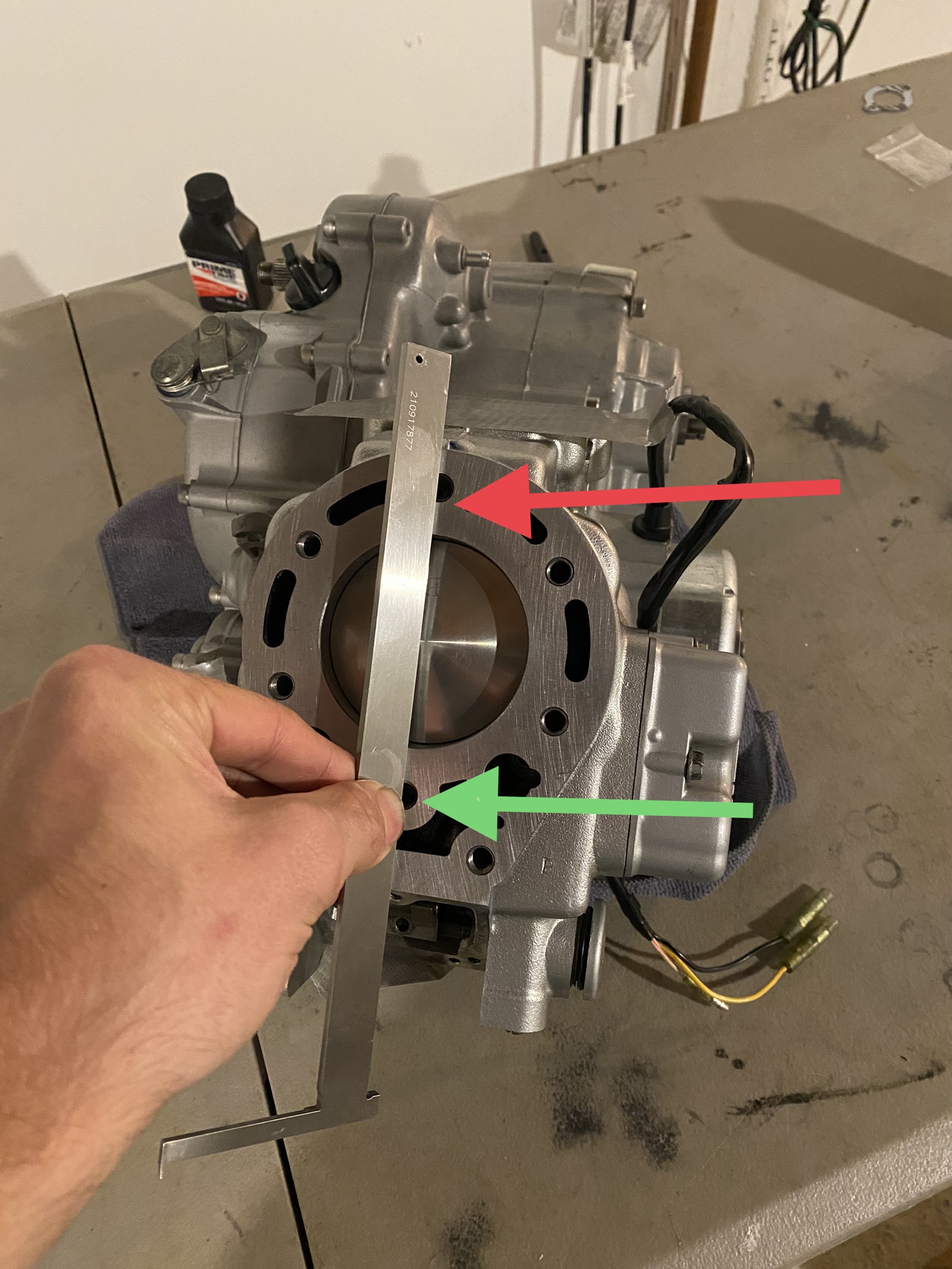

Ok, well I rechecked everything with a straight edge and the cylinder head is dead on. I was using a .04mm feeler gauge and found that when I put pressure on the exhaust side of the cylinder it opens up a big enough gap to let the feeler gauge slide through the intake side. When I center the pressure into the middle of the cylinder I can no longer fit the gauge. I left a pic for example. Hopefully this won’t be an issue. Red arrow represents where gaps are and green represents no gap.SS109 wrote: 02:03 am Dec 30 2023No clue. I've always installed them dry. I have even reused one once after spraying it with Permatex Copper Spray gasket. I think the factory gaskets are plenty tough.JZ05220r wrote: 01:59 am Dec 30 2023 I once read putting a light coat of grease of the headgasket helps making sure everything falls into place nicely. Probably not a good idea with the oem headgasket I would assume.

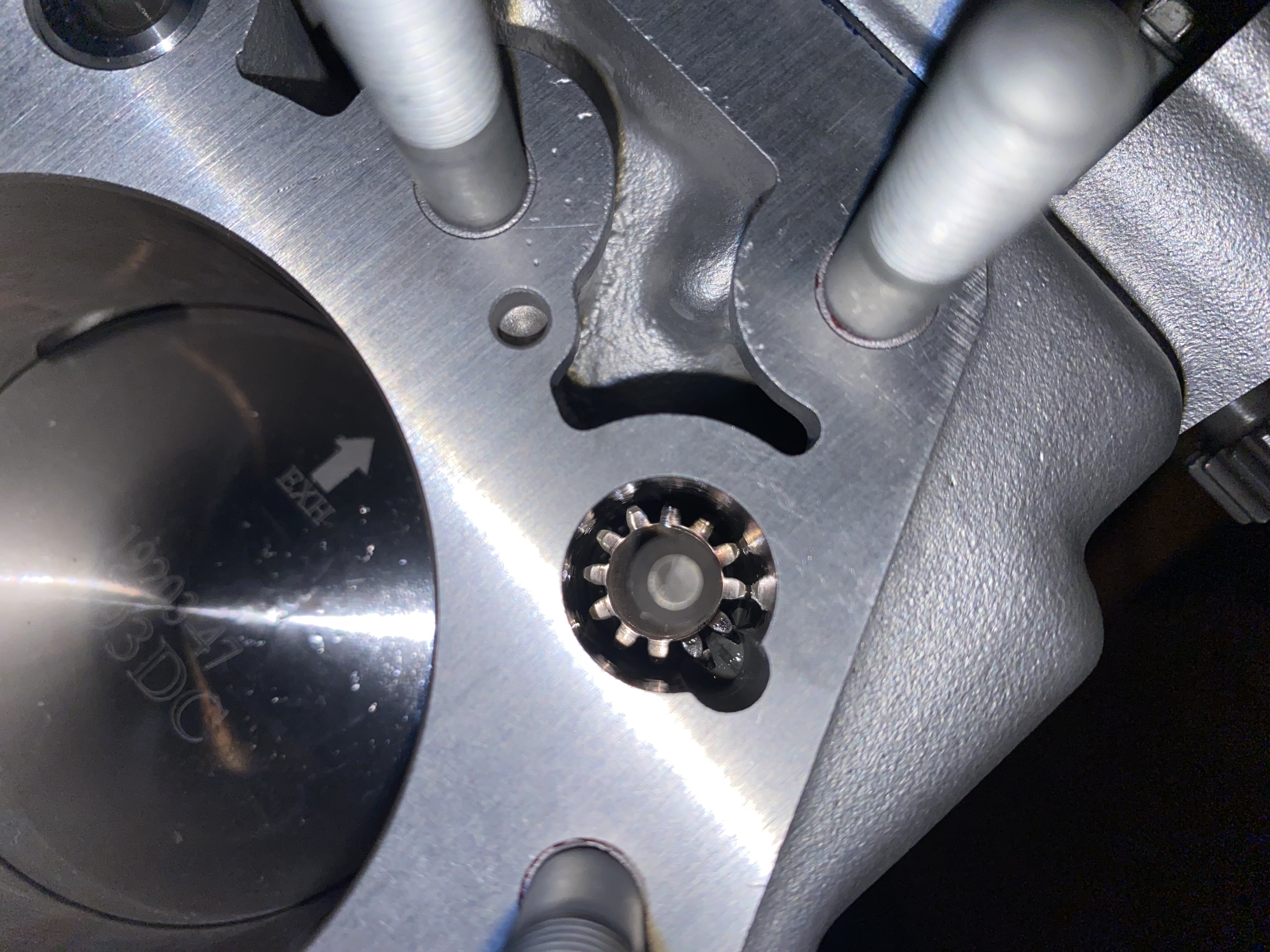

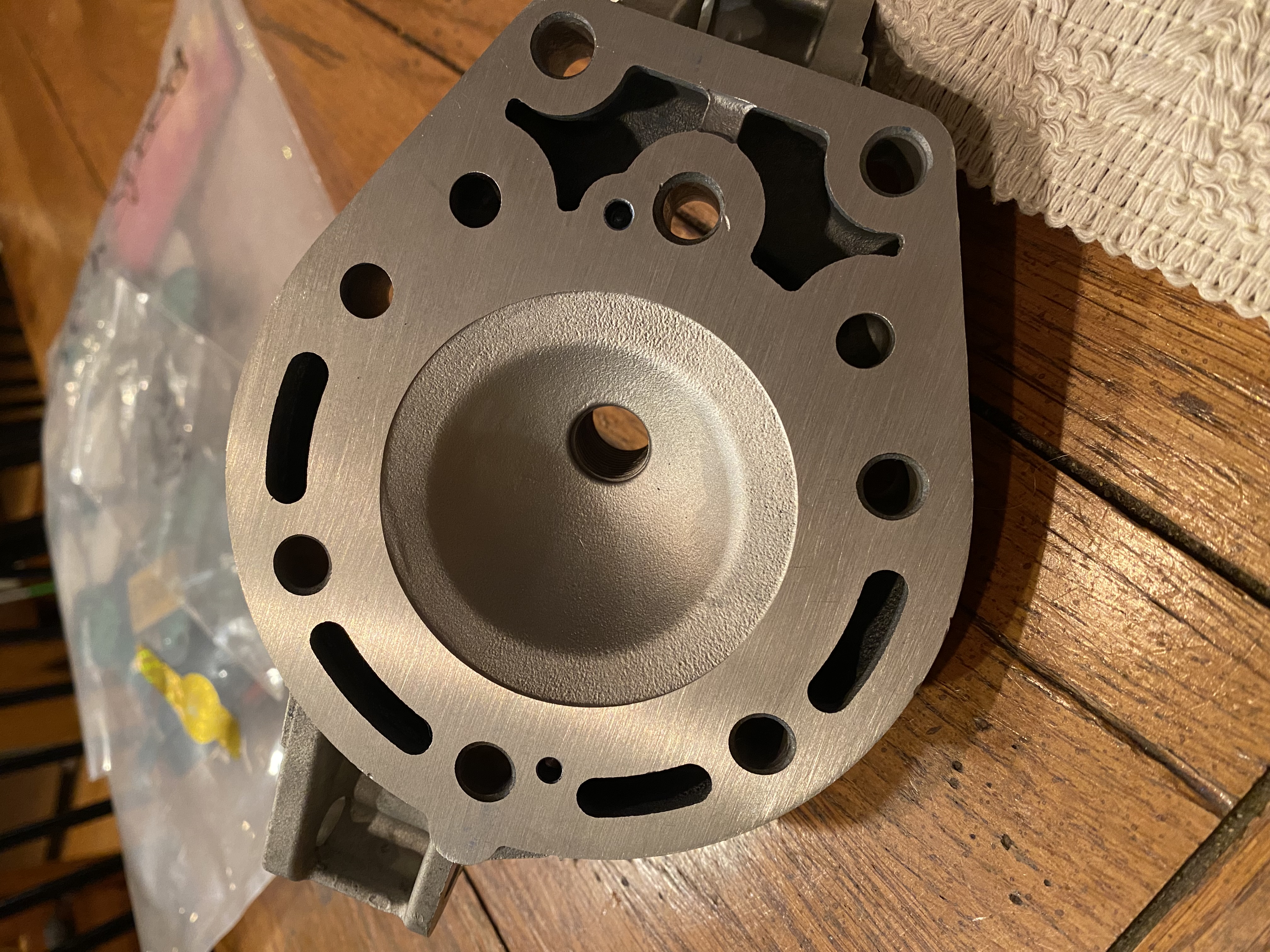

I learned that the subvalve guides for a 220 cylinder are 1mm taller. Found that the kips was completely locked when torquing the head. That’s why I’m concerned with the flatness on an otherwise brand new oem 200 cylinder,especially around the subvalve guide areas because it could have created warp. I’m going to try a more reliable straight edge like a precision parallel set and see what I get. If I’m not satisfied I’m going to pull the cylinder and lap it on my piece of granite. I’d use some non permanent adhesive spray to hold the sandpaper still and flat. Question: I have some layout dye and was thinking of coating the head surface and placing it on the cylinder to check for full contact. Is their a better method for utilizing the layout dye in my situation?

layout dye is perfect for your situation, i made my own from tyre grease and blue ink, i really learnt alot from using it, what i thought was perfectly flat was not even close to flat, just remember granite is not perfectly flat,at least that has been my experienceJZ05220r wrote: 04:25 pm Dec 31 2023 I learned that the subvalve guides for a 220 cylinder are 1mm taller. Found that the kips was completely locked when torquing the head. That’s why I’m concerned with the flatness on an otherwise brand new oem 200 cylinder,especially around the subvalve guide areas because it could have created warp. I’m going to try a more reliable straight edge like a precision parallel set and see what I get. If I’m not satisfied I’m going to pull the cylinder and lap it on my piece of granite. I’d use some non permanent adhesive spray to hold the sandpaper still and flat. Question: I have some layout dye and was thinking of coating the head surface and placing it on the cylinder to check for full contact. Is their a better method for utilizing the layout dye in my situation?

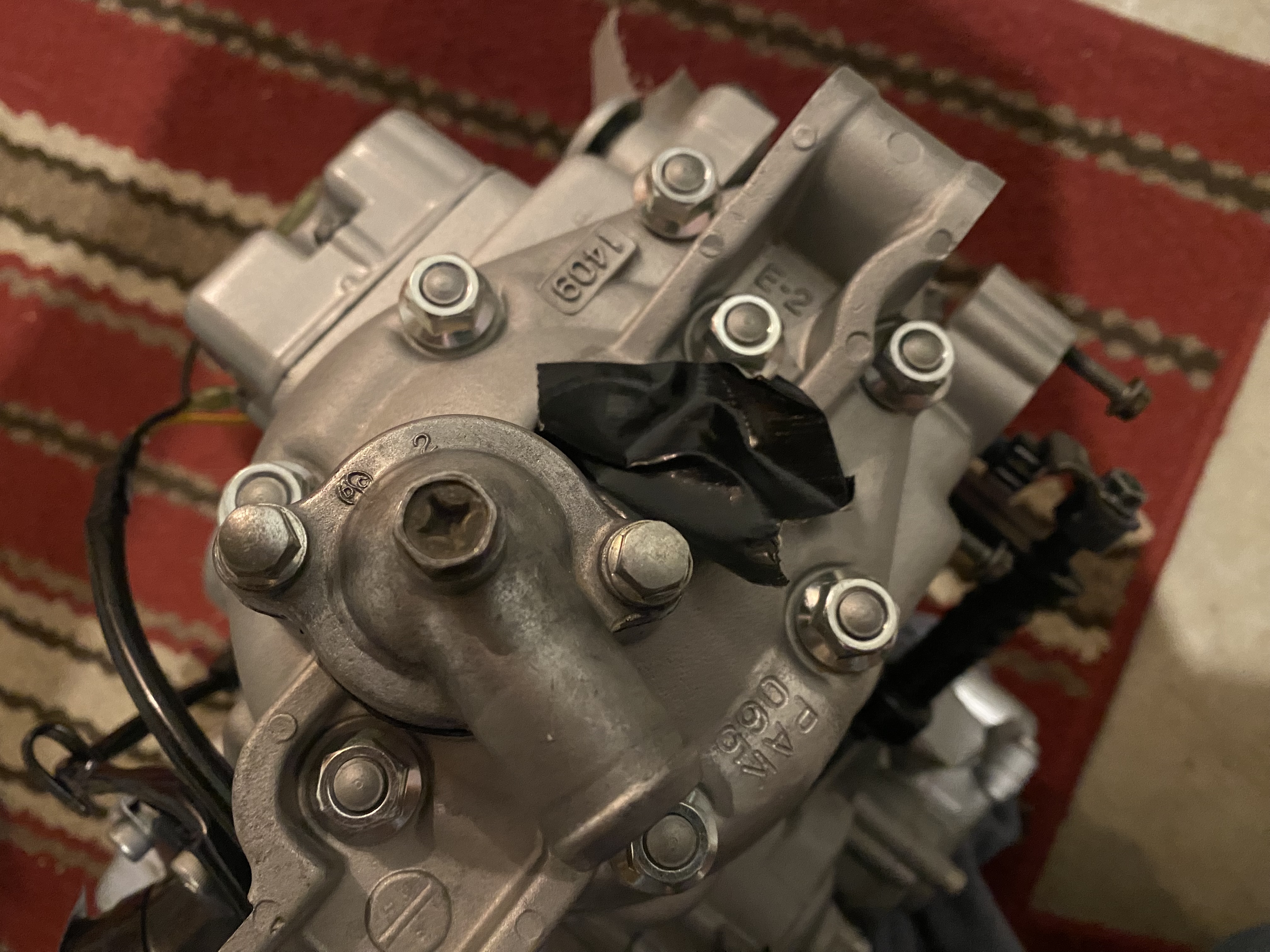

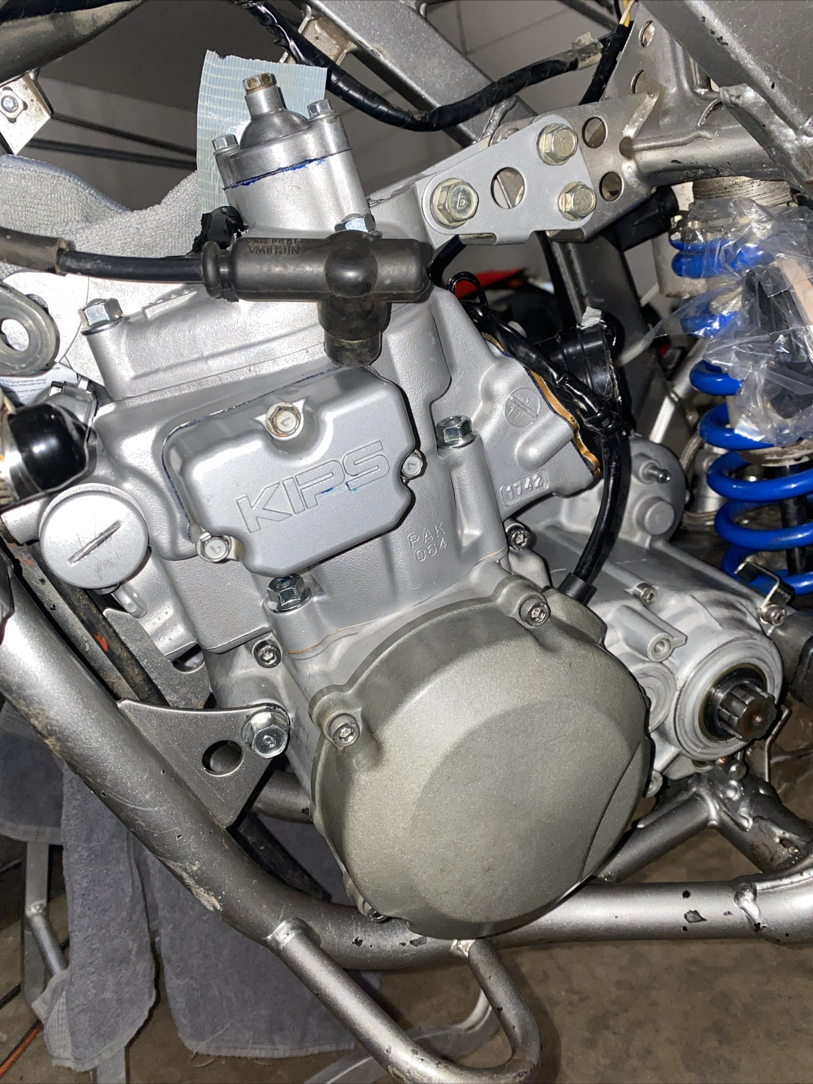

Fingers crossed for a good head gasket seal. Torque in two stages in the pattern that you mentioned. Although this wasn’t the problem cylinder, I had everything checked over by a guy at Millenium technologies.SS109 wrote: 02:03 am Dec 30 2023No clue. I've always installed them dry. I have even reused one once after spraying it with Permatex Copper Spray gasket. I think the factory gaskets are plenty tough.JZ05220r wrote: 01:59 am Dec 30 2023 I once read putting a light coat of grease of the headgasket helps making sure everything falls into place nicely. Probably not a good idea with the oem headgasket I would assume.
