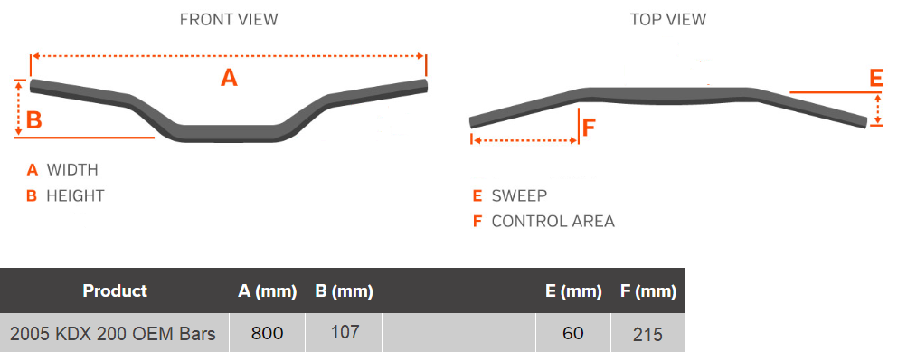

Hello,
If anyone is interested, I measured my 2005 KDX 200 OEM factory handlebars to see which after market handle bars were similar in size.
Attaching picture with measurements
A (width) = 800 mm
B (Height) = 107 mm (measured top point to bottom)
E (sweep) = 60 (measured center to center)
F (control areas) = 215 mm
Hopes this helps

Well hell yeah! Thanks, man!

The OEM KDX bars are nearly identical to the ProTaper Contour KX high or Pastrana FMX bends. For the SE bars the Trials Mid. I am currently running the CR High bend and find them to be very close as well.
