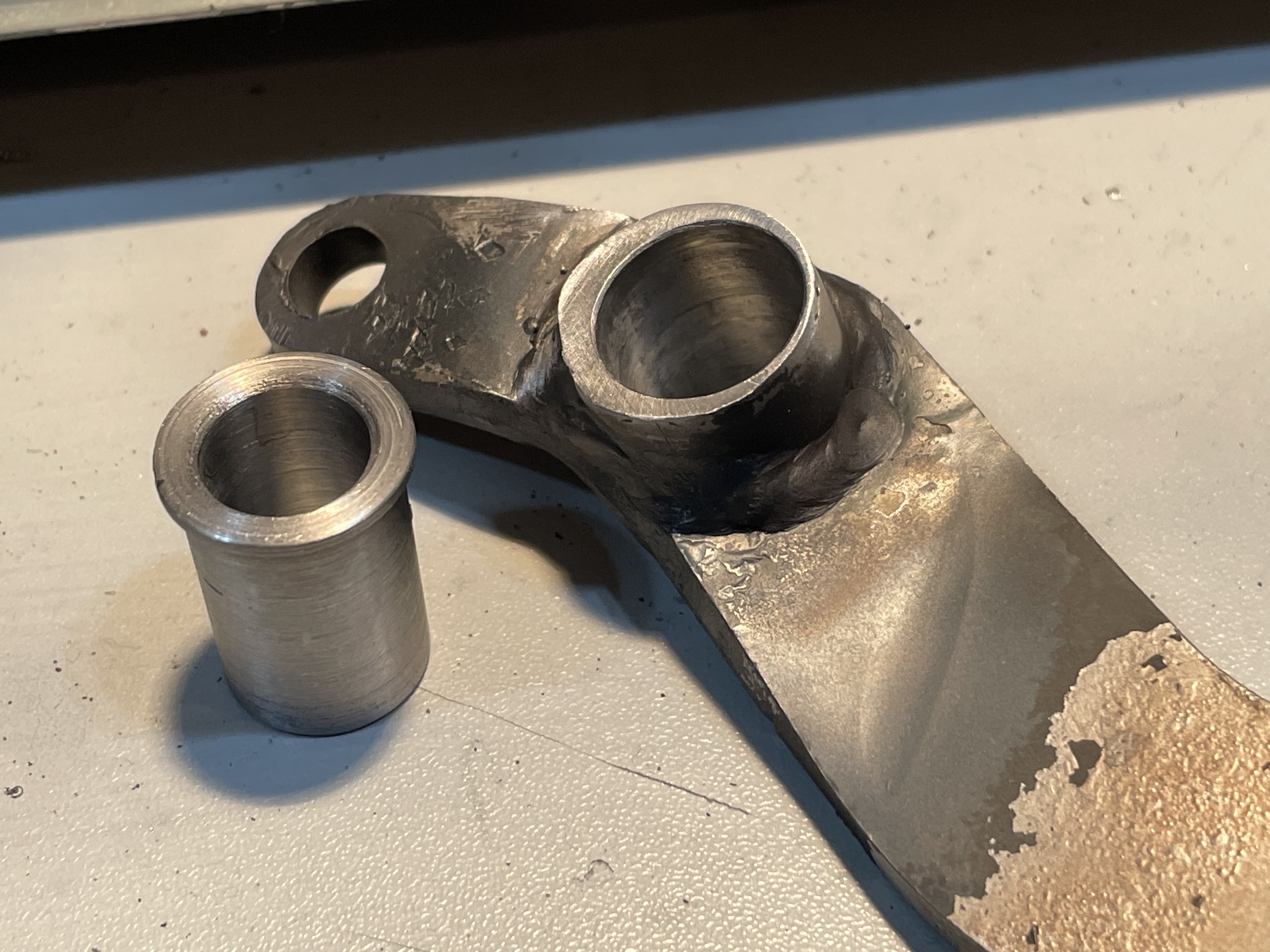

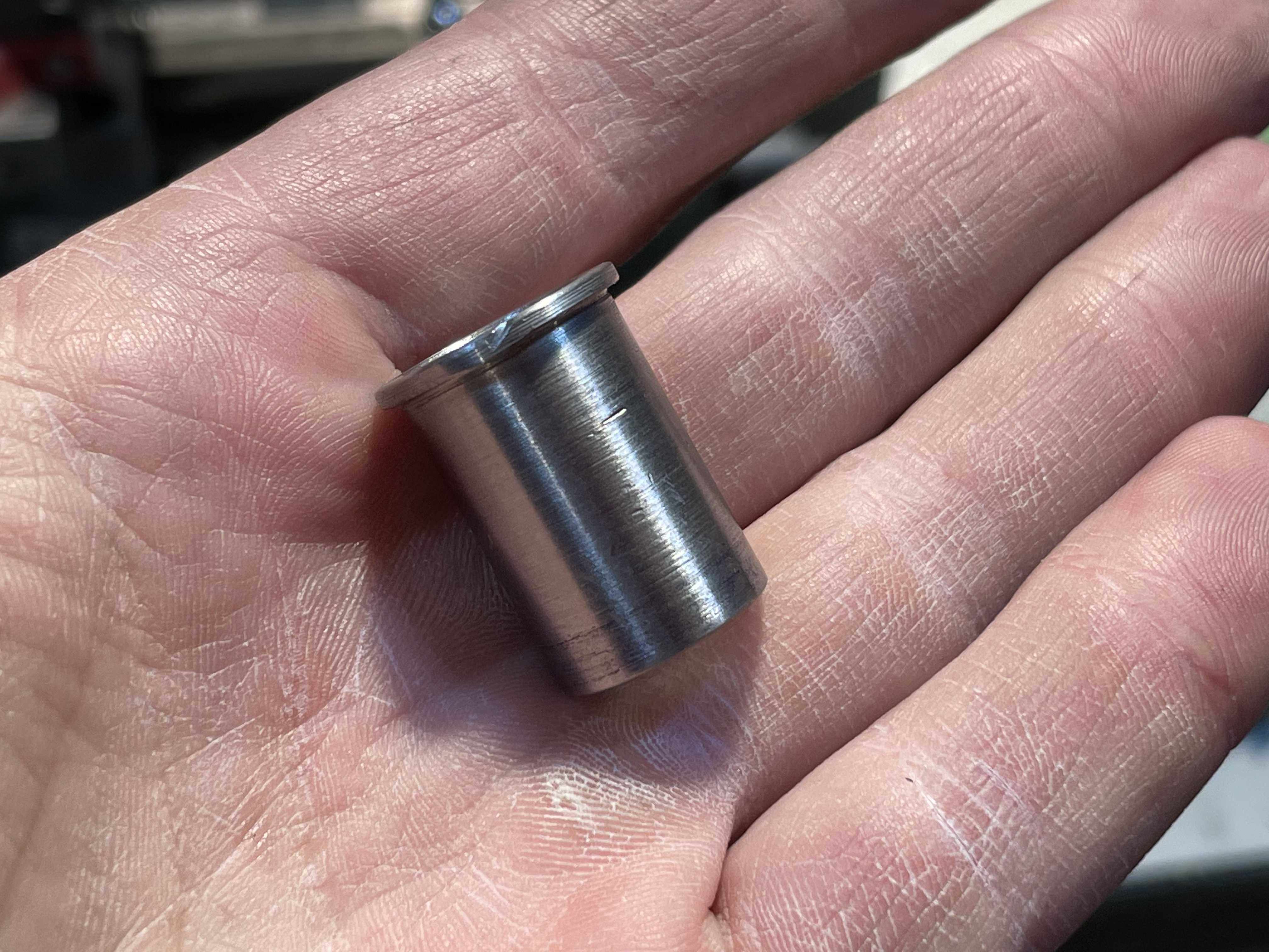

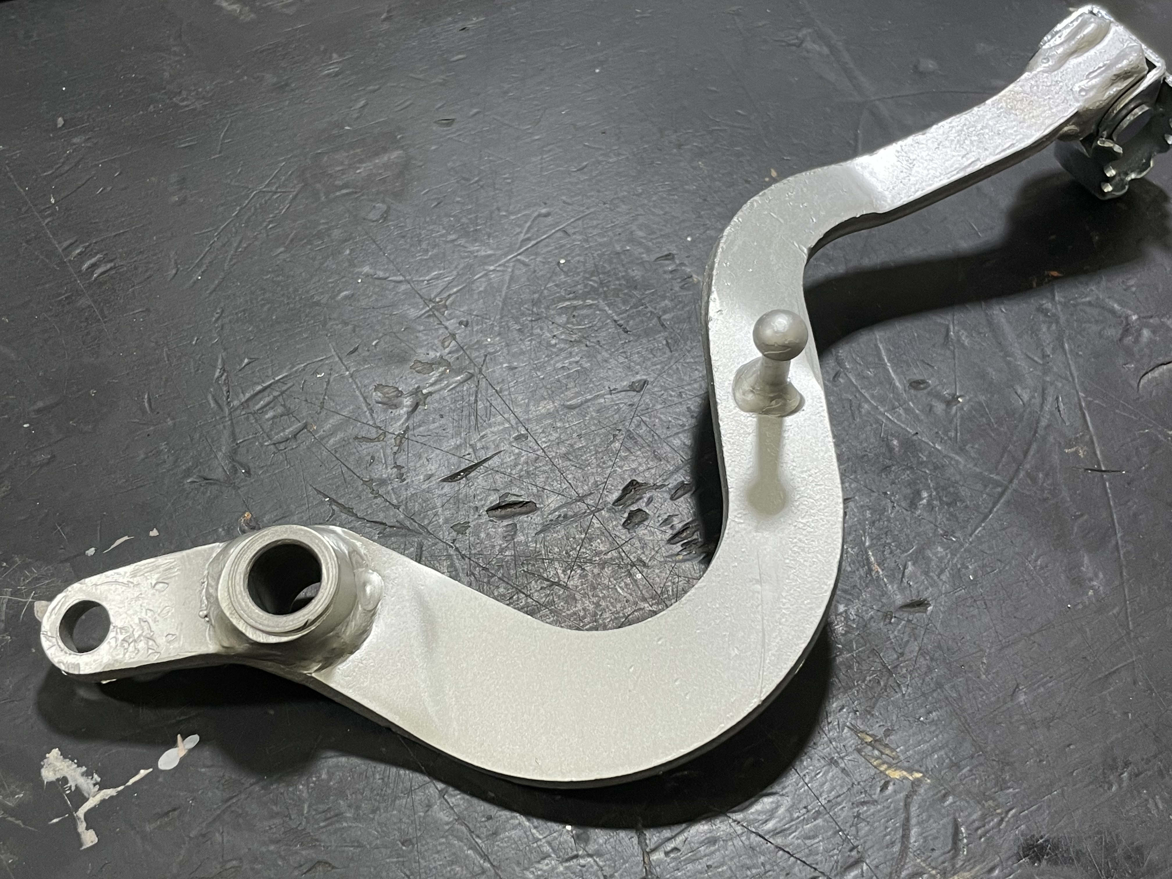

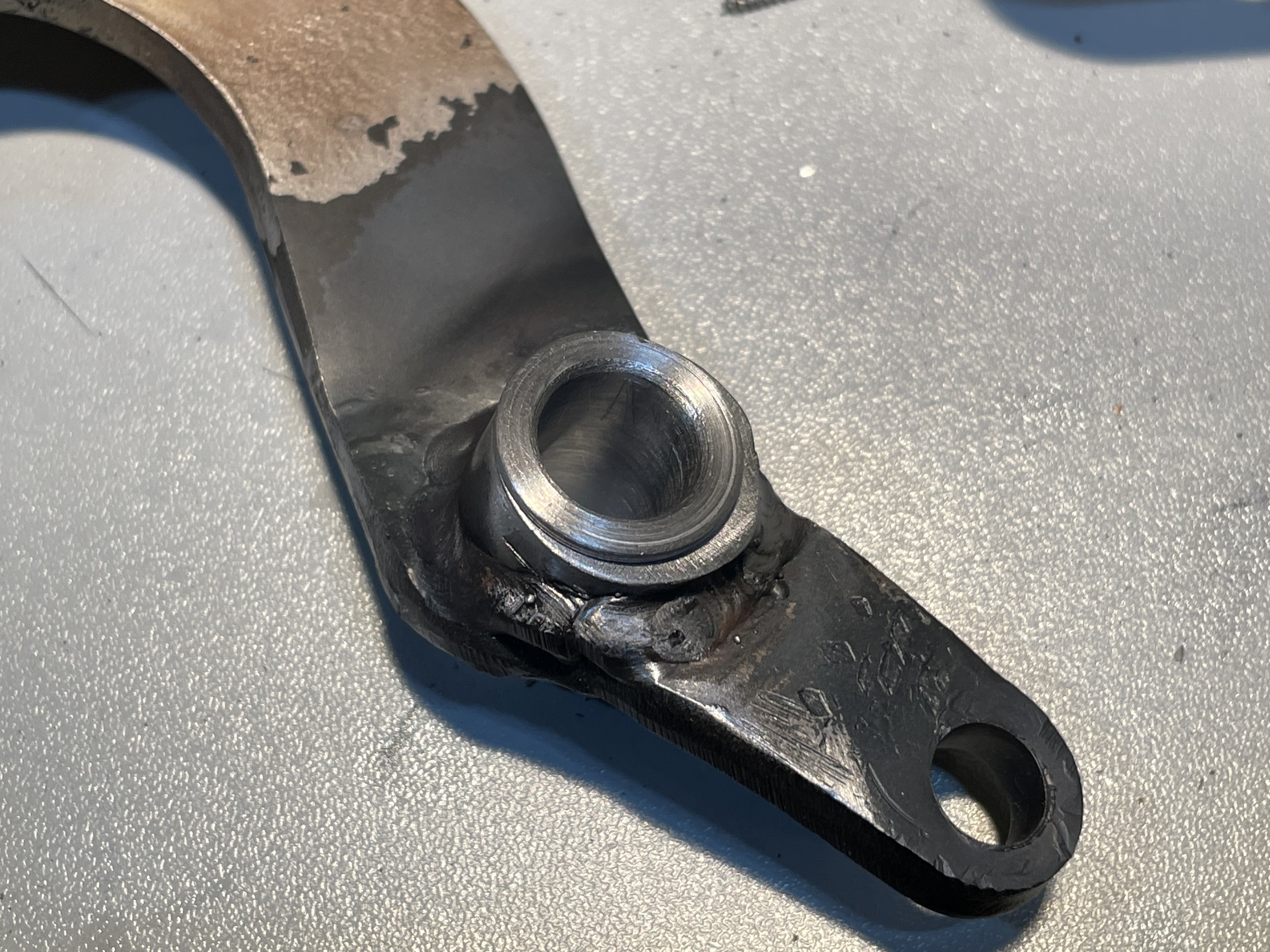

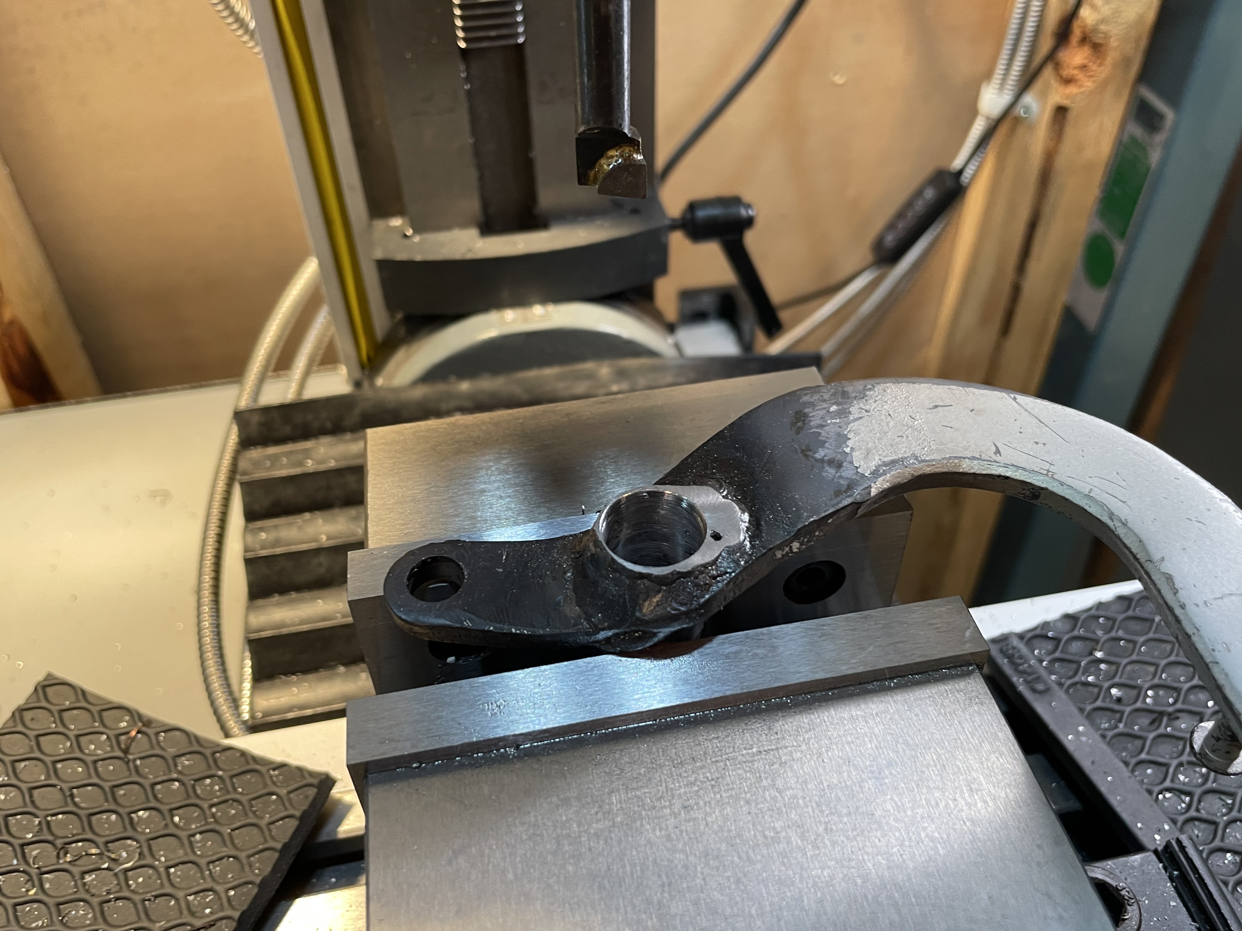

My brake pedal was sooooo hogged out and off center, I had to bore a new hole and machine a bushing to press in. The previous owner had tried to do some sort of hack repair with a welder, but that just caused the hole to oblong even more. I found the area that had the most “meat” left on the bone, and bored it out for a bushing. This was slightly off center from original, but it’s not noticeable. Bushing I made out of a soft grade of steel, since it is much easier to replace than the peg welded to the frame, I’d rather this bushing be the wear point. As SS109 can attest to after riding my bike, the rear brake now has zero slop in it.

Slick_Nick wrote: 09:12 pm Apr 08 2023 As SS109 can attest to after riding my bike, the rear brake now has zero slop in it.
Yes, I can attest to that! I know mine is getting to the point where something will need to be done to it. However, I am looking at doing a hybrid which will take care of all those little issues creeping up. :mrgreen:
Re: Suggestions for sourcing a bronze bushing for rear brake pedal?
WOW! Nice work!
