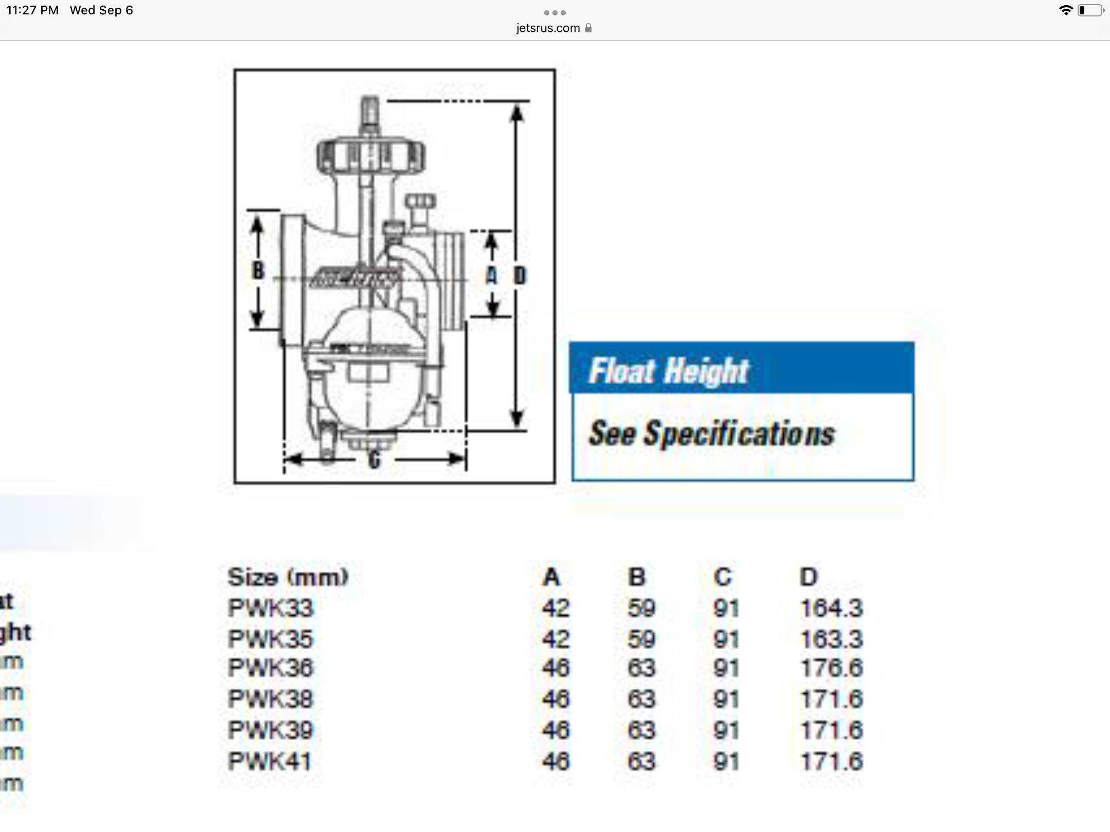

Any chance a PWK38 will work on the 200H?
Re: KDX 220 stock carburetor
It can be made to work, though you would need to sort the jetting out. Currently running a 38 on my sons RMX250 and it runs well, but does eat a bit more fuel than the old 35 that was on there.
Posts: 895
Joined: 06:59 am Jan 27 2017
Location: Florida
Been thanked: 4 times
Post by John_S »
I can’t imagine a 36 or 38 fitting on the H series. It would be such a stretch to get the carb into the reed and air box boots and they’re taller.
