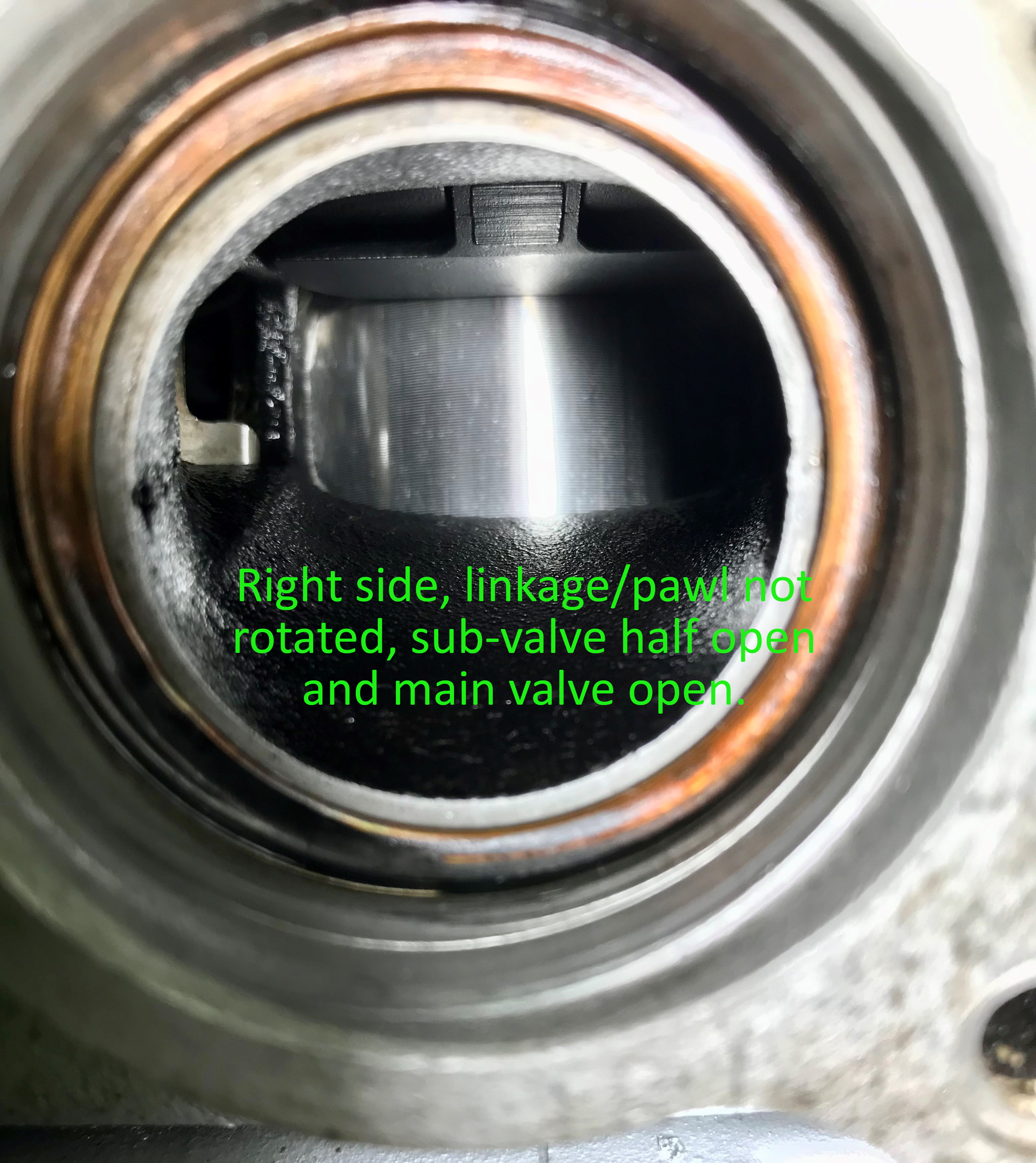

Hello. I just bought this 1998 KDX 220 that had the motor totally gone through. I'm questioning if the KIPS system was installed correctly. Bike seems to have little compression when kicking over but does start after 2-3 kicks.
Once warmed up it never gets on the pipe and feels lethargic. Gets to the point you think it should get on the pipe and just stays at that mid RPM range.

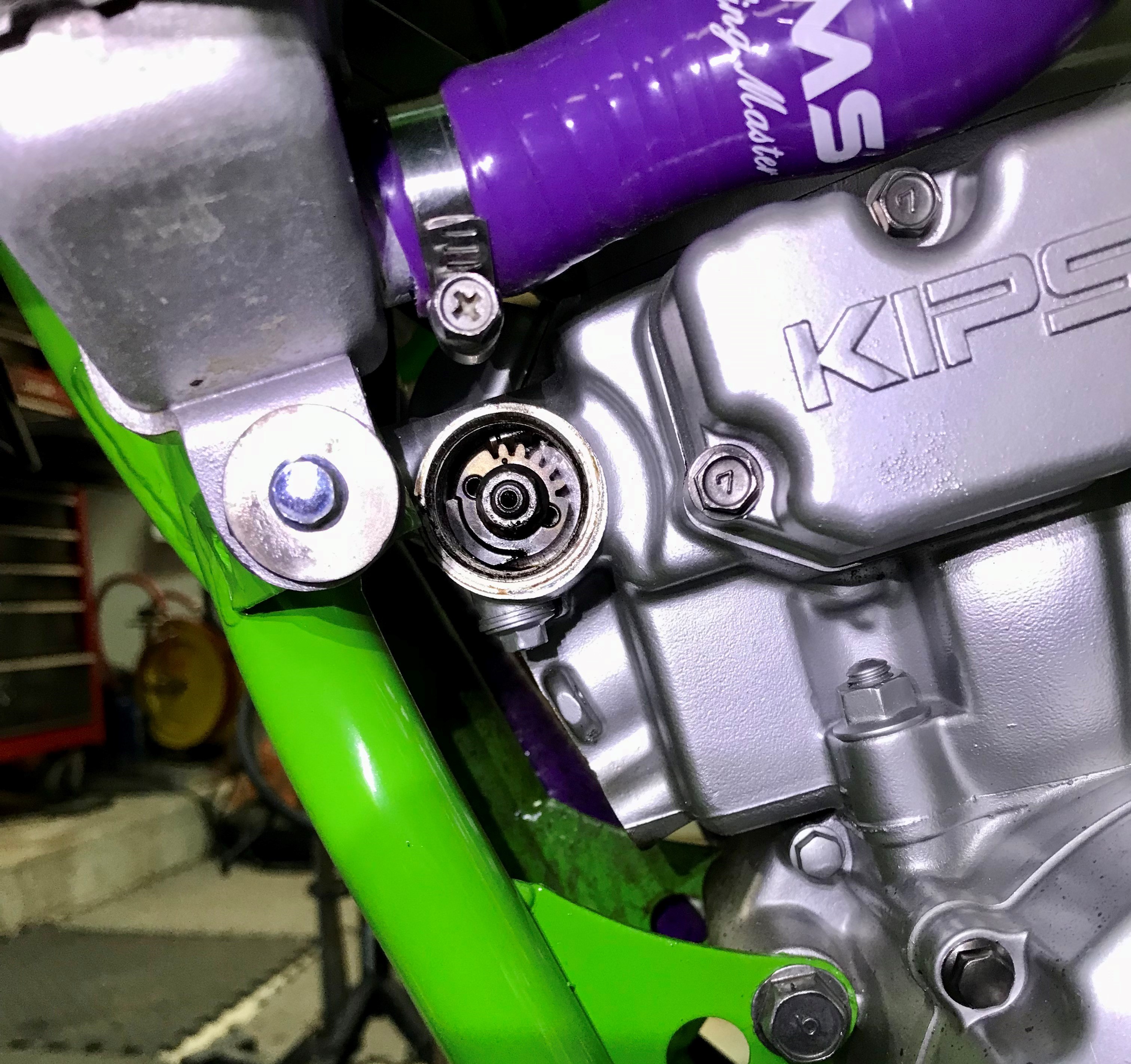

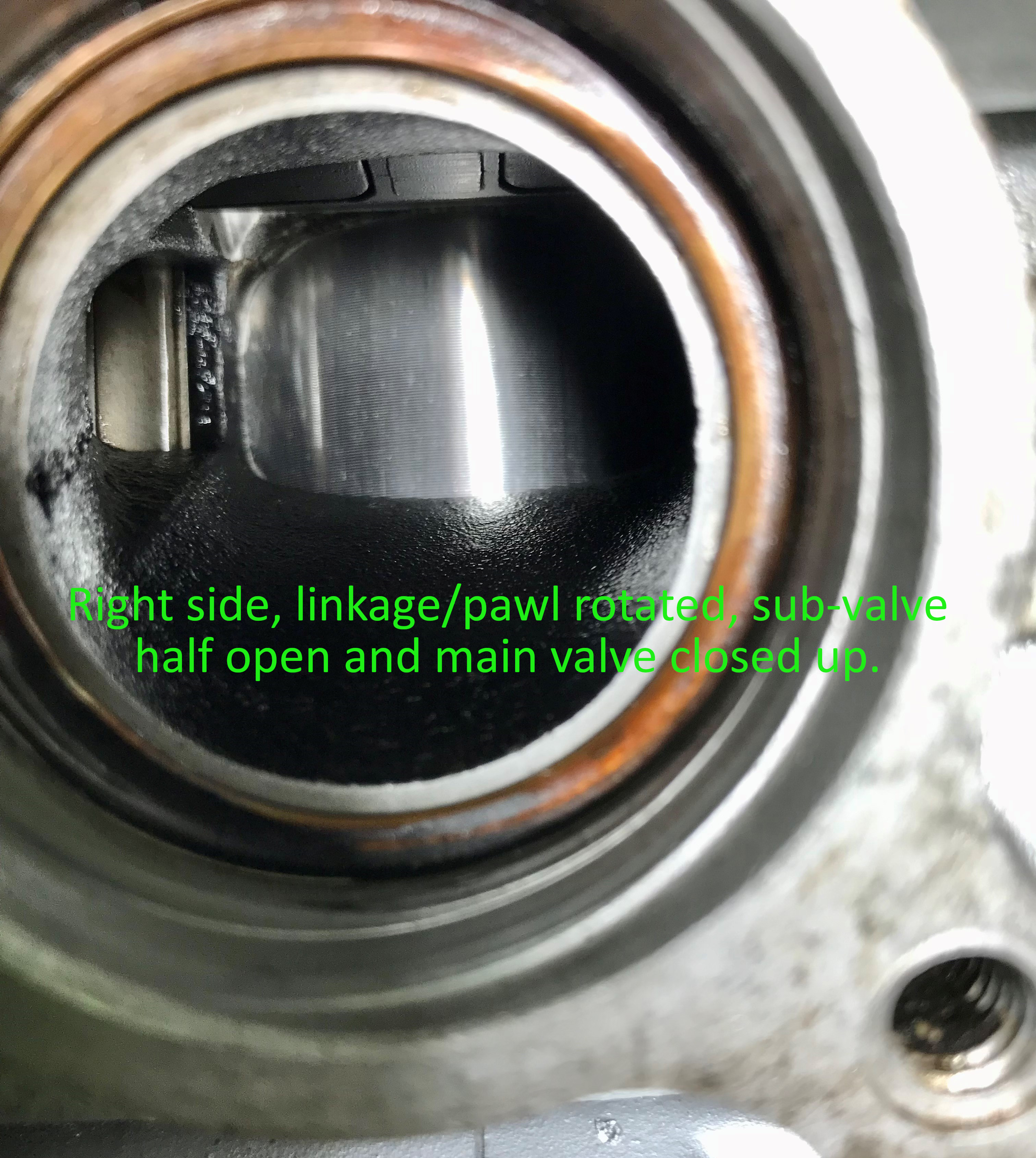

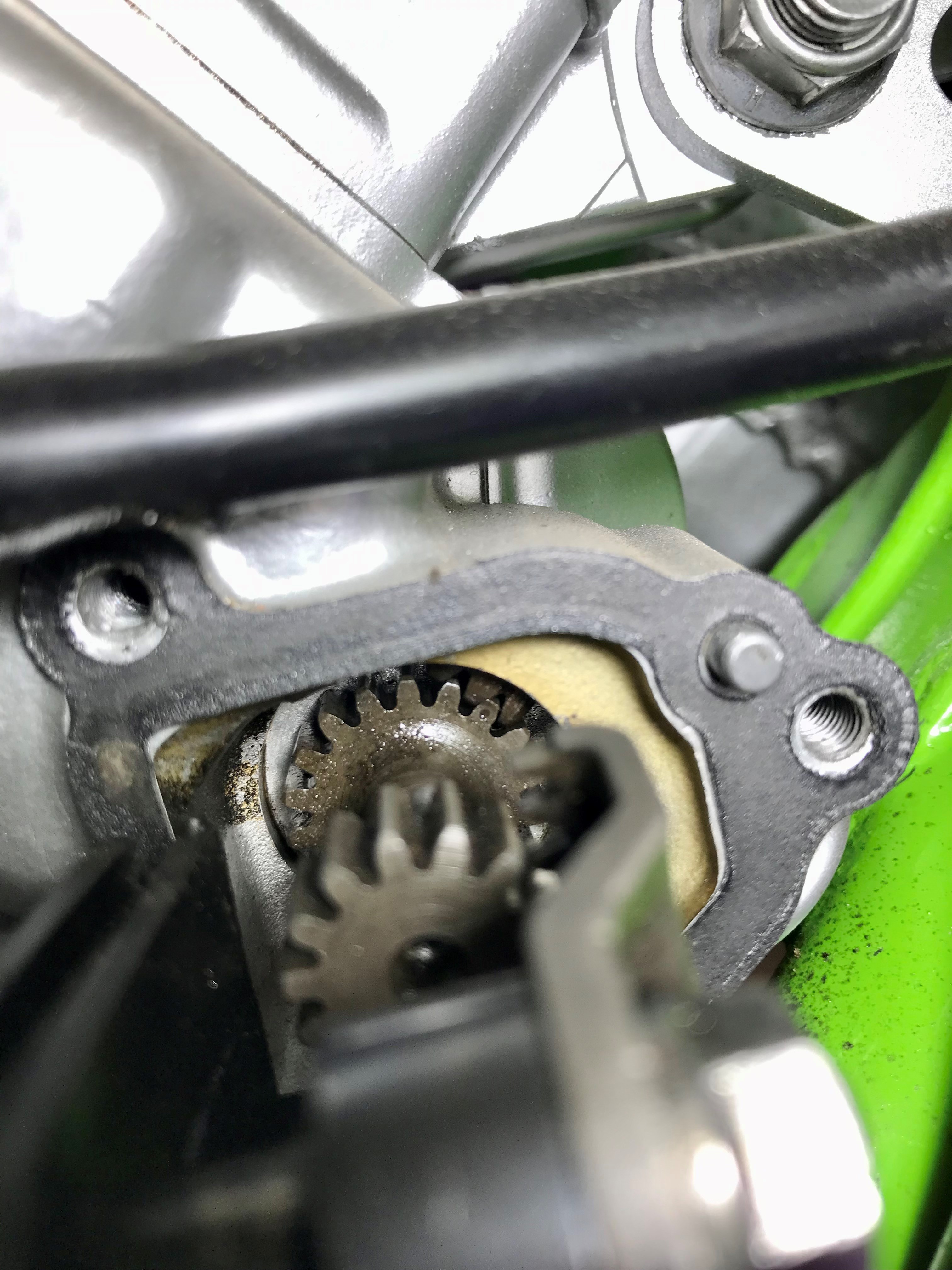

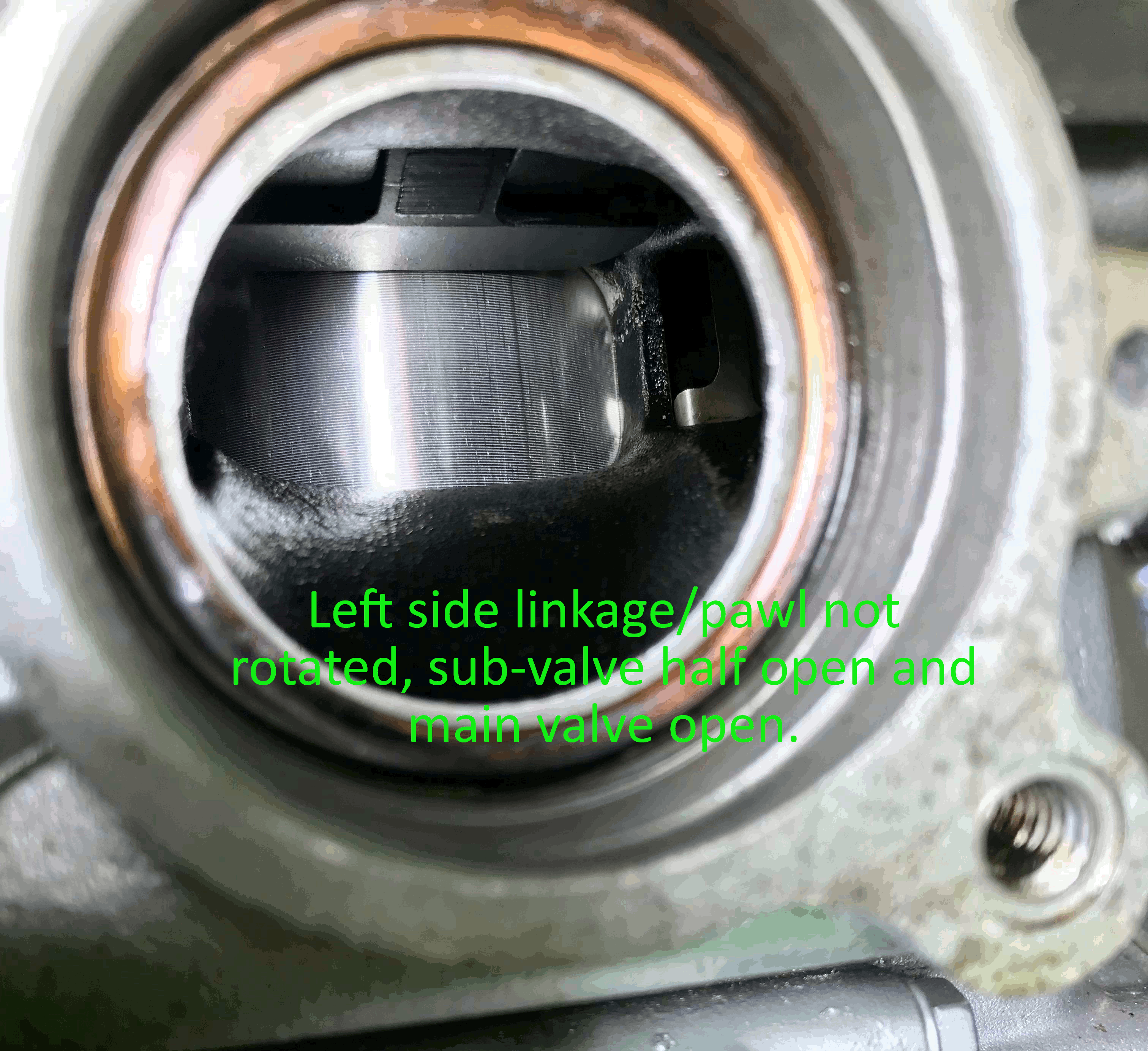

From these pictures can you tell if the linkage is setup correctly?
Without moving any linkage the sub-valves are half way open as well as the main top valve. When I rotate the pawl by hand the sub-valves close as well as the main valve.

I have not tried it but I think once linked you should not be able to rotate the main KIPS shaft unless if the governor pin is broken.
Did you unbolt the left-handed nut on top of the governor shaft? Be careful doing so as it is threaded left-handed and you must hold that shaft with a wrench. But before I’d do so just look if the KIPS operates by looking under the slotted cover you already unscrewed (you first pic). And see if it rotates. See this video:

Right side gear turned all the way counter-clockwise, is everything is closed.

The KIPS shaft is still bolted to the pawl, I’m able to rotate the pawl/shaft without removing the left-handed nut. When I do rotate the pawl/shaft it rotates clockwise and the gear on other side of bike rotates counter-clockwise fully.
When I rotate the gears from either side of the bike the valves go to this position (I don’t know if this is open or closed).

you have a broken kips shaft (inside the right side cover if you can rotate it with the nut still on. That is why it has no oomph. The valves look right. You need to replace the KIPS shaft pin (search this site for lots of examples)
