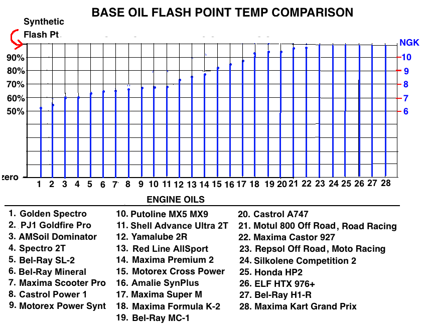

Most riders use NGK plugs and the higher the number, the colder the rating. A cold plug needs to be used in a hot engine (usually due to high RPM), and a hot plug needs to be used in a cold engine. That is to maintain the ceramic and center electrode temperature close to a certain temperature. The purpose of engine oil is to protect the engine from friction but it can't do that if the oil is evaporating off of the upper cylinder at WOT. The higher the content of synthetic oil in a product, the higher an engine temperature it can withstand without evaporating. The temperature of evaporation is called the flash point temperature. An ester synthetic oil has a flash point of 238 celsius, but a group 1 mineral oil is around 120C. Big difference. Mineral oils can still protect if enough oil is added to the gas but in some high performance engines they aren't up to the task no matter how much you add. So the idea here is the hotter the engine, the more synthetic content a product should have. This gives the most protection. Unfortunately you can't go by the flash point listed for any product because of kerosene added to most products to make them more pourable. Kerosene has a very low flash point. In any engine the jetting can be right on and yet it can still seize because the oil isn't protective enough. If jetting is rich enough to create wash areas of around 20% on the piston top and yet the oil is burning black onto the underside of the piston crown then it needs to be more synthetic. This page rates common oils in relation to NGK plug # (on right side of chart): https://dragonfly75.com/moto/plug2.html
This page lists the % of each oil an engine oil has. Don't go by what the manufacturer says about the product being synthetic. If the product has a group 2 mineral oil in it that has some high carbon #'s (similar to synthetic #'s) then they are allowed to call it synthetic. Goldfire Pro is an example of that exaggeration. Also they often call an oil fully synthetic when it isn't. For example Motul 710 is only 2/3 synthetic but is claimed to be 100% synthetic.
https://dragonfly75.com/moto/oil.html

If you don't ride hard then Yamalube at 40:1 is adequate. Otherwise you need more oil or one with more synthetic than it has. Next time you take it apart take a look at the piston underside to see if any oil has burned onto it. If so then you should consider using a better oil. Check out my analysis of engine oils at www.dragonfly75.com/moto/oils.html
