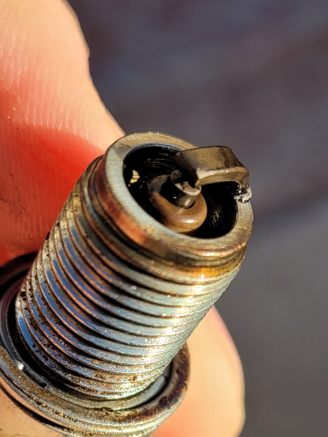

More importantly, spark plugs indicate the engine was running richer than any of the 4 previous rides. Two rides had large main jets than reported above. Two rides had the 140 main jet. The average air temperature here is consistently 68F (20C). Recently, air temperature was lower than average by 18F to 19F (10C to 11C). Therefore, temps were about 49F to 50F [9C to 10C]). It was damp, too. This is the day I got rained on twice while off road in mountains. The engine ran very rich and much richer than the previous 4 rides in which mpg and rich-lean ratio were incrementally improving. What are your experiences with KDX’s in temperatures that are about 20F (10C) lower than your average air temperature?
I do not know whether potential jet block gasket leak, lower air temps, or worn slide valve are causing this engine to run so rich. However, I'll have a new jet block gasket by Saturday for installation into my KDX220 Keihin PKW33.

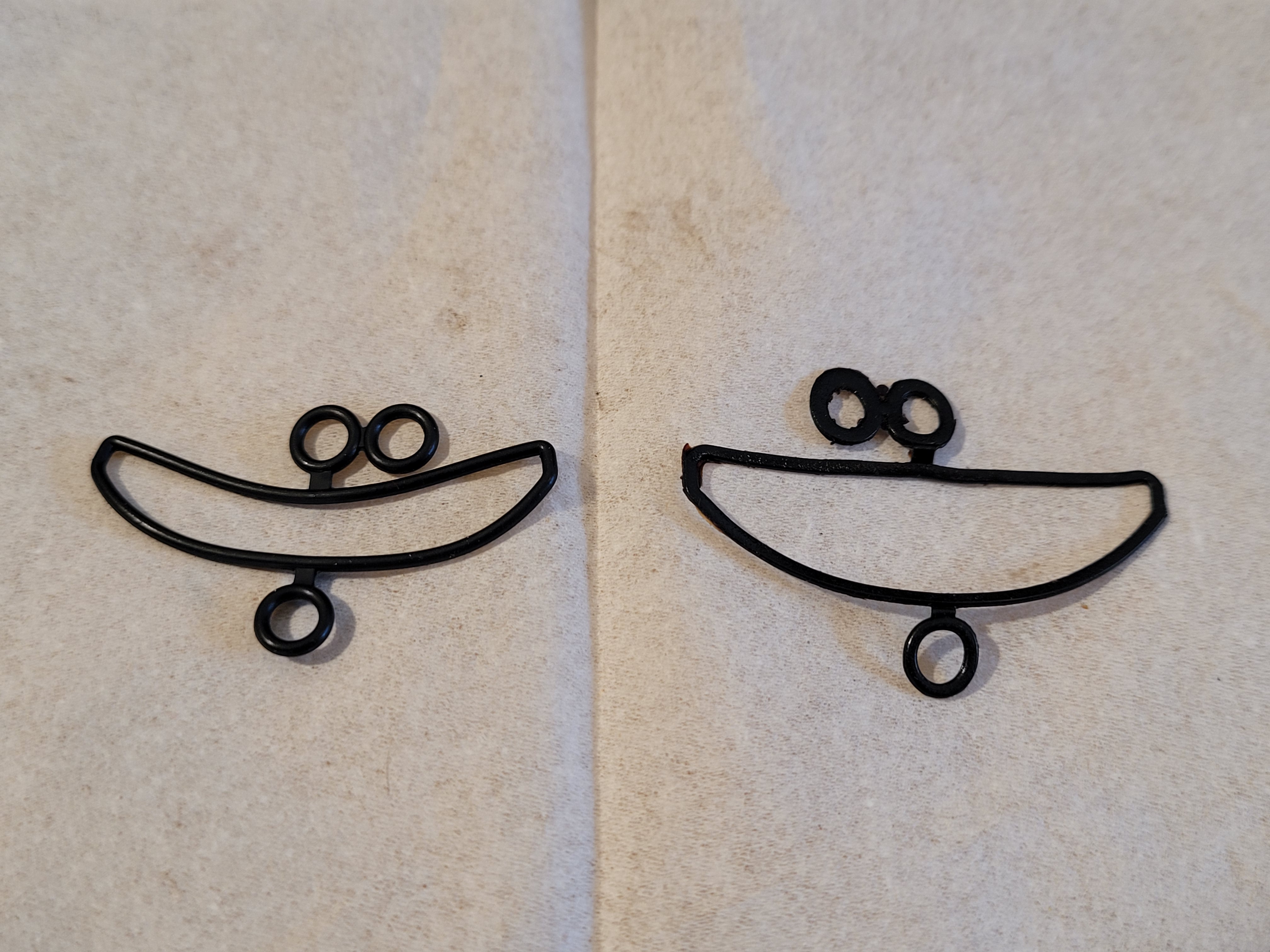

Quick update: replaced jet block gasket. Photo shows new one on left and flattened, worn out original on right. Re-installed number 42 pilot jet and number 145 main jet. Kept float at 18mm and needle clip in P2. Short street ride seemed positive. Will attempt to sneak away from work for proper off-road test

Now we're getting close! The biggest problem was resolved months ago with forum member assistance. The biggest problem was caused by leaking jet block gasket (o-ring). The majority of my riding is low to slow speed. County roads are predominantly used to access trailheads from home. Most of my riding is in technical terrain and, very trials-like quite often. On the forest fire roads, I rarely top 18 mph (because I'm not out to break records or bones + the views are astounding). Therefore, I'm most interested in carb jetting for just above idle (chug) to 6,000 RPM. I spend a lot of riding time at no more than 4,000 RPM. The spark plug in the photo was installed new and reflects about 60 miles distance riding as described. With the jetting and reed valves that resulted in this spark plug color, low end throttle response is very crisp. Acceleration from about 3,000 to 6,000 PRM is as smooth as an electric motor (it's eerie).
