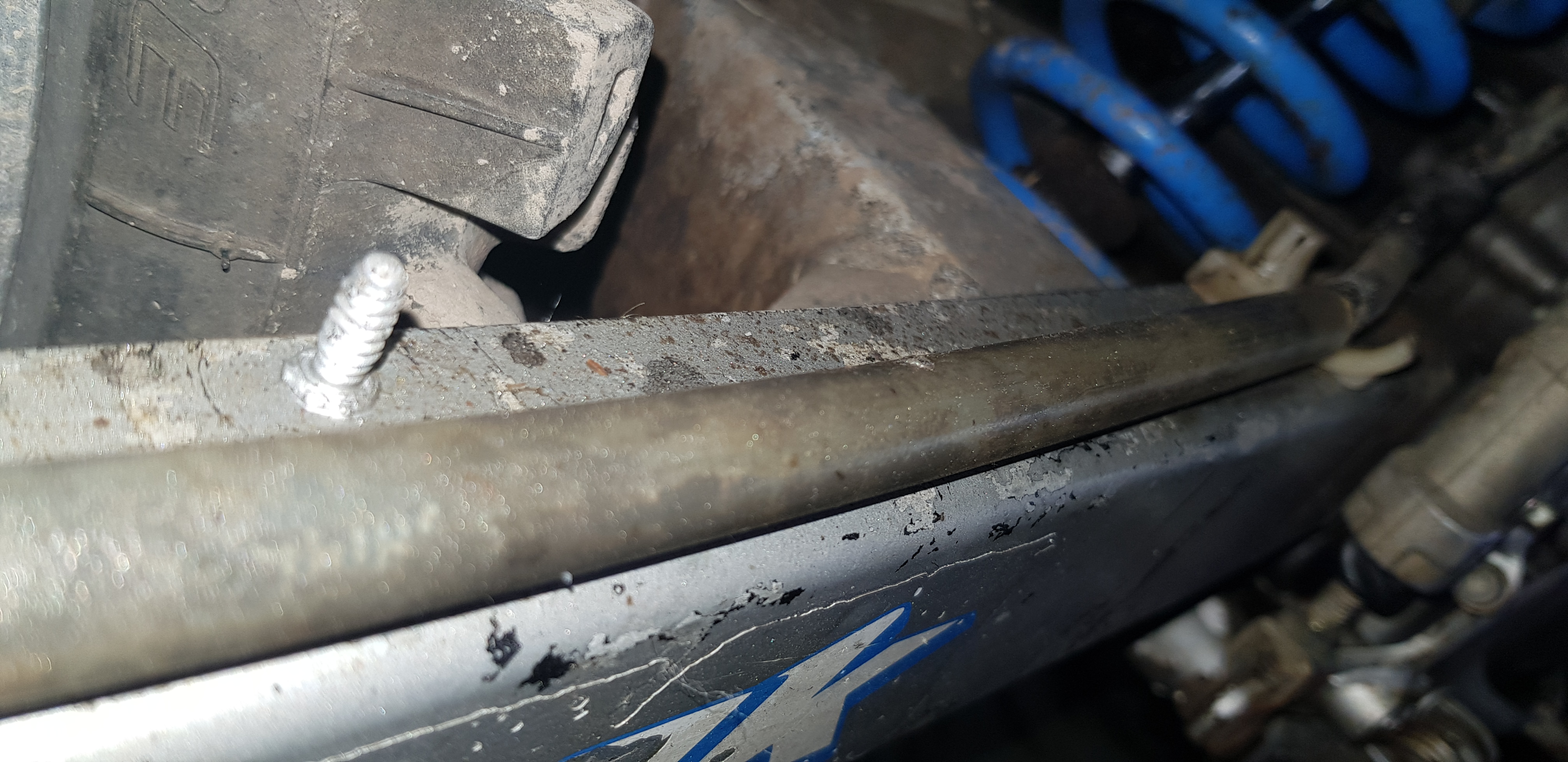

Thanks - yes, i can take a pic when i get home, but the swing arm just has a coarsely treaded lug sticking up vertically (thread like a wood screw) and the plastic brake line guide just pushes down onto it to secure. No screws. Looking at the late models they all have screws.

Ok, no worries. In AU ours are different for some reason (see attached). I will have to drill and tap I would say.
- 20220324_214110.jpg (2.56 MiB) Viewed 18680 times
rickvs355
- Posts: 25
- Joined: 08:09 pm Mar 23 2022
- Country: Australia
Re: 1990 KDX200F SR - Rear brake line guides / eyelet
The beast
- 20220324_214124.jpg (2.84 MiB) Viewed 18680 times

That is the same guide/clamp as the E series, could you use a insulated(or nylon plastic) hose clamp and a plastic/nylon nut that will fit the stud,maybe have to double nut??
Next size up from the hose so it sits loose inside the clamp,.. eg. 1/2" hose, 5/8" id clamp..these clamps will sort of hold on by itself as the mounting hole will try to spread apart on the stud..nylon nut should work.
Could use one of the H models too I think,drill a hole for the alignment pin and install nylon/plastic nut on the stud .
Another option might be to 3D print a OEM one, I know they do some for front ones on other bike Eg, DRZ400

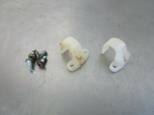

The guides I bought are second hand and come with screws - M6 by the looks of it. i will just lop off those posts and drill and tap for the oem look
- KX Guides.jpg (14.54 KiB) Viewed 18470 times
