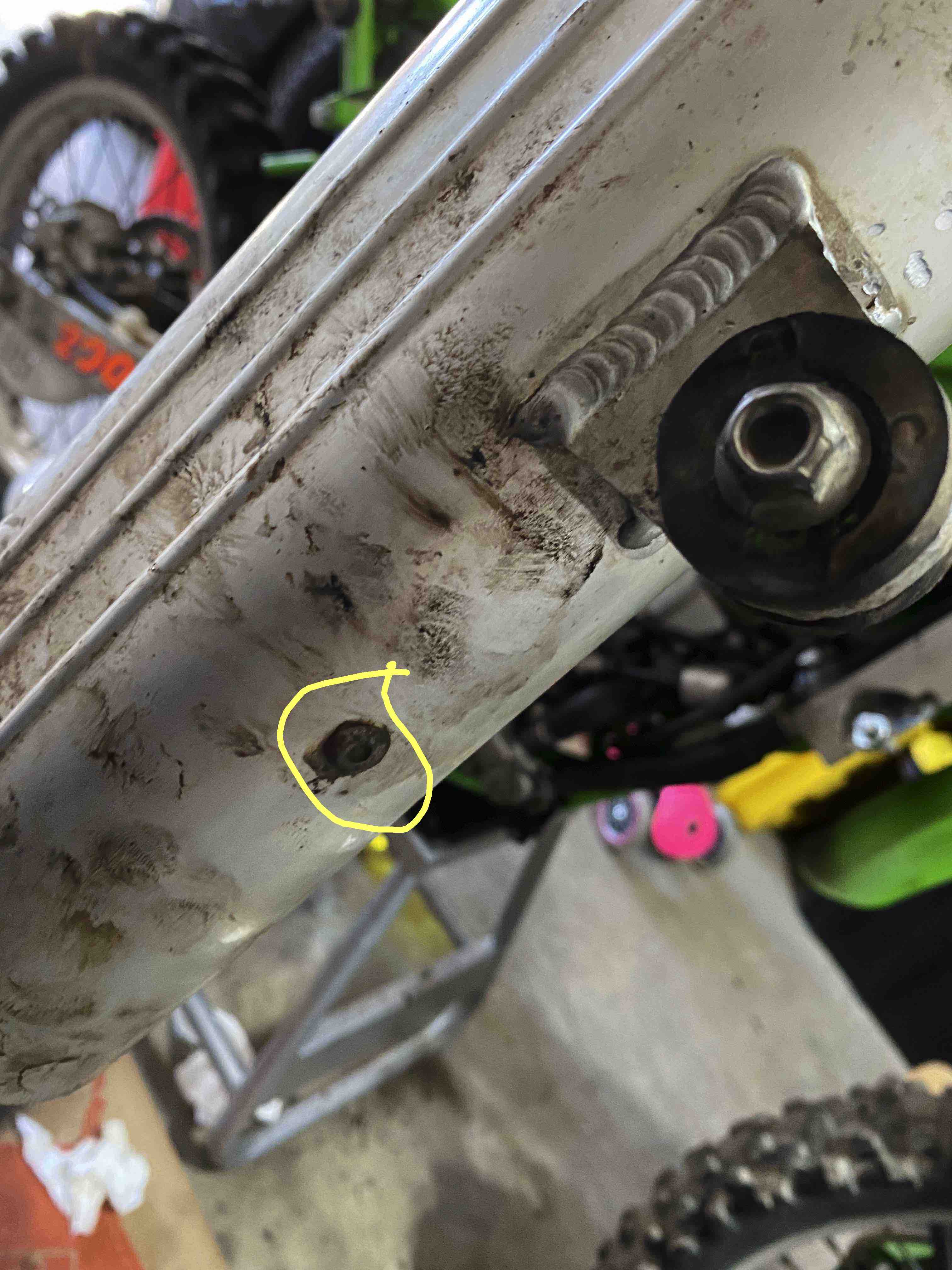

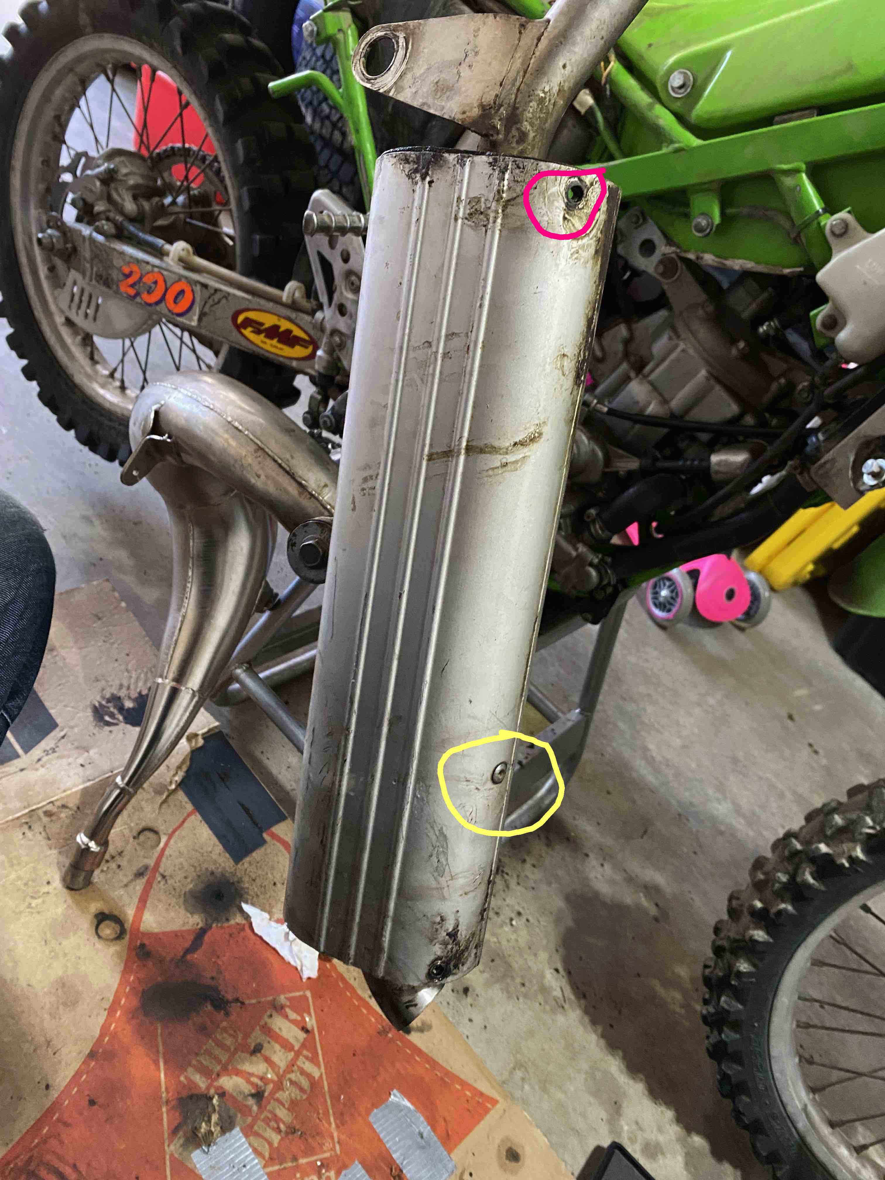

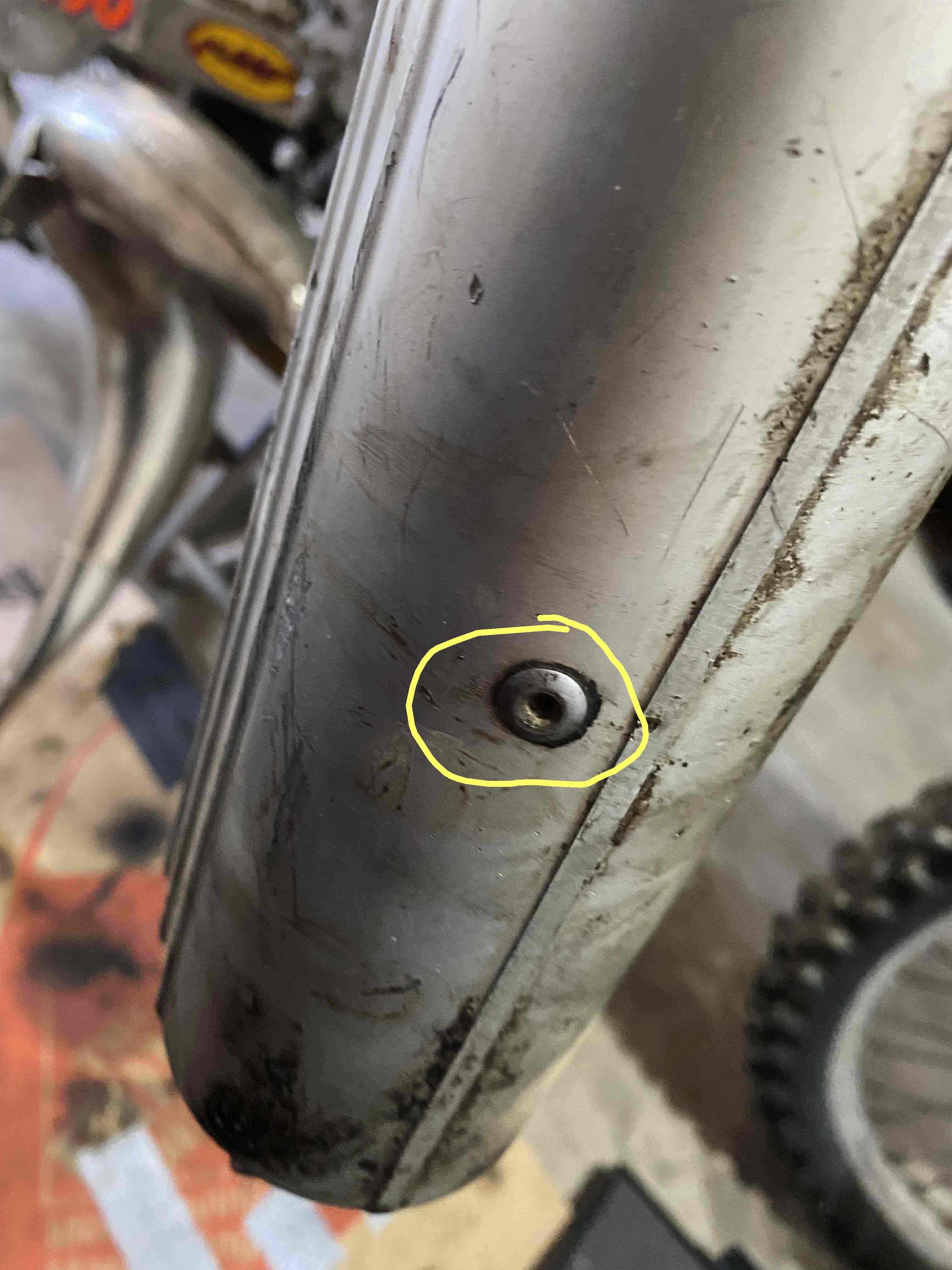

I want to disassemble the exhaust. Removed it, unscrew 5 screws (pink) but can't separate parts. I think its original. Seem to be a few pop rivest (yellow) but not sure. I will try attach pics. Thanks guys n gals

It's an aftermarket silencer (to go along with the aftermarket pipe in the background) so is not original OEM. The 2 (some have 3) screws where the pipe goes into the silencer are all you need to remove, leave the rivets in. If the baffle doesn't pull out easily try lightly tapping the pipe back and forth to work it out. This video is a good tutorial.

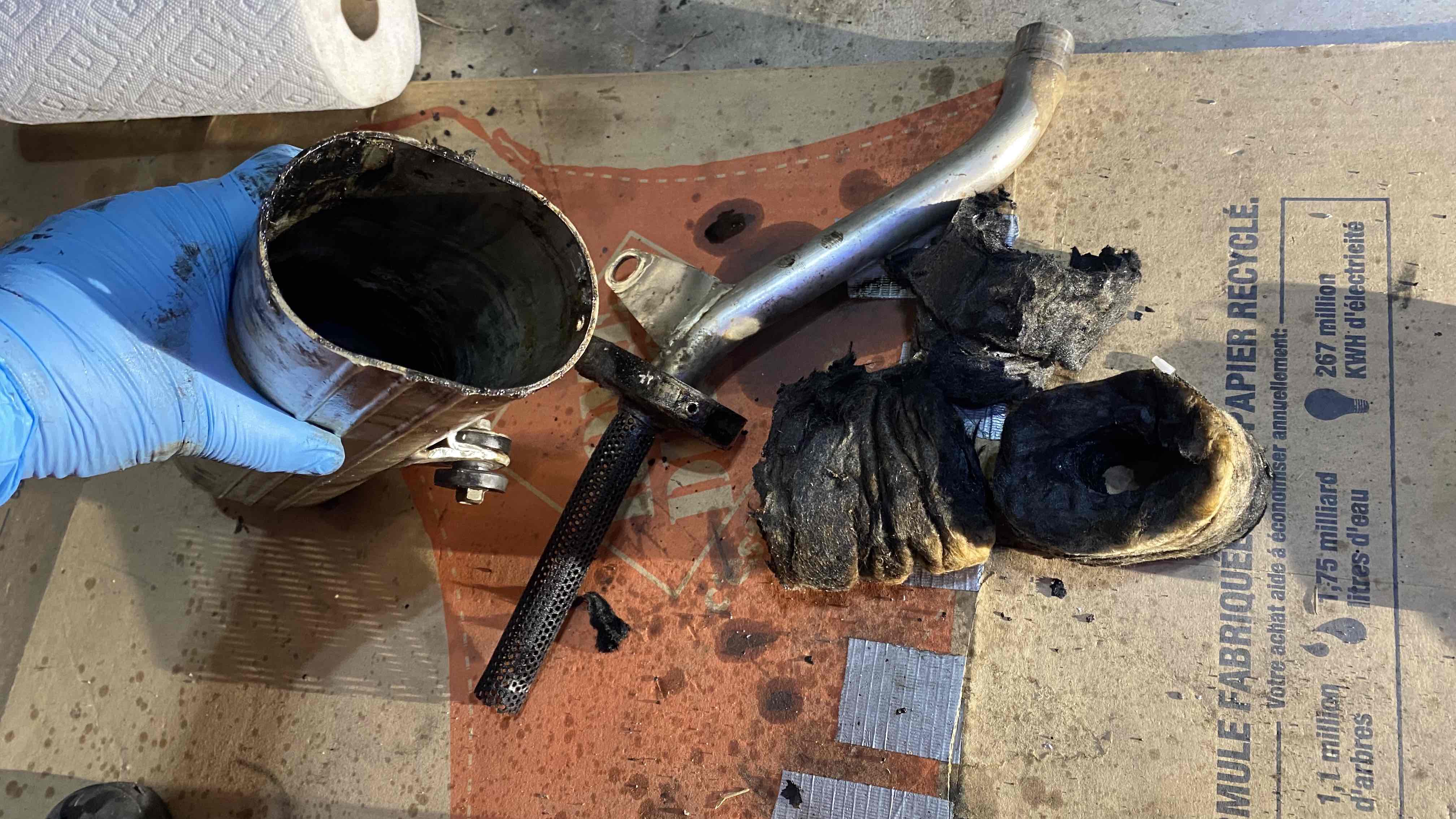

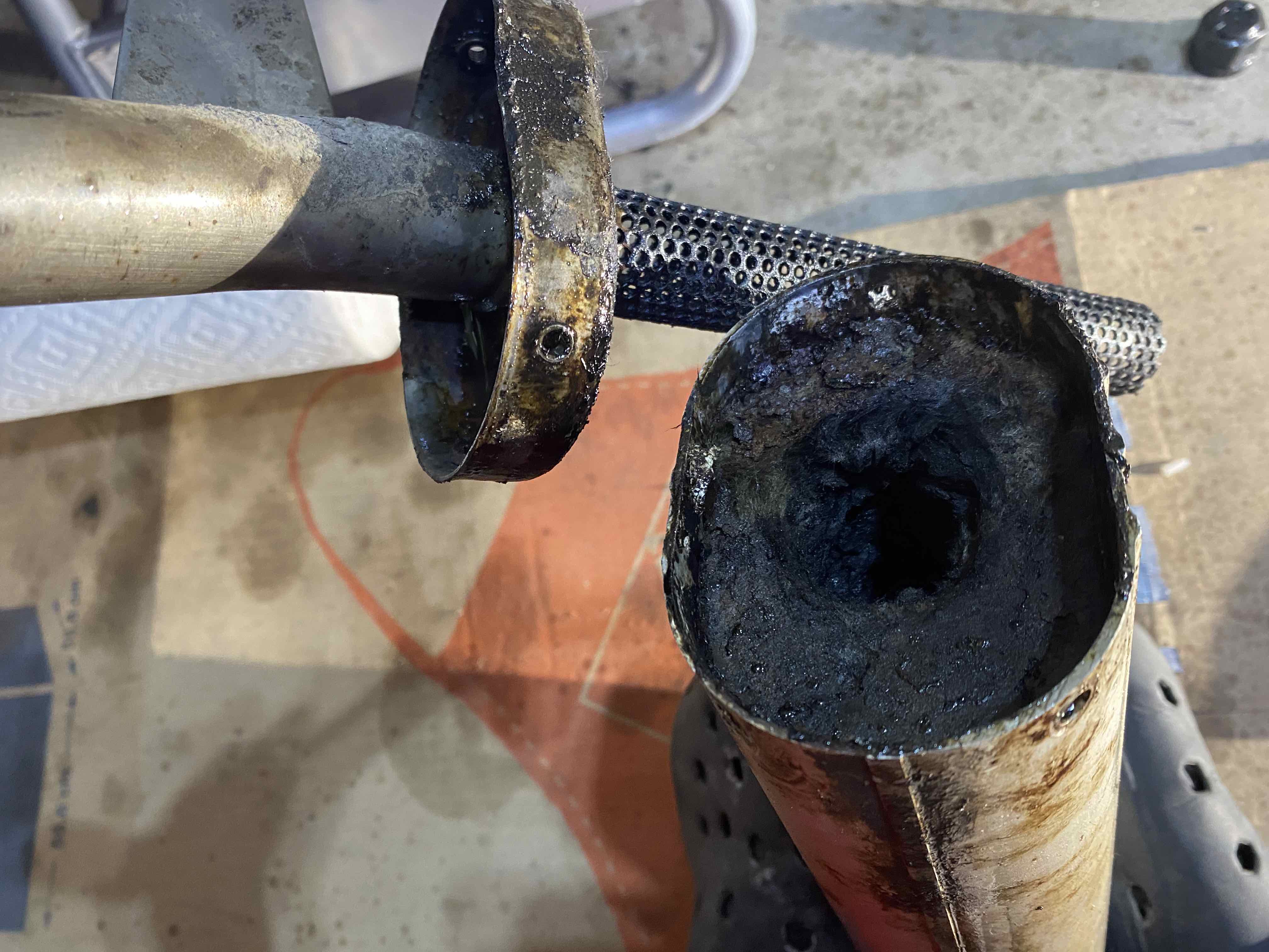

Post by kdx_cobra »
Thanks for the tips. Man, look like it's been a while since repack :supz:
Re: Hi to the forum
Yeah, you were ready for a repack for sure.

Re: Hi to the forum
That baby has been neglected for quite some time. Glad you got it open to freshen it up.

Post by VTMTcowboy »
Welcome! Wow, that needs some new repack. Looks like a "universal fit" FMF exhaust. Might want to upgrade regardless of the repacking. Either way, can't beat a KDX.

Re: Hi to the forum
I think it is not universal, just a real old style cannister.
