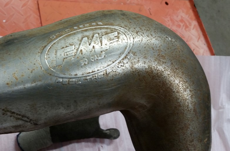

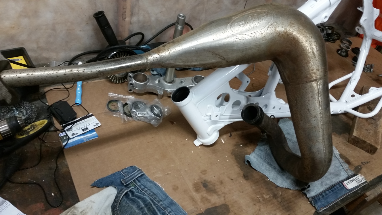

Here are the images of my pipe, KDXGarage. It says "K 13 KDX" with "1911" under it. And it says "Gold Series FMF Feel the Power" When did FMF do this slogan? Do these images tell you anything more about my pipe? I'd guess it's the same pipe as the ebay pipe I posted about above.
I dumbly tried sanding it years ago, that isn't any way to get rid of the rust. It just made some scratches I have to now get rid of. I'd like to get all the rust off and have a smooth enough surface to paint it grey or black. What do you all do in this case?

Re: Found an 86-88 FMF pipe on ebay
Where is my '87 shown??
I think that pipe is not real old. Most of the ones I see are like that. In current pipes, "Gnarly" is a little thicker metal for off-road (non-MX). The Fatty and Works pipes are normal thickness 19 instead of 18 gauge? Something like that. That had a "Fatty", but some say Harley gave them a call to complain. I know the Gold Series was several years ago. I am not sure if they ever changed to a newer name for 86 - 88 pipes.
The nickel plating has rusted through. You can get the rust off with Evaporust or similar, but just know that undern eat the rust is bare steel, not the pretty nickel plating. I worked at a place that used sulfamic acid to eat off nickel specifically. Maybe some place around you can get the nickel off. You could sand and paint it after that.
I'd try the Evaporust first, then maybe just deal with it being less than beautiful. Like the stamping says at the bottom, you will still be able to "FEEL THE POWER".
OH! Move that rusty pipe from that shiny, pretty frame! :-)
Don't worry, that frame was only next to the pipe long enough to take a pic. The frame got a little uppity and demanded I remove that filth from the bench. I complied, but not before the pipe got it's feelings hurt..... So now I'm planning the pipe's revival in a little bit more detail to keep it happy. Not taking the steps just yet, but letting it know I've got the plan all figured out.
Sulfamic Acid to take the nickel-plating off and then paint? Hmmm.... I'm thinking you're implying I won't be able to paint over the nickel-plating. Shoot. I just assumed I could paint over whatever finish was on that FMF pipe.
I looked up Evaporust - it looks like a good first step. But it looks like I would need to soak the whole pipe for hours. I might need 5 gallons of evaporust to submerge signficant portions of the pipe, and at $8 per quart.... I think I'm missing something here... Wrap rags on the pipe and keep the rags wet maybe? Dilute the Evaporust? Use gallons of vinegar?
My hope next would be lightly rough up the now rust-free nickel and throw some high-temp stove paint on it. But will the paint stick to nickel? If not, I'll just have a somewhat shiny, somewhat scratched and pock-marked pipe. But yes, I will still feel the power. The expansion chamber is significantly larger in size than the stock pipe, I noticed that when taking pictures of it.
Painted parts can be quite uppity.
I think you can paint over the nickel, but I am not sure how well that would turn out with the 10,000 rust spots not allowing a smooth surface to start from.
I think they make a gel version of Evaporust. I would use a soaked rag laid on top otherwise. It will lok black afterwards, but can be washed and scrubbed off. Chelation is the method (might be misspelled). I did some chrome sockets last year. It got rid if the rust, but the surface was cratered to a thin depth.
I have never tried to paint over nickel, but not sure what would be so different than stell, aluminum, etc.
When the "fat" part of the pipe is bigger, that means it is tuned for lower end power (I THINK). Some have measured the difference between the 1995+ Desert pipe and Woods pipe.

With the nickel plating you either need to completely remove it or you need to abrade (sand) it enough that a mechanical bond can happen. Removing the plating is the best method and will guarantee great adhesion for whatever coating you choose. There are several companies that offer adhesion promoters that will help as well. Lastly, you can use standard high temp BBQ paint but there are some better, yet more expensive, options on the market. One I like, but is very pricey, is Cerakote high temp ovev cure coating but fitting a pipe in an oven can be a challenge. However, they do make some air cured versions as well that are also very durable.

Yeah, I too thought I remembered reading that fat = more low-end power when I was reading up on the desert vs woods pipe discussion.
Thank you for the additional information on the pipe, you two. I did some additional research into products and procedures. I see painting a zinc-plated pipe will be more complicated (expensive and time-consuming) than I had anticipated. At least if I want to ensure nice results. I'm glad I got the heads up.
I think I'll just go with KDXGarage's original recommendation to try Evaporust (they do make a gel) and then just be happy with however the pipe looks after that.
Of course, if I were to happen to find a DMC pipe again with the raw steel, that would solve this little issue..... and the wallet would open

A wise, and less frustrating, choice!Kipsy wrote: 09:02 am Feb 07 2022 I think I'll just go with KDXGarage's original recommendation to try Evaporust (they do make a gel) and then just be happy with however the pipe looks after that.
