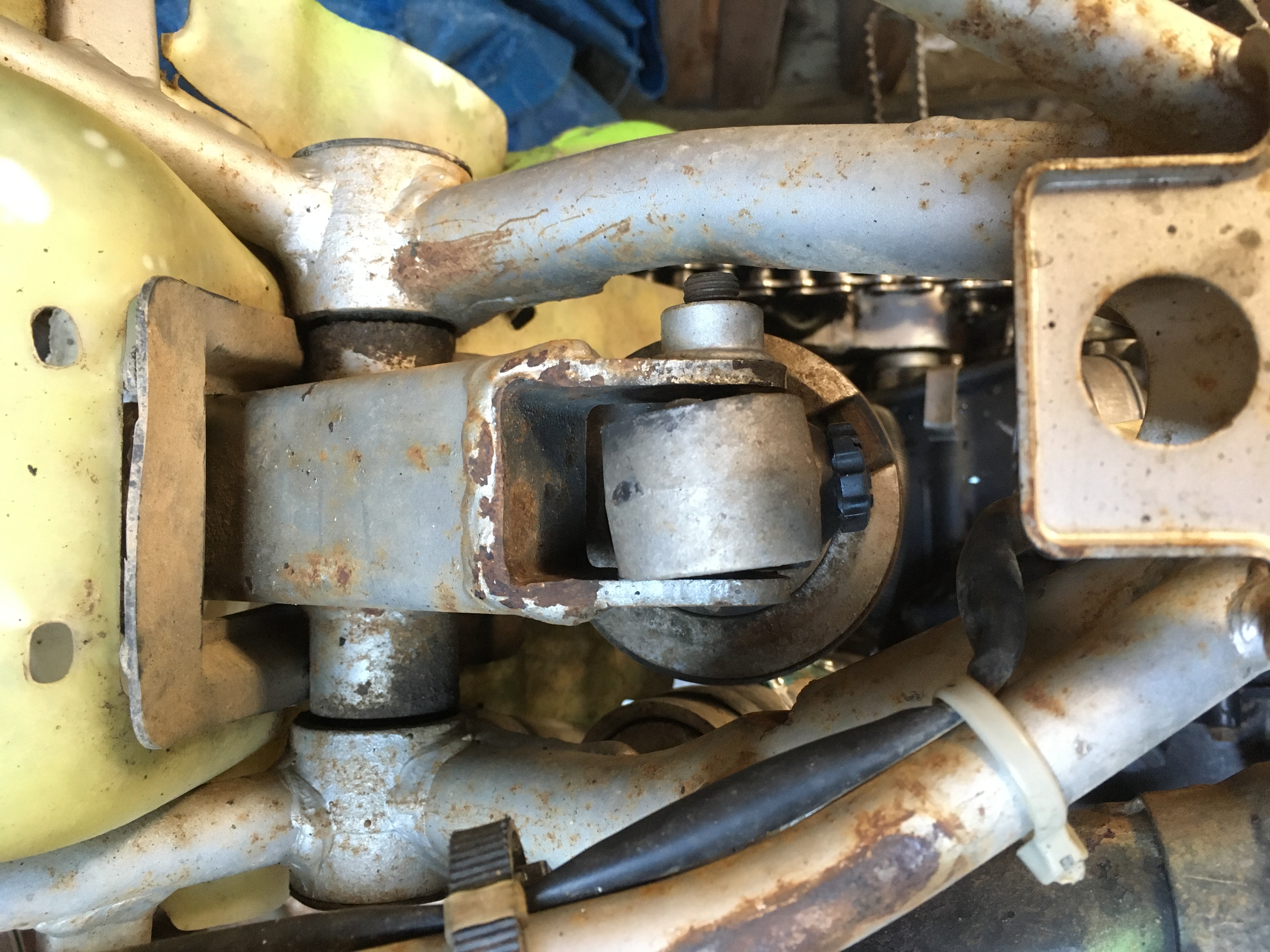

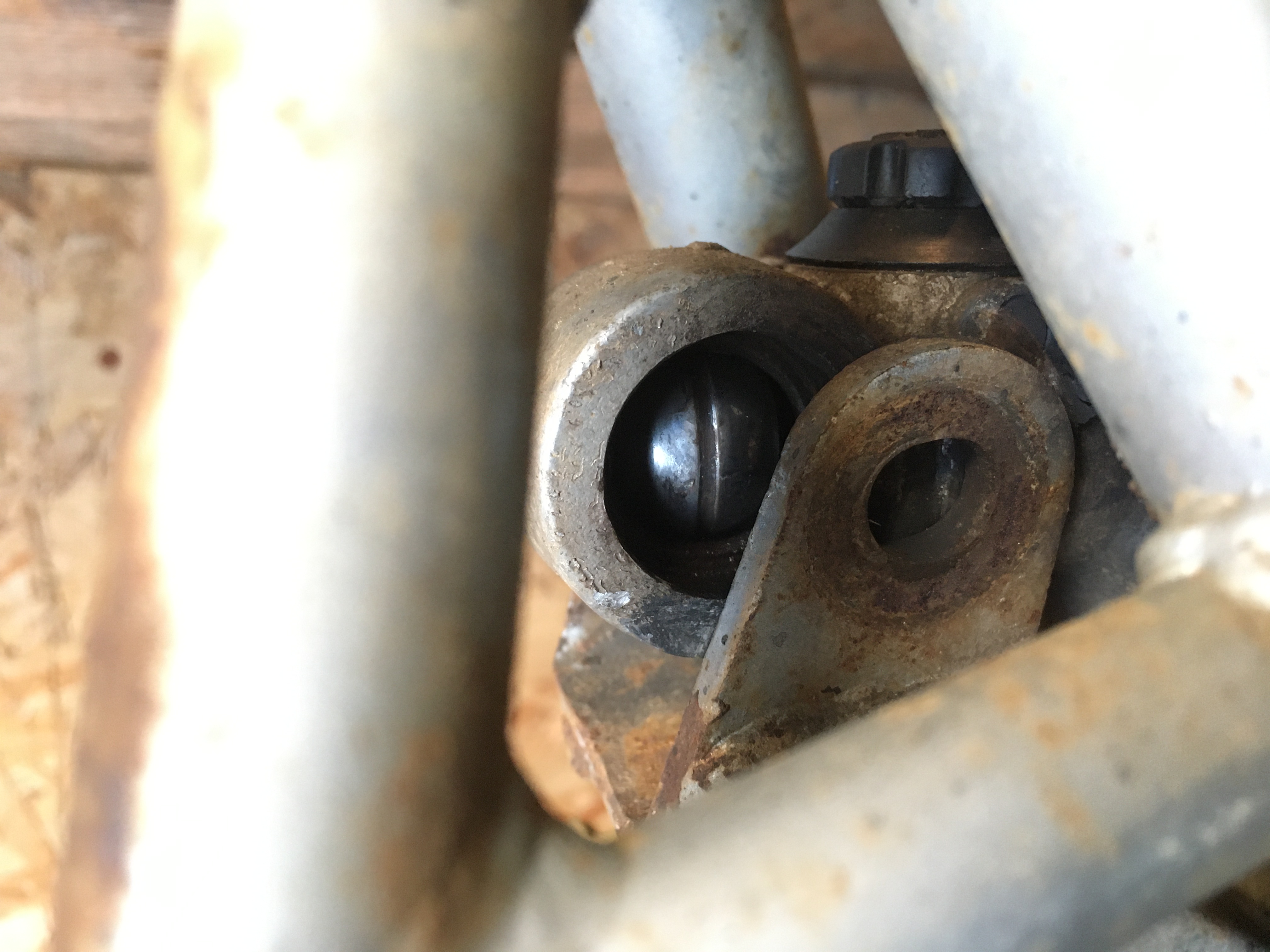

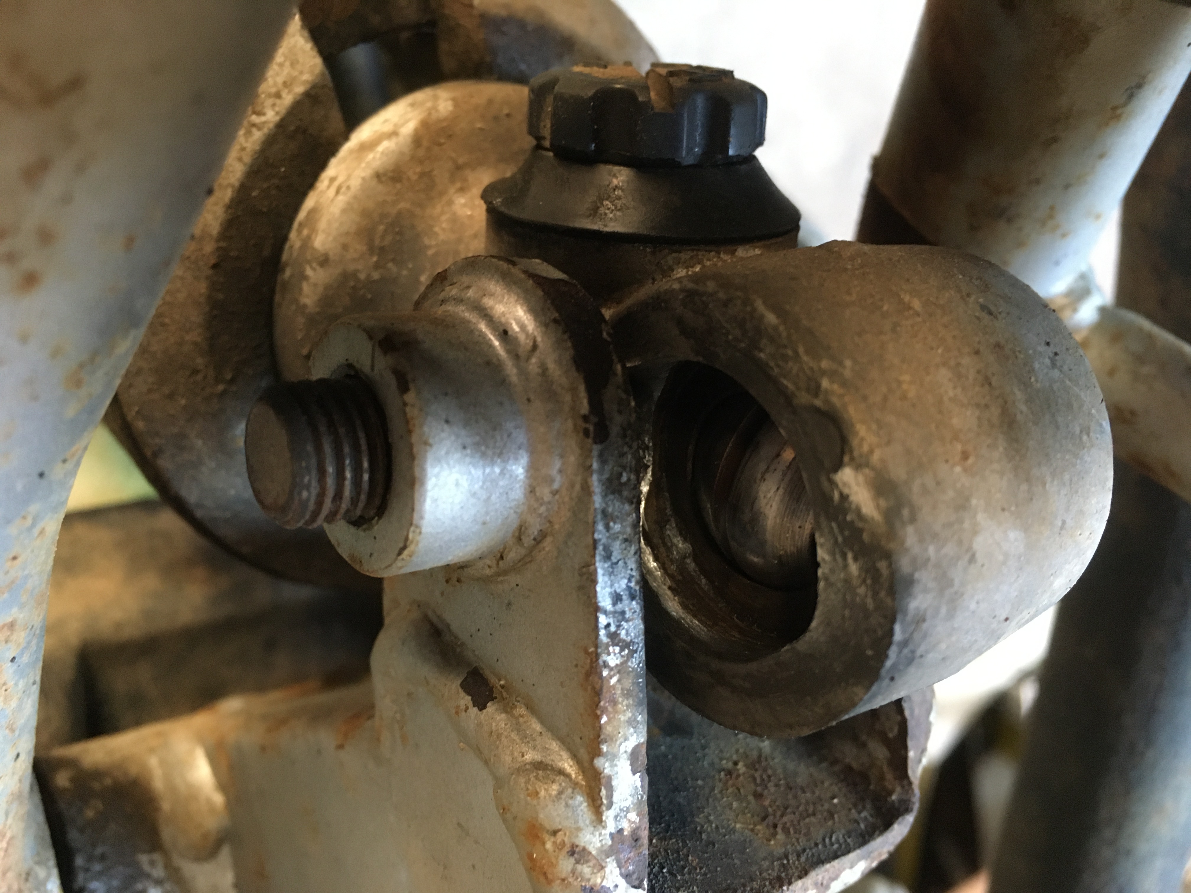

So I begin the process of fixing up a 1986 Kdx barn find. Unfortunately this is what I came across when I removed the tank and seat. It appears as though the top shock mount is broken. Has anyone else dealt with this issue or know what kind of parts I will need to source to begin fixing? I have the service repair manual and diagrams at my disposal.

Nothing appears to be broken except for the shoulder bolt that passes through the spherical bearing in the shock. They are known to wear and last I looked they were difficult to find. A parts diagram will show you the bolt and nut you are missing.

The rocker arm looks like the hole is worn out (oblong). Where are the seals for the top of the shock??
