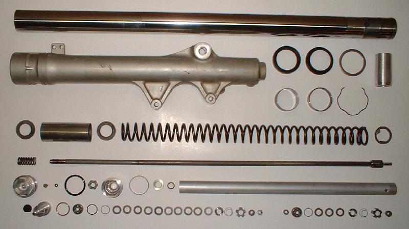

Here's a picture I took of some 1996 forks I was working on 15 years ago. :shock:

Wow - thank you so much for the help! I see now where the 27mm hex goes in. It looks like there is a chance of it unscrewing from the rod just as much as the chance of the base valve unscrewing from the rod during disassembly. I will use an impact gun, so hopefully it will break free easily.
