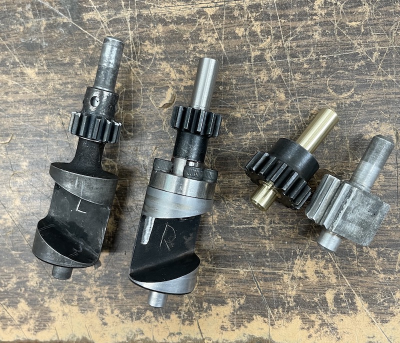

In case anybody is interested, I got sick of waiting for motoduro to get the valves back in stock.(they still dont)

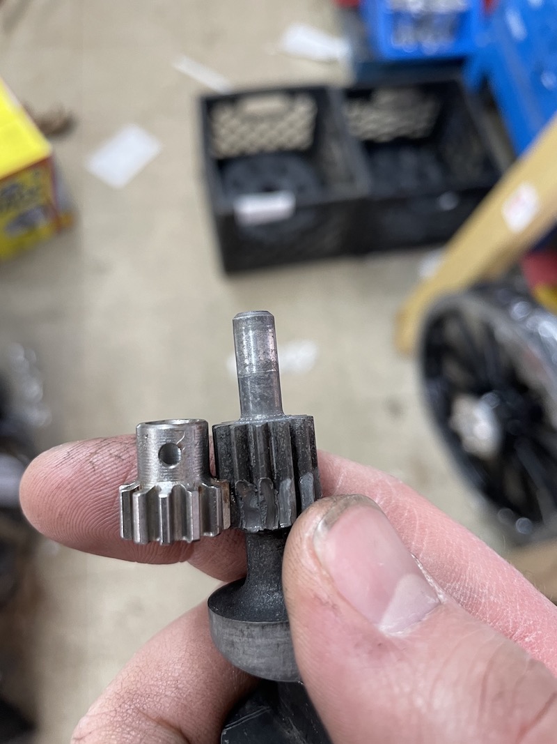

The left side valve was still in one piece, with just teeth missing.
I found the correct off the shelf gears to match the stock gear on the valve.
Turned the old gear off, pressed on the new steel one and locked it on with a dowel.
For some reason i didnt take a picture of this one finished

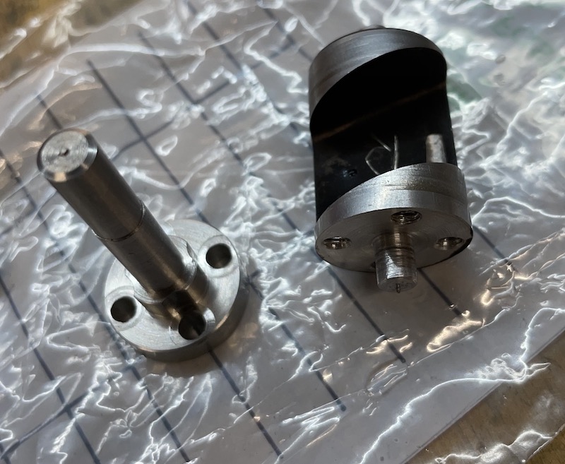

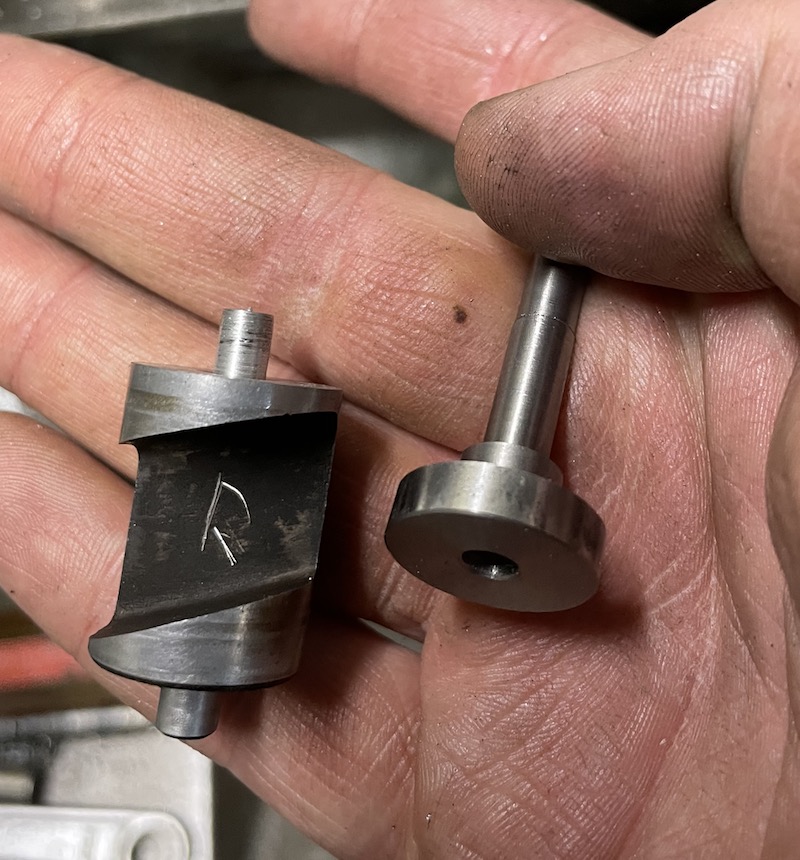

The other valve was broken in 3 pieces

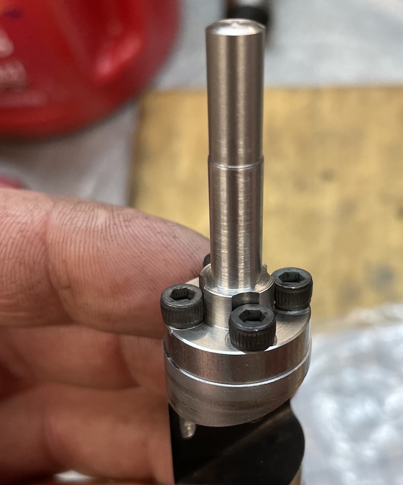

I made a new piece from where the valve necks down up
Turned a locating diameter in the valve to keep the new stainless part concentric
Drilled and tapped a 4 bolt pattern into the valve, made the wrong choice using #6 screws, should have used #4 as the heads are too big on the #6 and I had grind them after installed
I will get some more pictures of them finished with the gears on them.

Re: Lock kips valves in place
It looks to me as if the gear installed on your right valve is upside down, the gear teeth need to be in the same plane for the actuator rod. Could be that your gears are only half as high as the OEM ones so you still get rod engagement? Ingenious work around either way

Post by fxnick »
You are right the right gear is upside down in that pic, I was going to use the original idler gear and that way put it in a spot with no wear on the teeth. I decided to make the new idler after putting that one on. It is reversed now so It is in the same position as the left gear.
